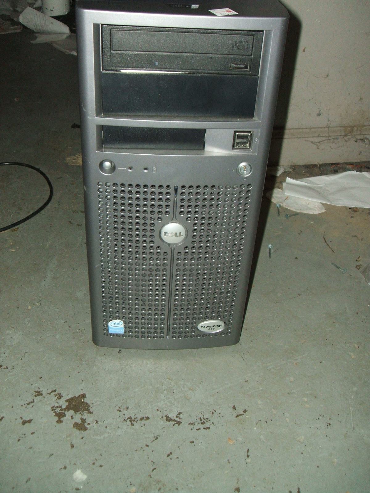

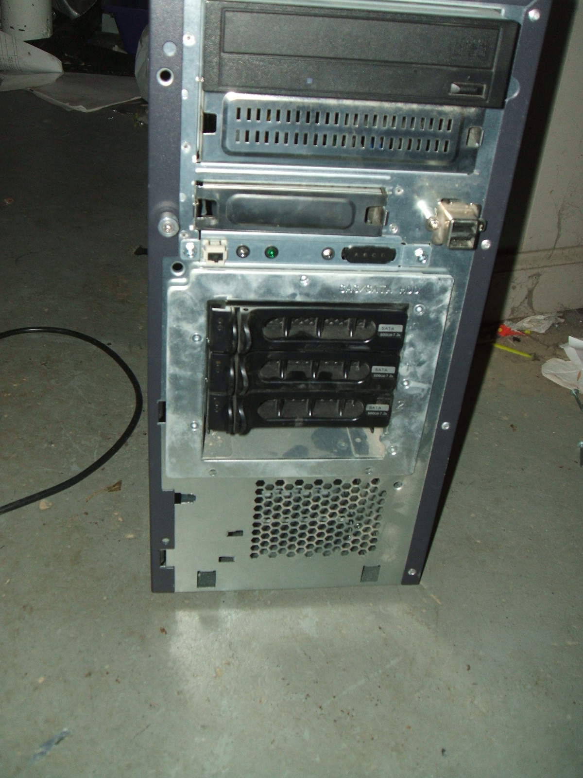

    Today's guest is a Dell Poweege 830 Pedistal server:
    ...That I bought for $20:
    The good news: It inluded the keys for the lock. The bad news: it's is less than complete condition (mostly there)

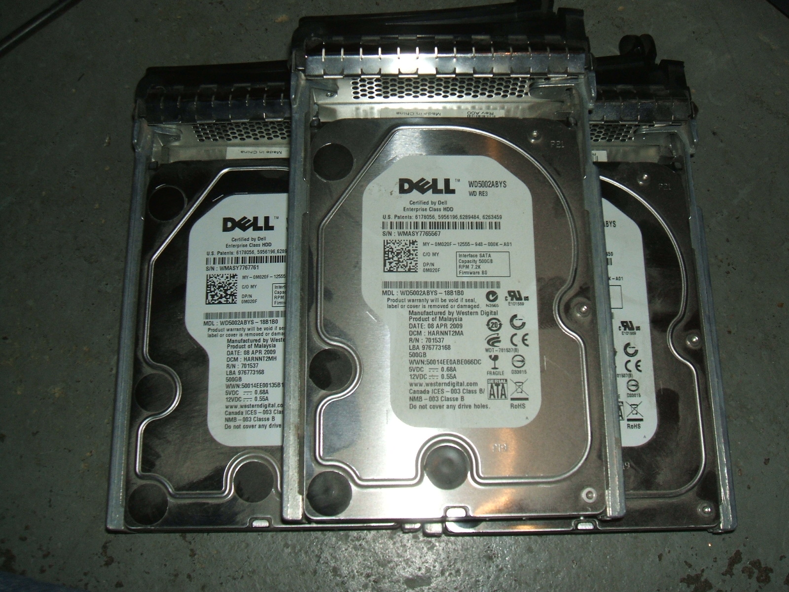

    It had 3 of the four HDDs with it:
    I haven't tested them yet but presumably they're good (unlike the drives in my parents file server, which this machine will replace). OT: If you have a drive similar to these you'd like to get rid of (trade/sell), PM me, as I may try to get a 4th drive and caddy (although I may just RAID 5 it and call it a day).

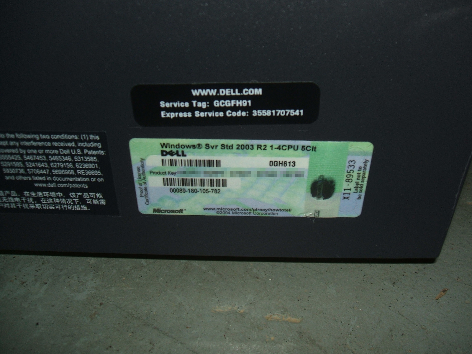

    It originally ran Server 2003:

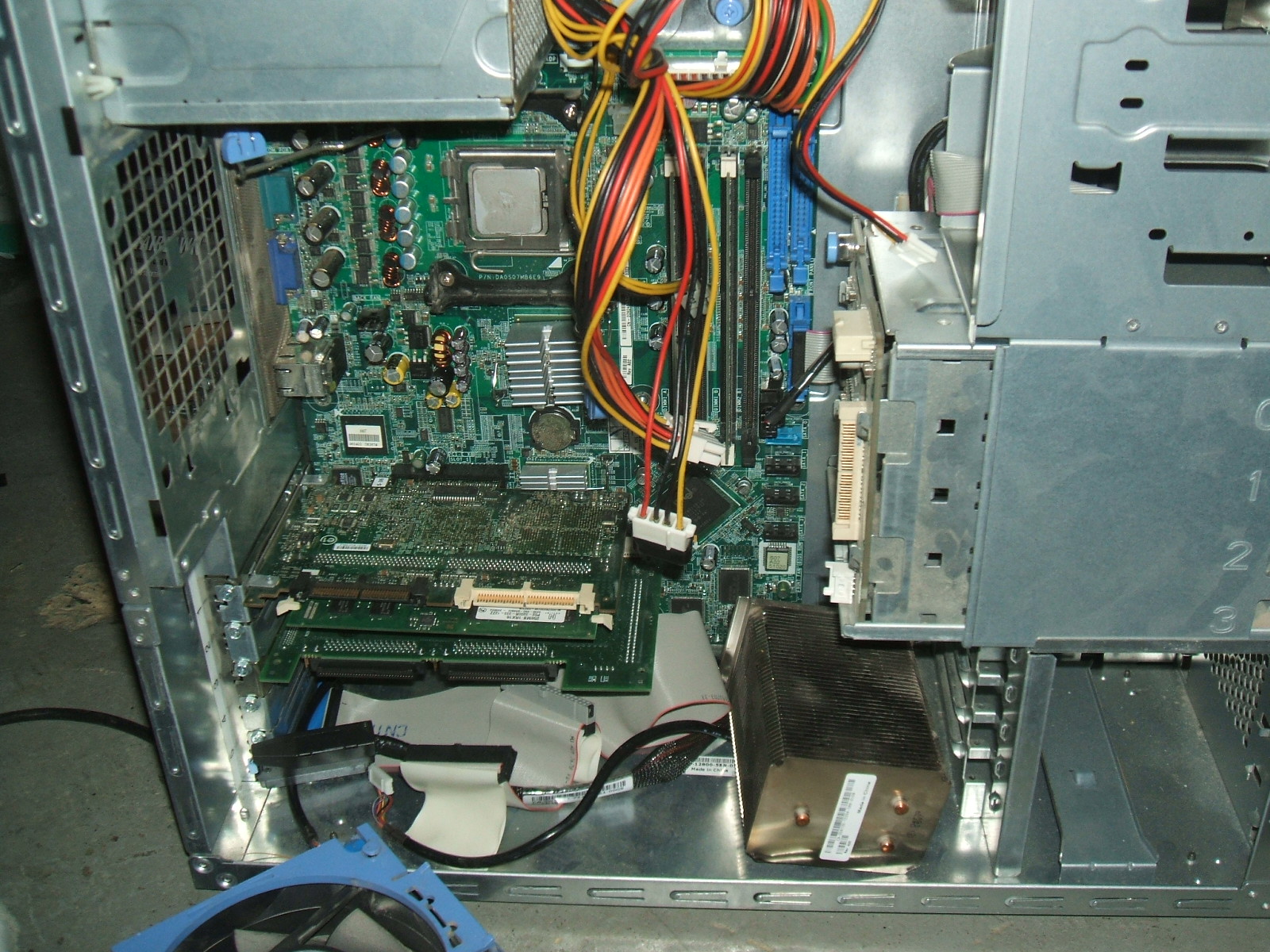

    The inside was, well, a mess:
    Everything is there, minus the Raid's BBU (which probably was never there but at $15 a pop Genuine used, I'll snare one) and some (I2C?) 5 or so wire cable between the SAS caddy and the card it's all there; It will need a new CPU latch (as one is busted, hence why the heatsink is on the ground)... Oh, and I totally dig the latched ribbon connections. Not even Supermicro and Tyan go that far! (although ususally there isn't room).
    The CPU is a Pentium 4 630 (prescott 2M HT 3.0GHz) and it has a measly 1GB of DDR2 RAM. I have a 3.2GHZ version in the current file server (a repurposed emachine) and I have 8GB of ECC DDR2 (which supposedly is compatible) sitting that I may toss in... the RAM may be overkill for a file server though.

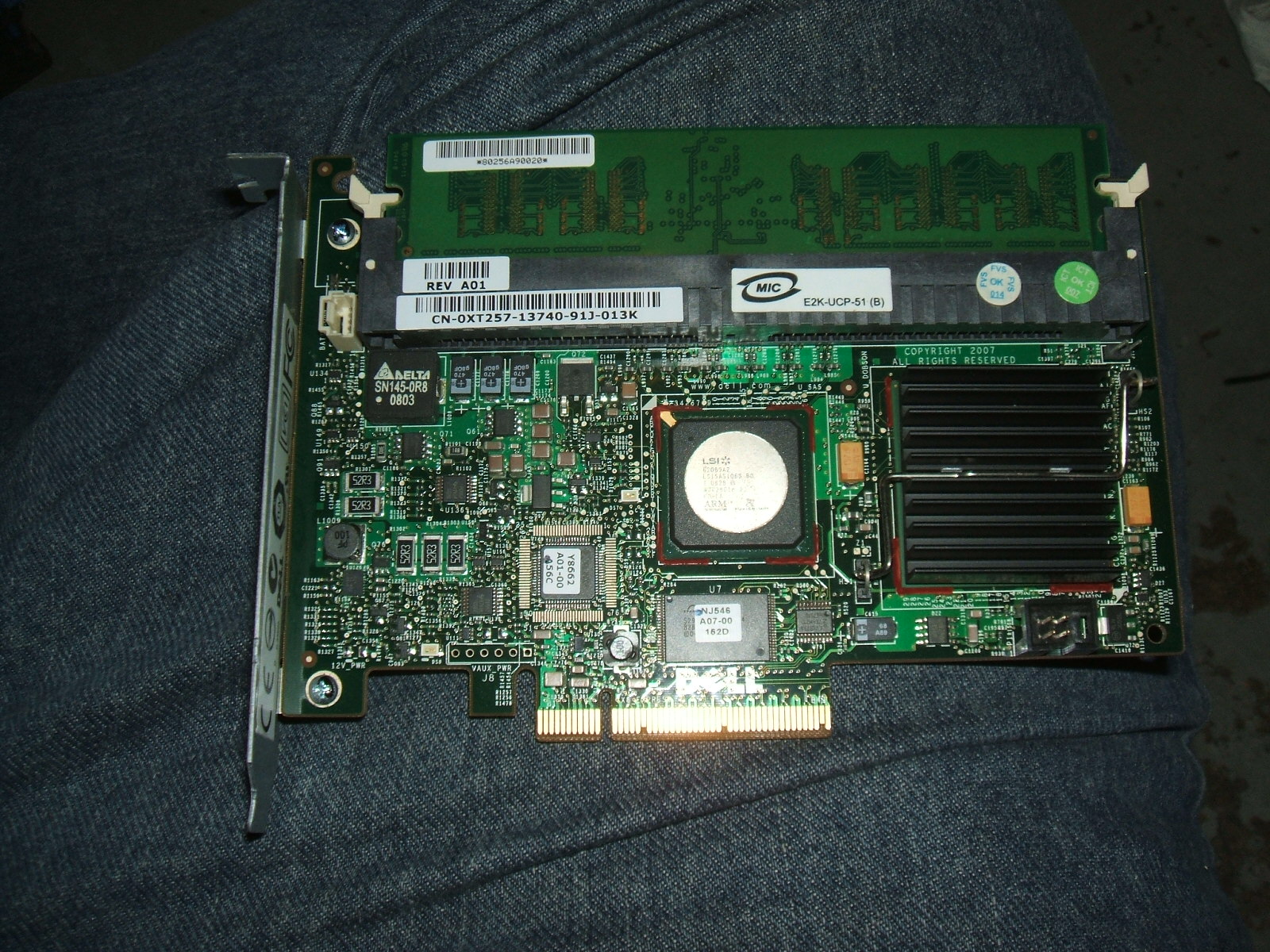

    It had a couple kickass cards:
    That's an LSISAS1068 SAS card... no BBU. I hear it's pretty spiffy though (shame it's using 72K drives)... 256M of RAM (ECC DDR2). I have a 512MB DDR2 module of the same type somewhere... good idea to swap?

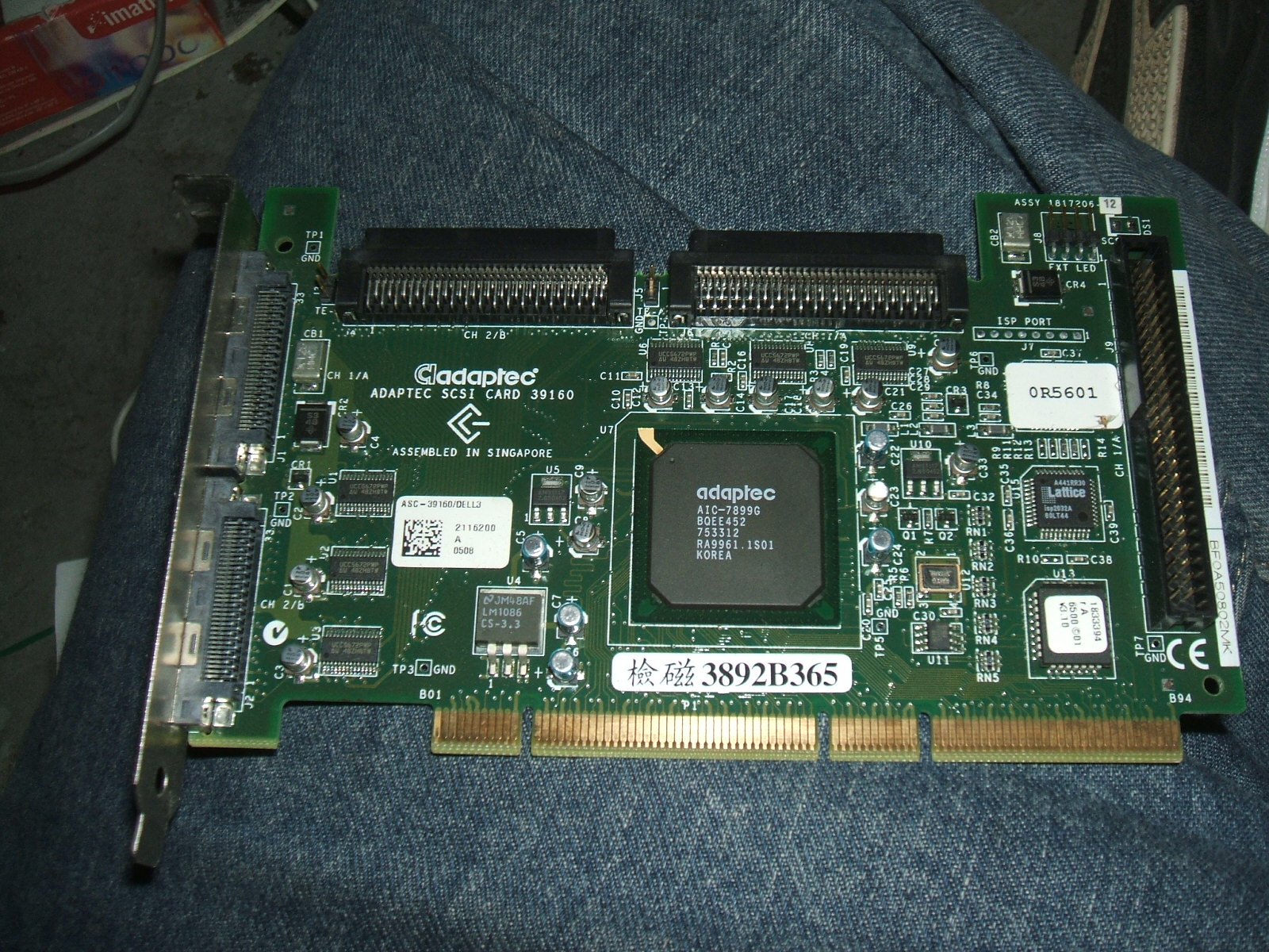

    And then there is the SCSI host card:
    I have NO use for such a thing... but holy cow. Monster of a card (not HW raid though, I bet those are real monsters).

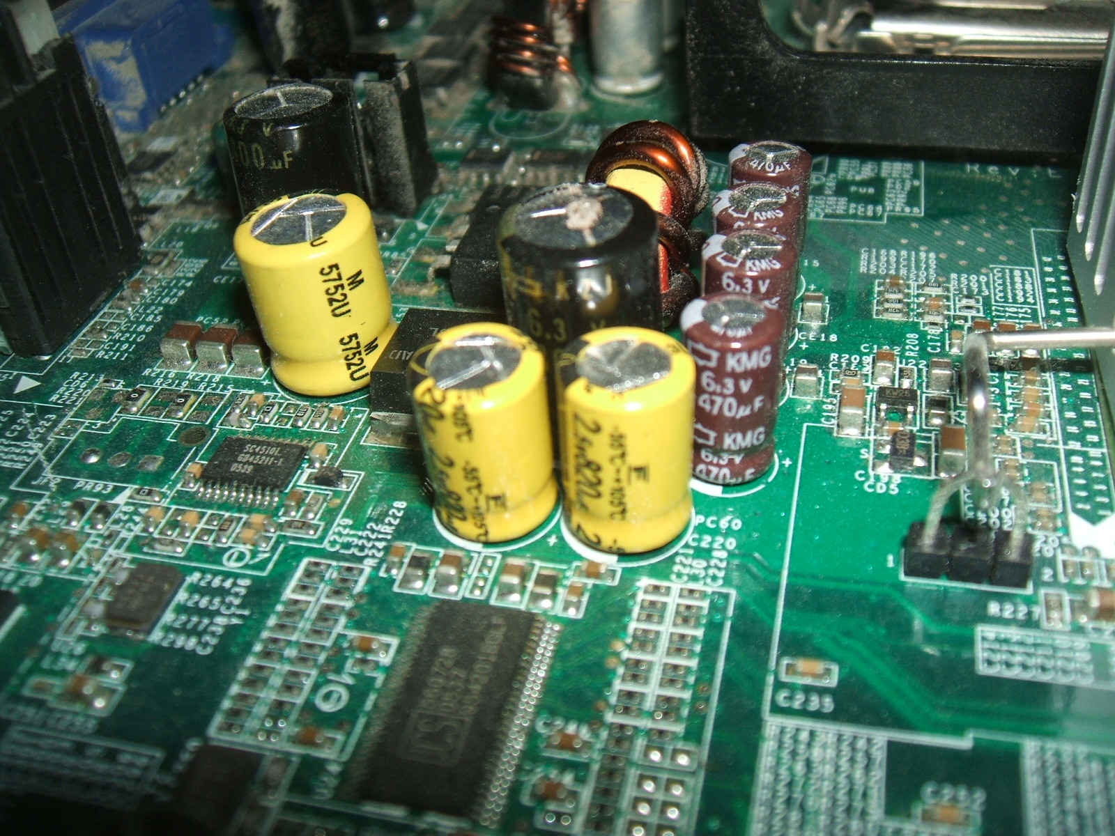

    It wouldn't be a BCN post without a bad cap:
    3 KZJ's, one blown. And it had to be a size/voltage/value combo I don't happen to have in my stash... and since I have to order stuff anyway, I'm not gonna hack in an 8mm.

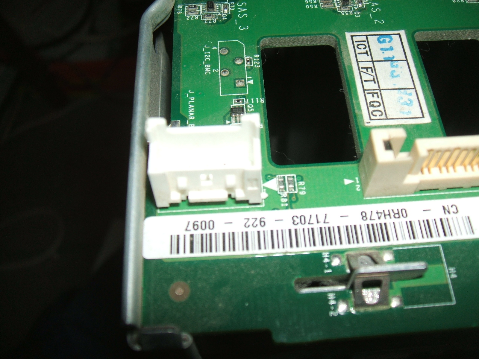

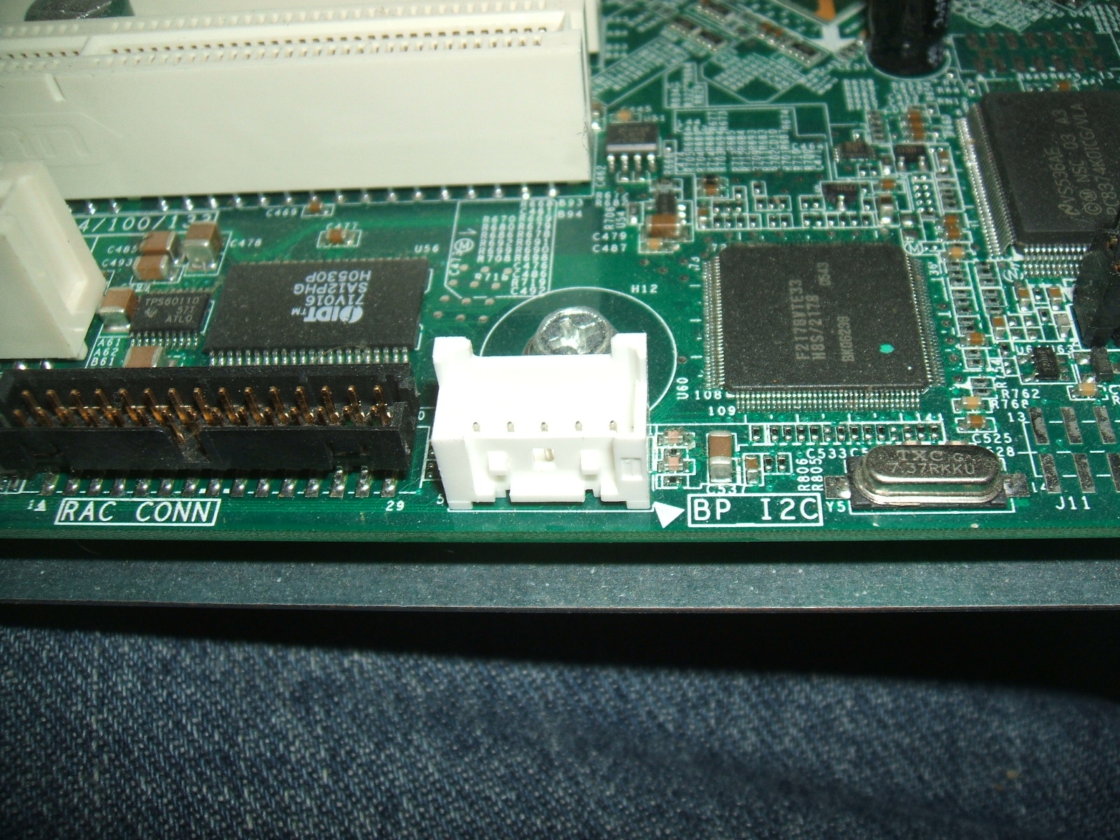

    Regarding the missing cable, the connectors are:

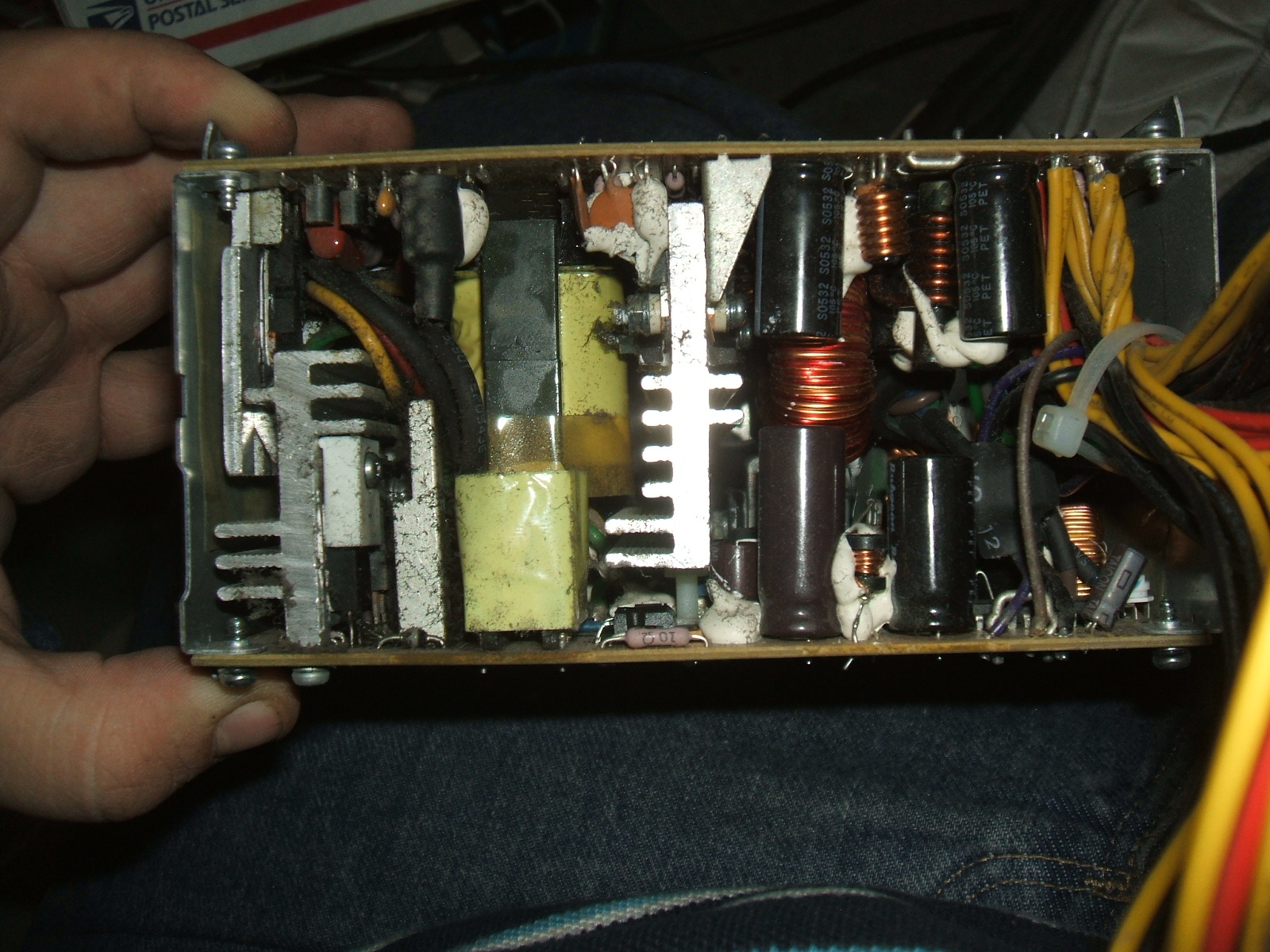

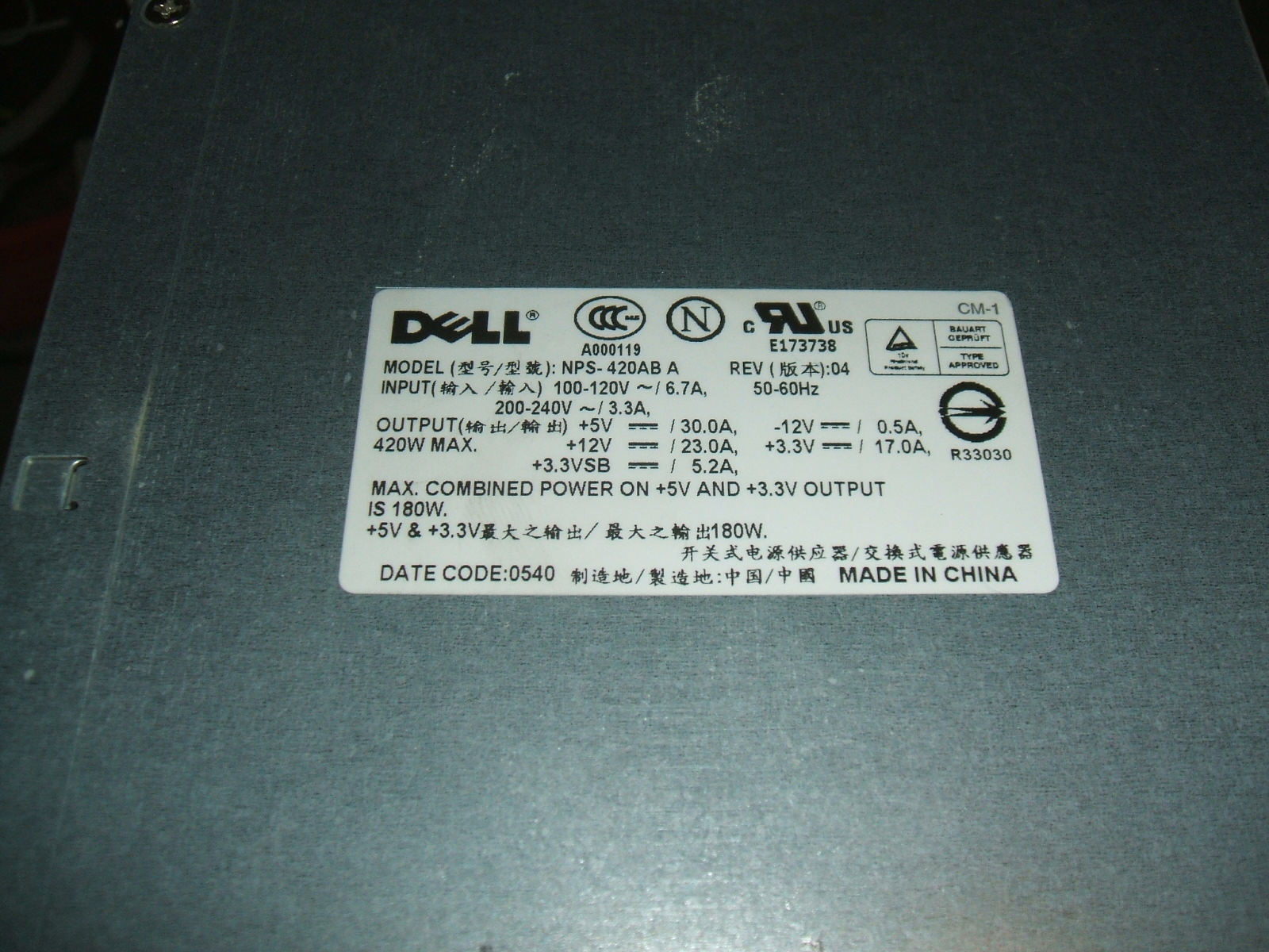

    The PSU is a beast:

        The I2C cable is unobtanium... as it seems the SAS option was a bit rare.
        It's a longer one of these:
        http://www.ebay.com/itm/Genuine-Dell...item4d17cbb618
        Which I will buy and splice extensions on since NOBODY has the stock version of. The backplane's connector shell was almost completely ripped off the pins when I got it, so I bet the old cable was ripped and tossed.

          Ended up ordering this:
          http://www.ebay.com/itm/131352503791...%3AMEBIDX%3AIT
          which happens to have the also unobtainium heatsink mounts and I2C cable. The extra CPU upgrade and a spare board is icing on the cake.

            Looks a lot like you have a PERC 5/i. Quite a nice card for how cheap they are, I have one here and a PERC 6/i in my Poweredge 2950.
            One nice thing is the ram is upgradable and you might be able to flash LSI firmware to it, people seem to argue on whether it works. If you ever end up pulling it out of the system you can also get adapters to use it without a backplane (SATA breakout cable).

              ^Nah, I'll just up the RAM and see if I can flash the firmware.
              From what I can tell SAS wasn't an option on the 830; this one is a hodge podge of two different systems (hence why the hotswap module has chassis mount). It's possible that that's why i couldn't obtain the correct cable either. Looks like I'll have to make my own cable and hope it works.

                Well Shit. Potential bad news about the RAID Card
                From what I'm reading since it's a dell card linux may not be compatible... hopefully it is w/o a bucnh of firmware hacking bull pucky (it's not even SAS per se). Also, the RAM is not upgradeable; even if it accepts an upgrade it will only use the 256MB it was designed for.
                Worst case I whack in my 3ware 9500 and make a SATA adapter for the backplane power cable (and ditch the backplane all together).

                  change the firmware on the card with uniflash.
                      Unless it's a weird one I've used both a Perc 5/i and 6/i under Linux and never had issues. Which specific card is this one anyways?
                        perc 5/i.
                        If it works, then sweet... this will be a kickass build then.

                          Board #2 came in yesterday
                          Oddly the caps in question were NOT KZJ's... but 3 470uf 16V;s WERE... and on top of that week 50 2005 HM's (those OK?)
                            Yes, they will be fine.

                              ^thought so, since it was that late in the year.
