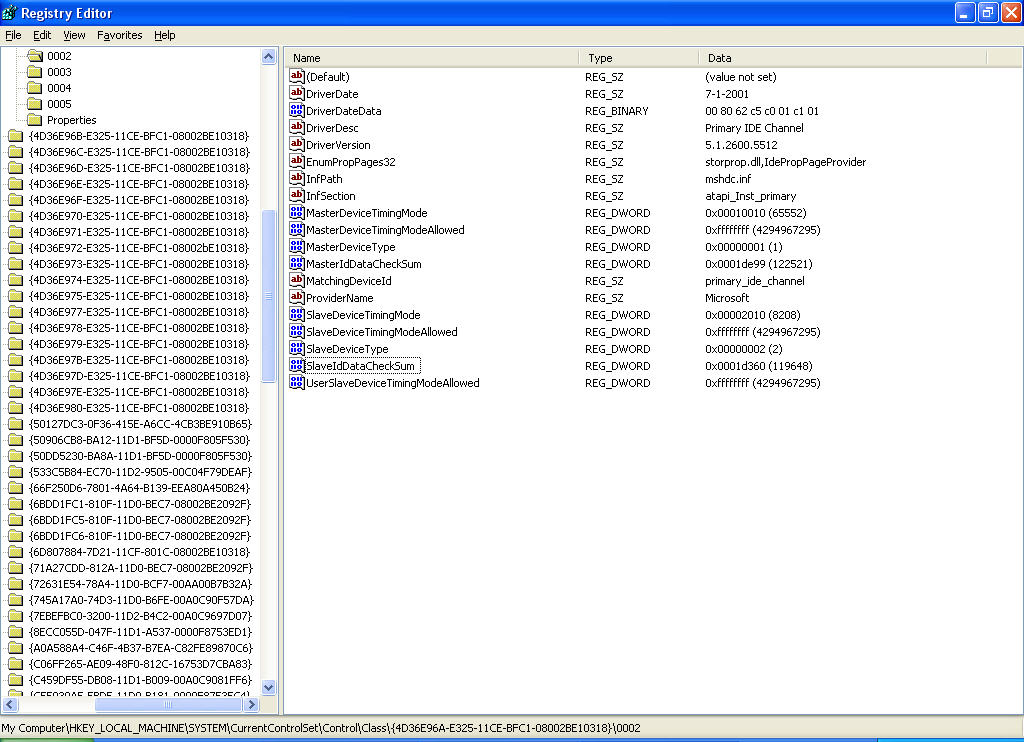

          1) When the CD-ROM was showing up in Windows, I uninstalled it and then reinstalled it. It didn't help. It reinstalled it but after the first Shut Down it redisappeared again.
          2) Then I again caused it to appear, uninstalled it via Device Manager and then I remembered when a few years ago my hard drive suddenly didn't want to use UDMA (again, only one drive in specific acted weirdly, while all the others worked fine, so it was kind of a simillar problem). I tried to recall the steps I took back then. I went to this registry key:
          HKEY_LOCAL_MACHINE\SYSTEM\CurrentControlSet\Control\Class\{4D36E96A-E325-11CE-BFC1-08002BE10318}
          There, I looked in all of the 4-digit subkeys (0001, 0002...) until I found one for Primary IDE Channel and one for Secondary IDE Channel. In Primary, there was 1 extra string (UserSlaveDeviceTimingModeAllowed = 0). I deleted that one and all the others which had this "SlaveDevice" prefix in them).
          3) I then restarted Windows, it loaded and "New hardware found..." message appeared. Windows then reinstalled the driver and TEAC CD-540E was again present, alive and kicking. Then I went to the Registry again to see what has been changed in the above mentioned key, and sure enough Windows added again these strings but placed different values in each of them (as if it clean installed them). From that moment on, CD-ROM appears as normal and works as it always did, after every boot and shut down. All drives use UDMA also. So, "problem solved" for now.

          Although I don't know what could cause Windows to label a drive as physically non-visible on its own and why this particular one when there are two other present, or what has changed these settings for Primary/Secondary controller. And why now after so much time? It was its first instance of this, I think. I did not install any new hardware or software prior to this. I like XP and it serves the purpose on this older PC quite nicely.
          Today I started the PC and the drive is here, exists and works. We shall now see whether it will stay there. If it works, maybe somebody else can find these information helpful.

              In case it helps over time there is a VB Script available that will reset the UDMA/PIO modes for you with a restart for convenience.
              SRC: http://winhlp.com/node/10
              I also attached the script for posterity. Simply remove the .txt portion of it and launch it as normal. If so inclined if the problem persists while this fixes it... could always remove the message box verification from the script so it automatically does the task for you and then link it as a part of a shutdown script.
