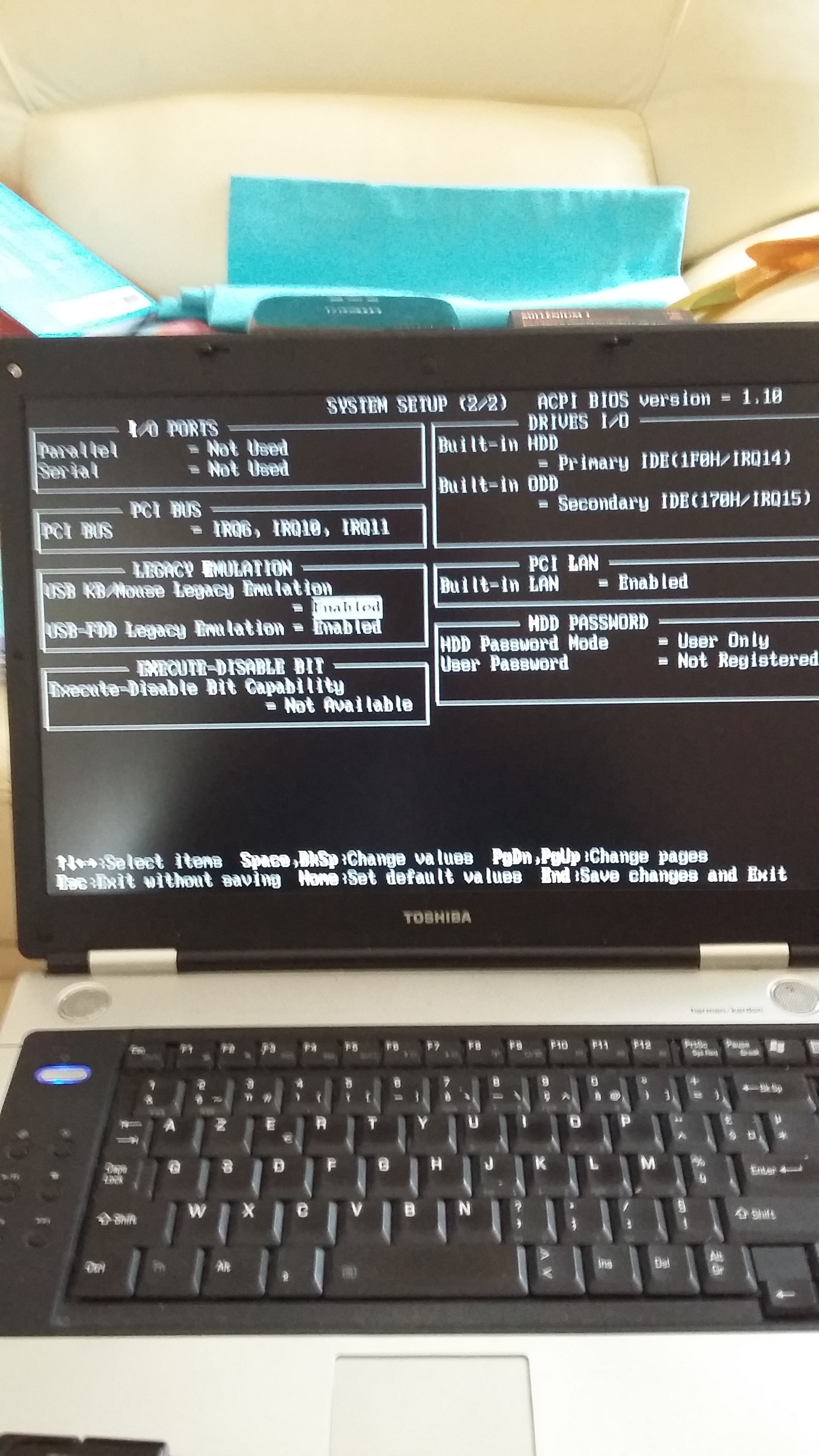

    on this old laptop toshiba satellite m40 331 i am trying (but failing) to upgrade frow w7 to w10 and allways i have the error : 0xc1900101 - 0c20017. The upgrading process stops with the pc blocked with the logo screen w10 on the display; then there is no activity on the disk hdd or ssd.
    it's also impossible to boot from a dvd iso bootable, the device equally blocks on the w10 logo screen...
    i verified the informations in the device manager and it seems there are no problems...

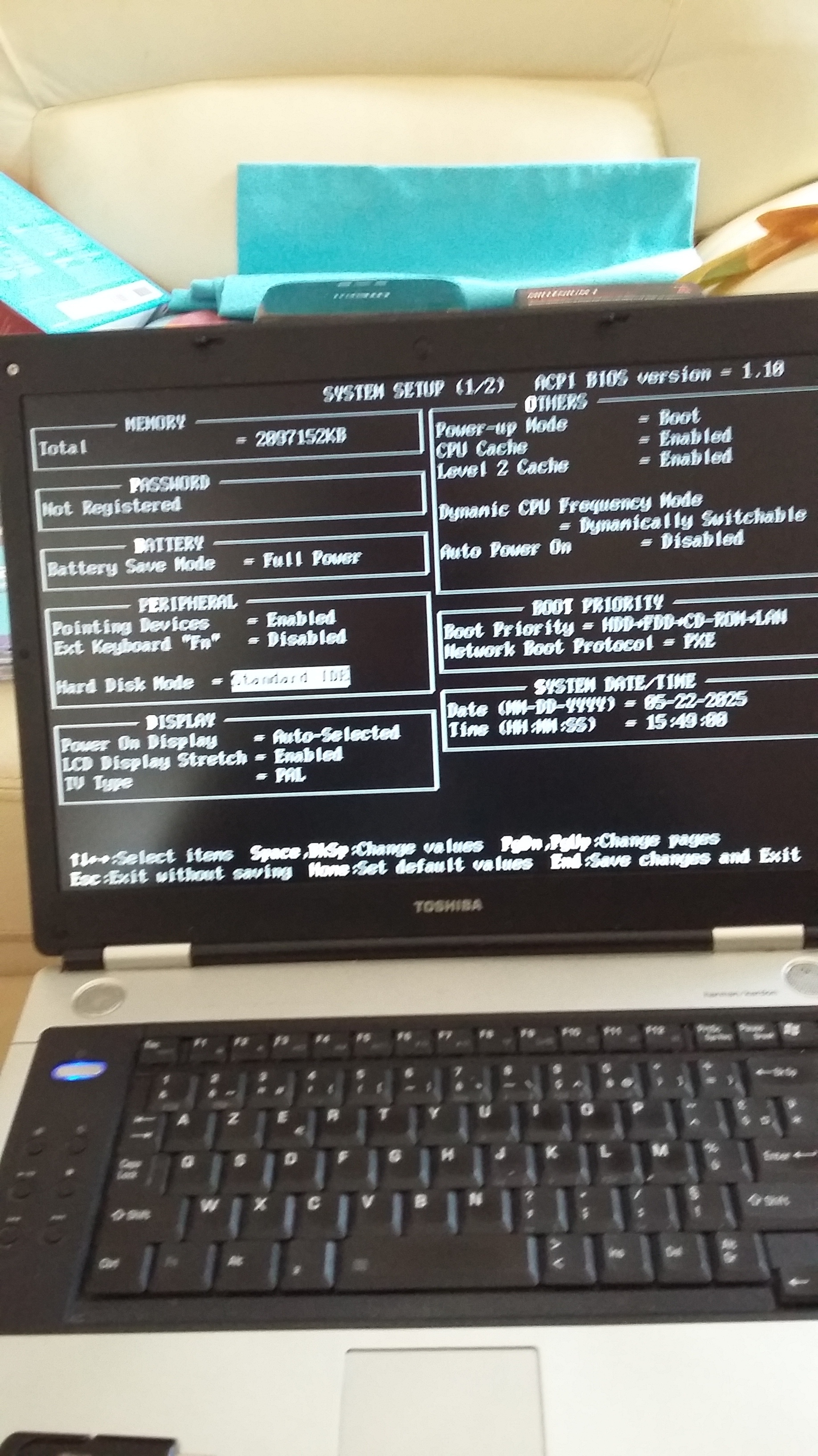

    i wonder if it's not an issue about the bios (which is very old) or an interface problem with the disk (because when i open the bios i find nothing relative to an AHCI/SATA positionning).
    with this post i let you two photos of the screens of the opened bios.
    Here are the informations about the bios characteristics read from msinfo32 and dxdiag reports and apparently they don't coincide. (msinfo32: TOSHIBA Version 1.10, 26/09/2005 - dxdag : Insyde Software MobilePRO BIOS Version 4.20.09).
    Perhaps somebody can give me more information about this bios and eventually it's update? or give me suggestions to understand this matter?

    Hi, which CPU do you have? You can check with CPU-Z
    From what I read Windows 10 requires that the CPU supports Execute Disable bit, according to your BIOS screenshot is not supported

        Sorry, can't find a newer BIOS, appears you have latest version according to dynabook website for a similar model (cannot find your exact model on dynabook website)
        Description:
        Change History
        Version 1.10 ???09-26-2005
        Note: This BIOS is applicable ONLY to Tecra A4 (PTA42u...) and Satellite M40/M45 units (PSM42U...) having ATI or nVidia display adapters.
        Besides, windows 10 will be very slow with only 2gb of RAM​

              The Pentium M was released 22 years ago, as yours shows it having XD not supported in the BIOS you can not run anything newer than Windows 7.

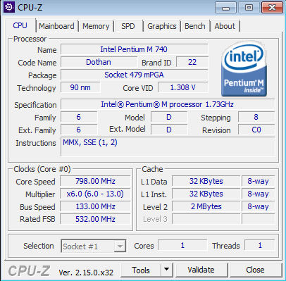

                    i studied with care the answer of Per Hansson and i put here in attachments the reports of cpu-z which shows that my processor was a Dotham one 740...but in the article quoted in the link they indicate that may be, this last model of processor may be compatible for windows 8 and later :
                    Revisions of the Dothan core were released in the first quarter of 2005 with the Sonoma chipsets and supported a 533 MT/s FSB and XD (Intel's name for the NX bit); and the PAE support flag in the CPUID was enabled, unlike earlier Pentium Ms that showed PAE unavailable. This resolved boot errors in Linux distributions as well as with Windows 8 and later. These revised Dothan processors include the 730 (1.6 GHz), 740 (1.73 GHz), 750 (1.86 GHz), 760 (2.0 GHz), 770 (2.13 GHz) and 780 (2.26 GHz) and have a TDP of 27 W and a 2 MB L2 cache.​

                      Execute disable must be enabled in the BIOS, if the BIOS does not support it then the operating system will not be able to take advantage of it...

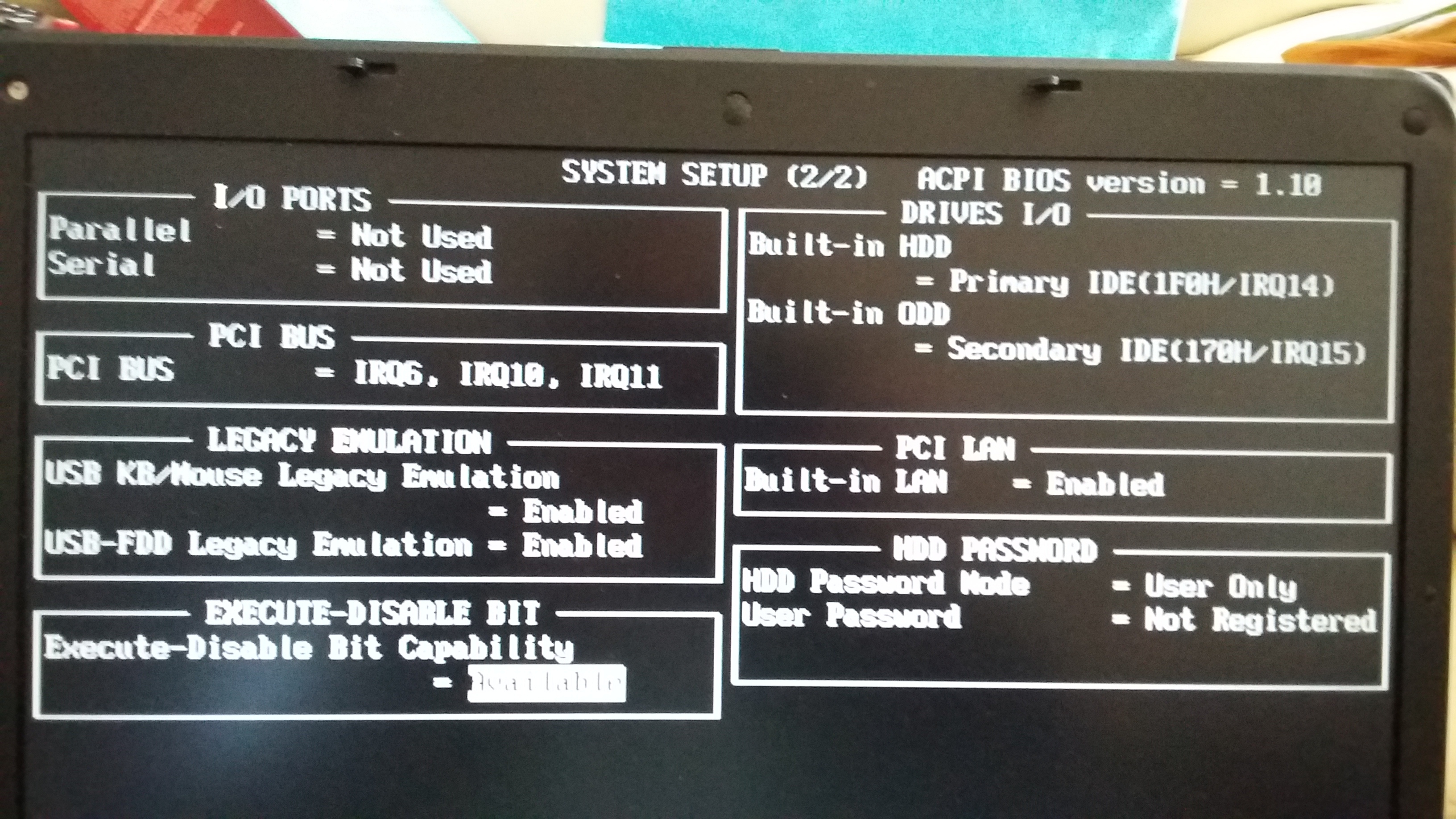

                        i come back to what was saying Per Hansson in the #7 post about the XD and NX bits...

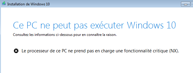

                        in the bios of the toshiba pc i found a positionning : "execute-disable bit capability"....and if i switch it to "available" then the process of upgrading the pc stops with an error message (see in attachments) indicating that the installation of windows 10 is not possible because the NX fonctionnality of the processor is missing...this apparently is not what i expected to have because normally the dohan 740 processor like mine must have had it...
                        but in the same time that's compatible with what i saw when the process of upgrading stopped on the logo w10 screen which corresponds to the announced crash when loading the ntoskrnl.exe​.
                        after all that, i think that i have to stay on the windows 7 installation.
