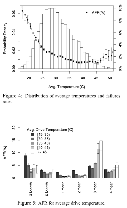

I don't understand why this keeps coming up, by several other people aswell.one thing about seagate: they run hot, but they dont like hot!
according to research done by google the best temp for an HDD is around the 32c mark. https://cdn.badcaps-static.com/pdfs/...0fb92118d6.pdf
I admit that I'm not English native but still doubt that I could come to such a different conclusion after reading that report, an excerpt below:
3.4 Temperature
Temperature is often quoted as the most important envi-
ronmental factor affecting disk drive reliability. Previous
studies have indicated that temperature deltas as low as
15C can nearly double disk drive failure rates [4]. Here
we take temperature readings from the SMART records
every few minutes during the entire 9-month window
of observation and try to understand the correlation be-
tween temperature levels and failure rates.
We have aggregated temperature readings in several
different ways, including averages, maxima, fraction of
time spent above a given temperature value, number of
times a temperature threshold is crossed, and last tem-
perature before failure. Here we report data on averages
and note that other aggregation forms have shown sim-
ilar trends and and therefore suggest the same conclu-
sions.
We first look at the correlation between average tem-
perature during the observation period and failure. Fig-
ure 4 shows the distribution of drives with average tem-
perature in increments of one degree and the correspond-
ing annualized failure rates. The figure shows that fail-
ures do not increase when the average temperature in-
creases. In fact, there is a clear trend showing that lower
temperatures are associated with higher failure rates.
Only at very high temperatures is there a slight reversal
of this trend.
Figure 5 looks at the average temperatures for differ-
ent age groups. The distributions are in sync with Figure
4 showing a mostly flat failure rate at mid-range temper-
atures and a modest increase at the low end of the tem-
perature distribution. What stands out are the 3 and 4-
year old drives, where the trend for higher failures with
higher temperature is much more constant and also more
pronounced.
Overall our experiments can confirm previously re-
ported temperature effects only for the high end of our
temperature range and especially for older drives. In the
lower and middle temperature ranges, higher tempera-
tures are not associated with higher failure rates. This is
a fairly surprising result, which could indicate that data-
center or server designers have more freedom than pre-
viously thought when setting operating temperatures for
equipment that contains disk drives. We can conclude
that at moderate temperature ranges it is likely that there
are other effects which affect failure rates much more
strongly than temperatures do.
