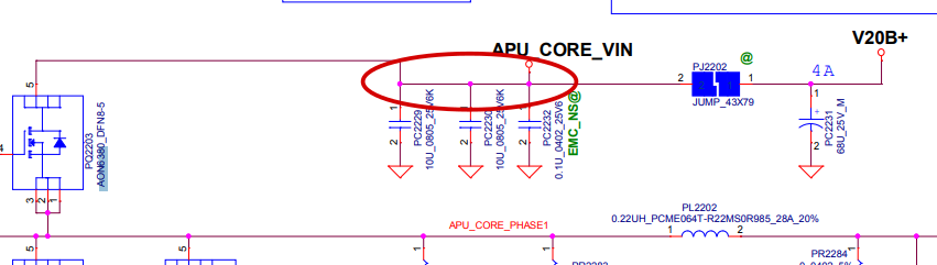

I'm a newbie trying to learn to repair. Now I'm learning to use schematics and based on the image I have a short on that smd capacitors and I will try to voltage inject so I can find the short. I'll just verify if I will put the positive probe on the one I encircled? Thanks in advanced
Schematics tutorial
by Hw31i guess its the main power rails, as it has widests vias. i tried injecting voltage 1v and 1-5a but nothing is getting hot. resistance to gnd is about 0.002 or something like that(will update later). as its the main powerrail, do i raise the voltage to 19v and then inject 1-5amps? thx
