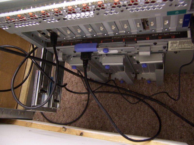

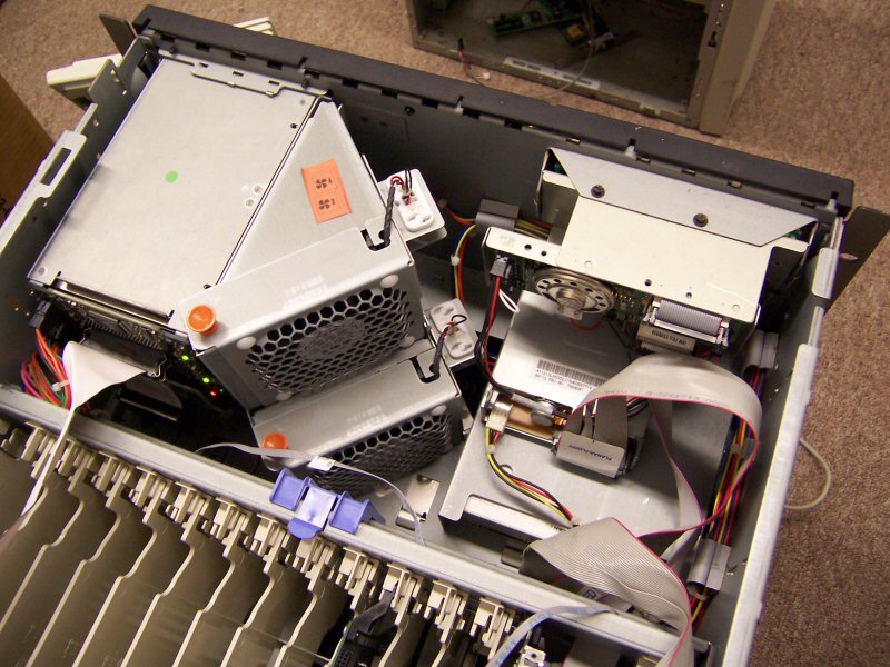

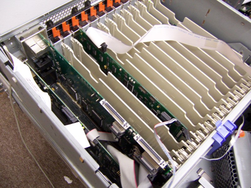

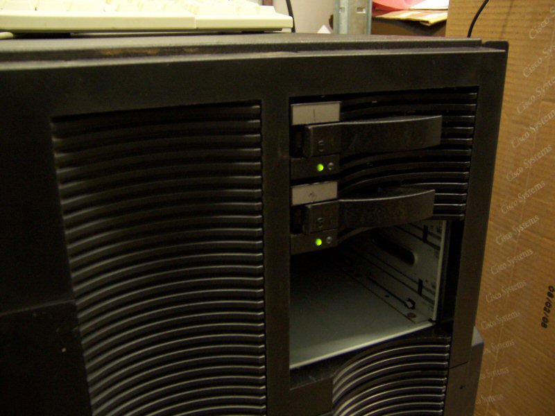

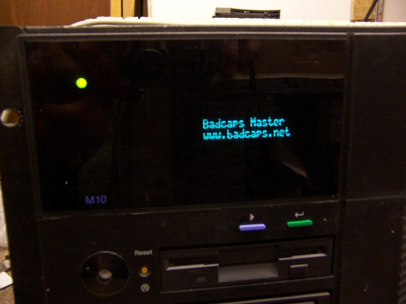

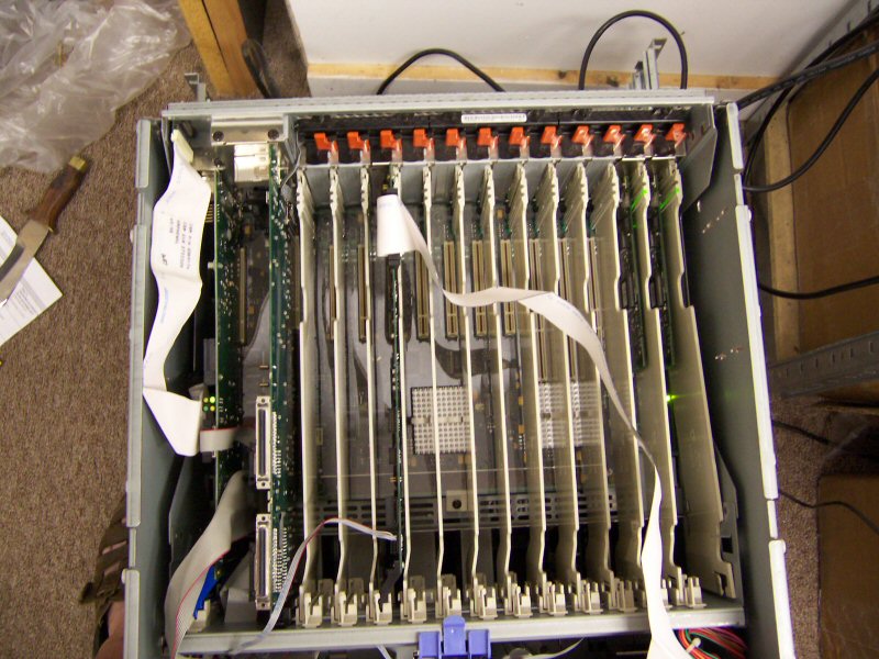

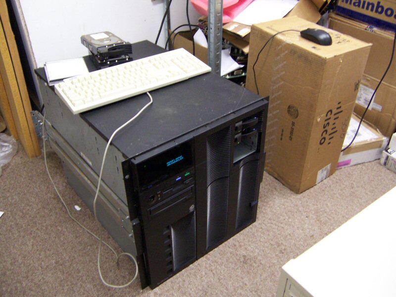

        She's no longer in operation, shes been retired since 2007 when I pulled her out of one of the datacenters. I still have her here, and no plans to get rid of. Last time I had her fired up, she'd BSoD on occasion, never bothered troubleshooting. She's got 4x 146gb SCSI320 10k RPM HDD's in that SCA backplane. Shes a netfinity 7000.

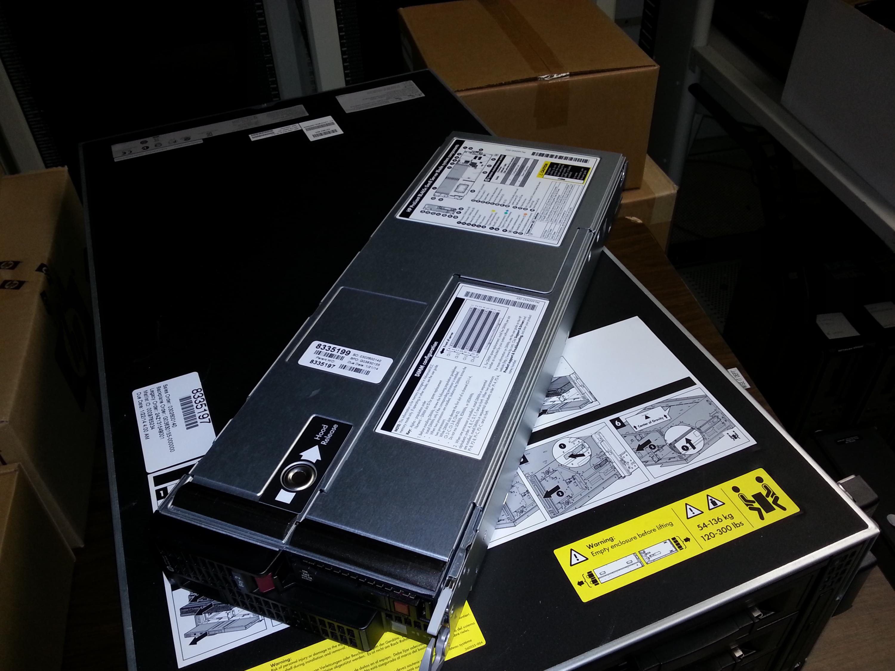

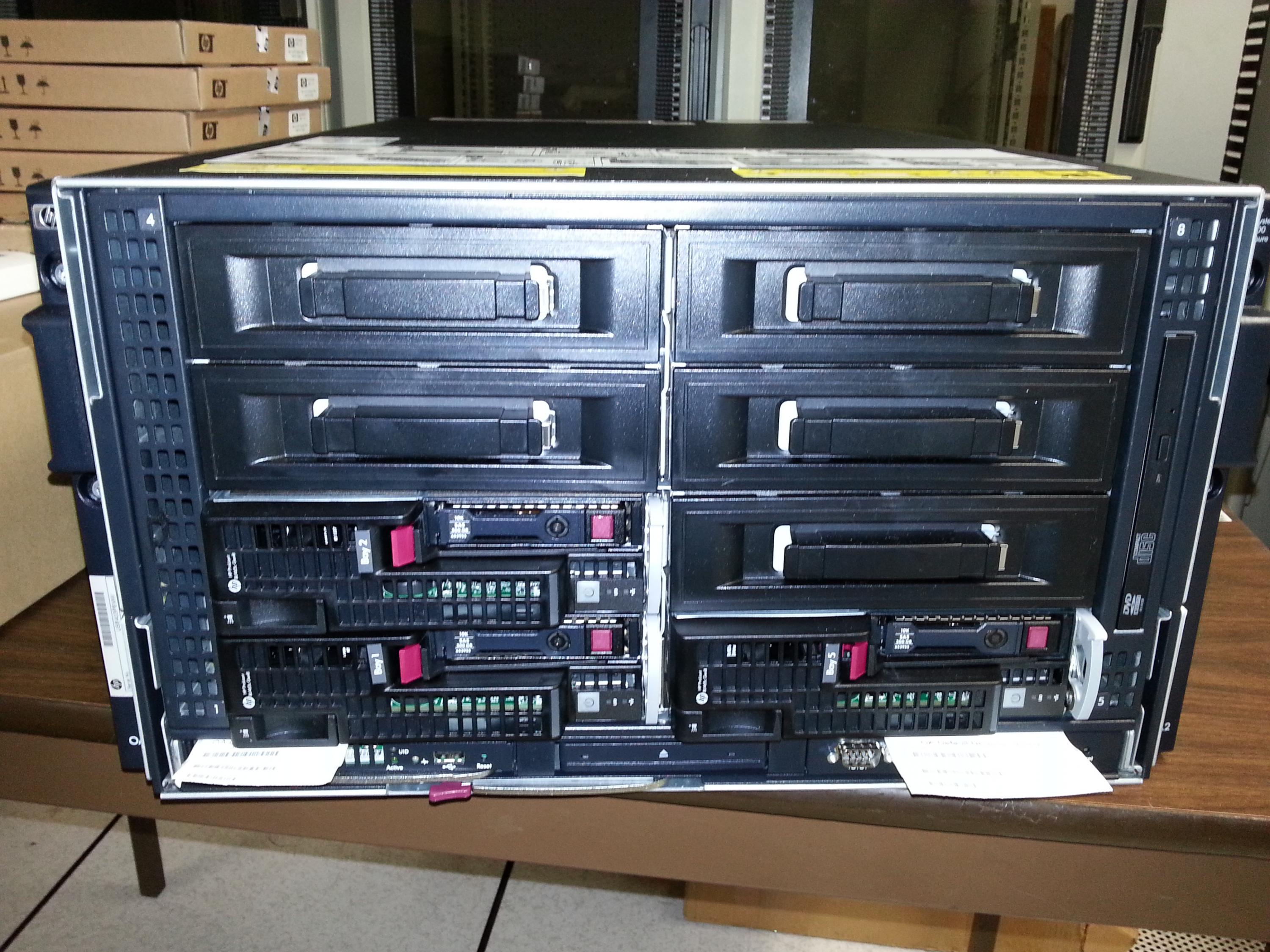

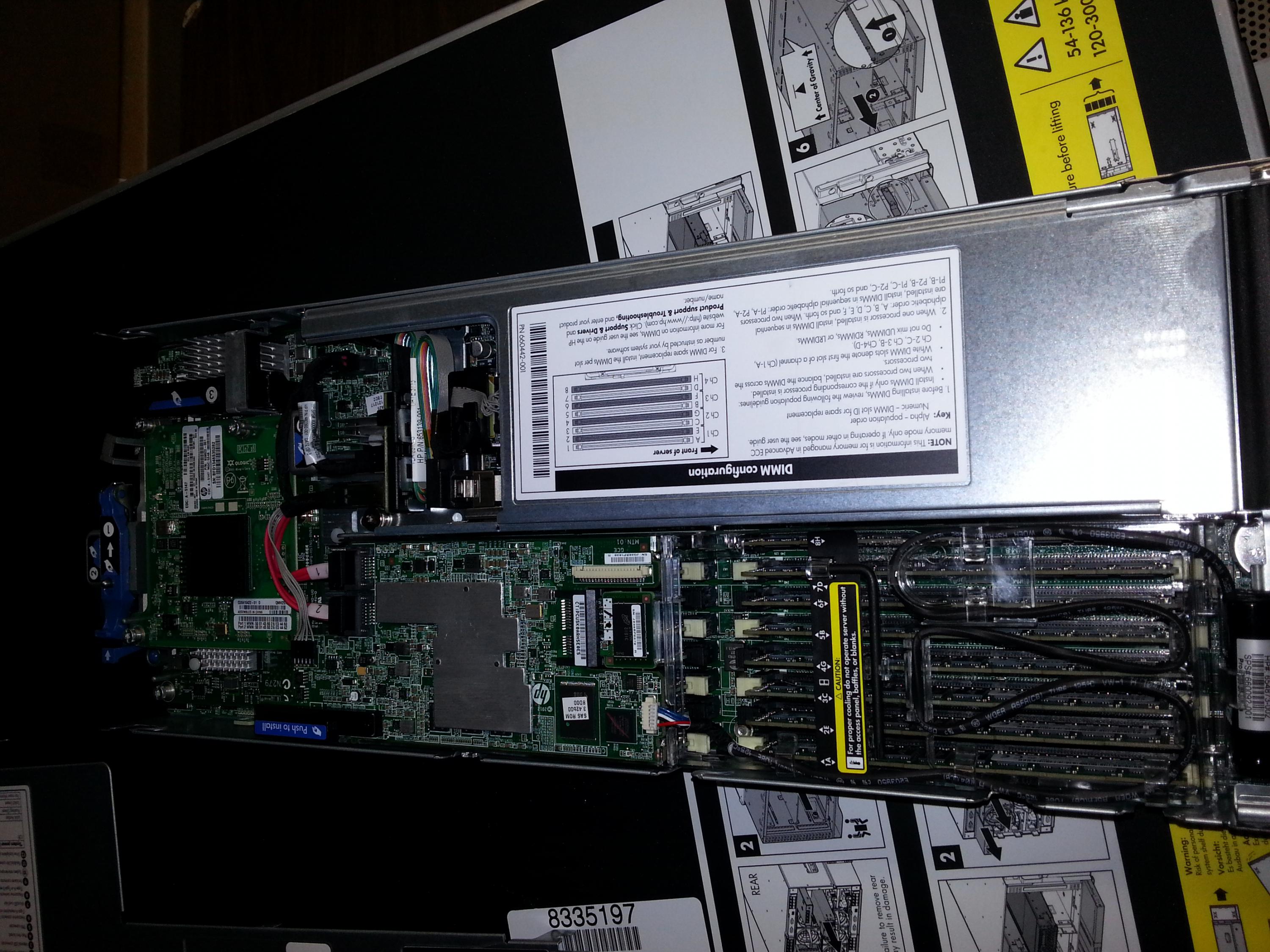

          Decided to make my own thread to share the trials and tribulations of my new Hyper-V buildout. This system has been 6 months in the works, with many revisions to the initial spec. There were a lot of meetings that felt like we were
          Originally planned to be 3 HP DL360's and an EMC VNX 5300 SAN, it eventually changed to a C3000 BladeSystem, with 3 BL465 blades and an EMC VNX2 5200 SAN. It took so long to nail down the specs that EMC actually released a new line of products in the meantime, which meant we had to change the spec AGAIN.
          So far, I have the BladeSystem and fiber channel backend in house. The SAN is supposedly being delivered today. We'll be connected to the internal network with 6 10gbit fiber links, and from the bladesystem to the san with 8 8gbit fiber links.
          Everything was spec'ed out with redundancy in mind. We should be able to drop two of the 3 blades and suffer only a slight reduction in performance. The SAN and internal communications are all fully redundant, as are the power supplies.
          Interesting note on the BladeSystem PSUs.... they're 1200w in a very small formfactor. I went to look at specs, and found that they only output 12v. Must be stepped down elsewhere in the enclosure. But they'll do a solid 100amps @ 12vdc!
          Anyway, pics of the BladeSystem are attached. I'll keep the progress updated as we go.

            I combined my old beater server posts with this thread. Yea, I think its safe to say that you have mine beat. I got this server second hand in 2004 iirc. Ran it several years until it began having stability issues and phased it out.
            RD, if you bring the 'rango, I may just send it home with you. It'll take 3 mules and a crane to lift it up though...
