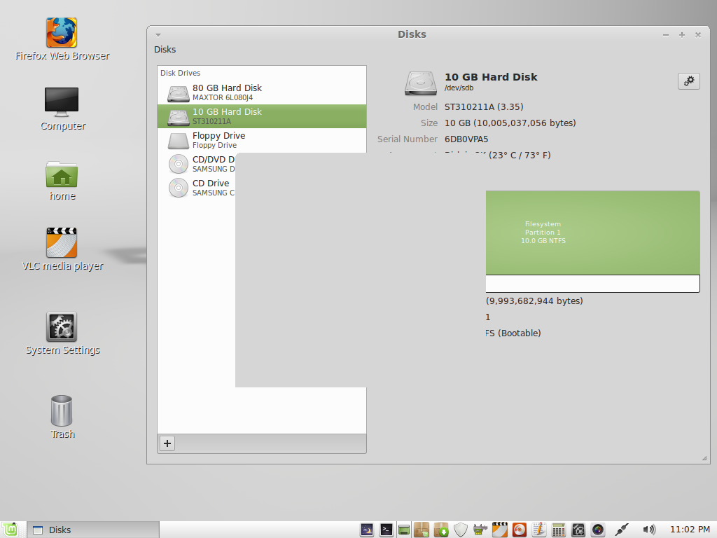

    10GB Hdd and 80GB HDD?
    Hi guys; can you please tell me what is this 10Gb hard drive is this? i know that this Pentium 4 dell has an 80 Gb hard drive,

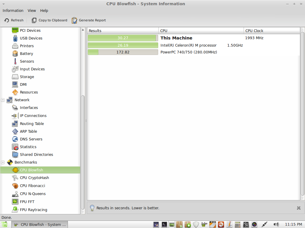

    Also someone explain this;this is an pentium 4 but i took this screenshot of this!

        Re: 10GB Hdd and 80GB HDD?
        It's a 10 GB hard disk.. duh. Just google the ST3... code and you'll find more information.
        For example this : https://cdn.badcaps-static.com/pdfs/...41a8d8bf91.pdf
        The second picture... you're doing a benchmark, Blowfish if i remember correctly is an encryption algorithm.
        So the software tries to encrypt some data and measures how fast it does it, then compares it to other processors. The software just tells you that for this particular purpose (encrypting some data), your processor is as fast as a particular Intel Celeron M 1.5 Ghz.
        That is possible. The Pentium 4 is old and supports a set of instructions. The Celeron M may be newer and may support some additional instructions which make encrypting stuff faster, so even though the Celeron M may be slower in some things and run at lower frequency, due to those additional instructions it may encrypt faster than the Pentium 4.
        The Celeron M may be slower at video encoding for example, compared to Pentium 4.
          Yes it looks like someone slipped in a 10GB HDD into your computer without you knowing about it... but it should have shown up during BIOS enumeration (unless you have the OEM logo turned on, possibly it gets hidden.)
          From what I've played with, a Celeron-M at 1500 MHz (HP Pavillion DV4000) is sometimes faster than a Pentium-4M 2000MHz (Dell Inspiron 1100) but they are generally similar.
                  The HDD may be HPA'ed.
                  HPA= host protected area, a feature you can configure to prevent an OS from accessing more than a certain amount of the HDD.
                  In another words, tell the computer that there's less LBAs than they're actually are. Thus, reporting a smaller size to the BIOS than the HDD really is.
                  It's not... his first screenshot clearly shows one is a Maxtor and one is a Seagate. The model corresponds correctly to a 10gb drive - http://www.driveparameters.com/Seagate/ST310211A/
                  The 6L080J4 was a 7200RPM drive. Assuming it's still healthy (no bad sectors), it would be the better choice for the OS drive than the 10GB Seagate.

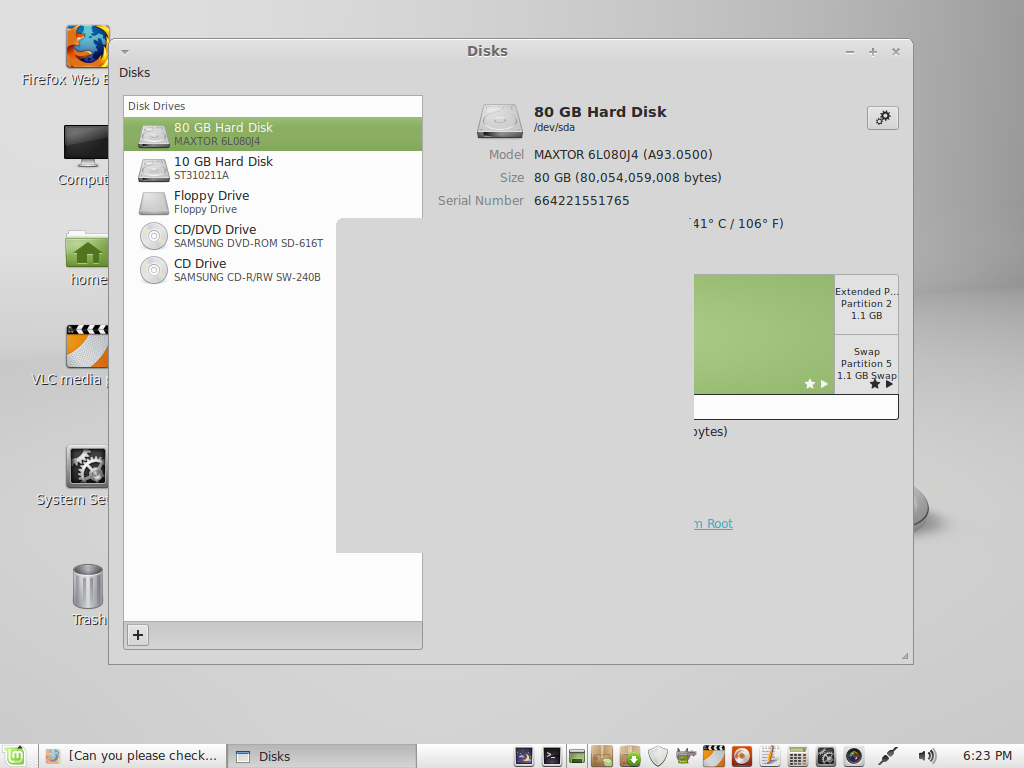

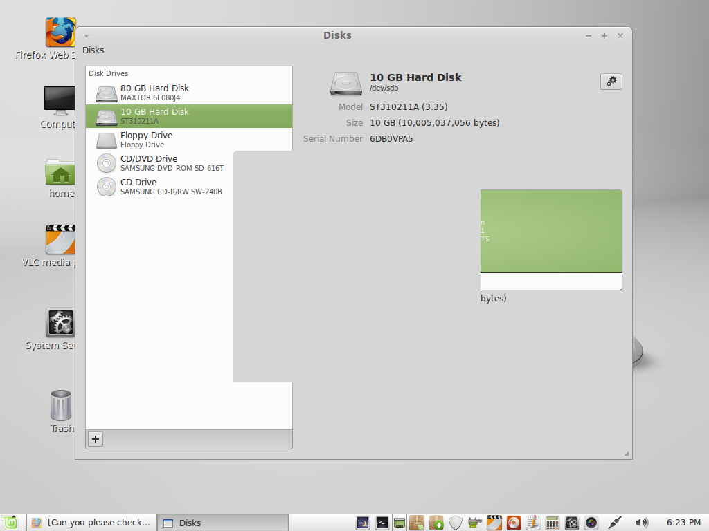

                            Hi guys for what i understand i can remove the 10gb connection tape and leave just the 80gb connection Tape?
                            • mariushm
                              • May 2011
                              • 3799
                              Yes, you can.
                              You may have to set the remaining drive as master by moving the jumper to the proper position.
                                    Originally posted by ivtec
                                    Thanks mariushm; today i opened it up and disconnected the 10gb HDD and left the 80Gb connected but it did not boot,so i need to do what you suggested but how do i know what is the right position?, Guess i will try one position at a time and see! and post back.
                                    From what i see root (the linux installl) is on the 10gb drive
                                      thanks again maiushm for your tip, i just reopened up the PC,and( how easy this Dell PC to be opened never had one like this)< and disconnected the 10gb hdd and jumped the pins from the second to the first pins closest to the tape connector and restarted and it booted up perfectly,
                                      so is one less hardware running besides i did not need it for anything, it was there just to confuse the machine, like it did when i had the Xubuntu installed
                                      remember i posted about <Grub Rescue>thanks, you guys in this Forum just rock, love it here,my favorite of all forums, can't get by without it.
                                        Now the main HDD 80gb looks like this.see Pic.
