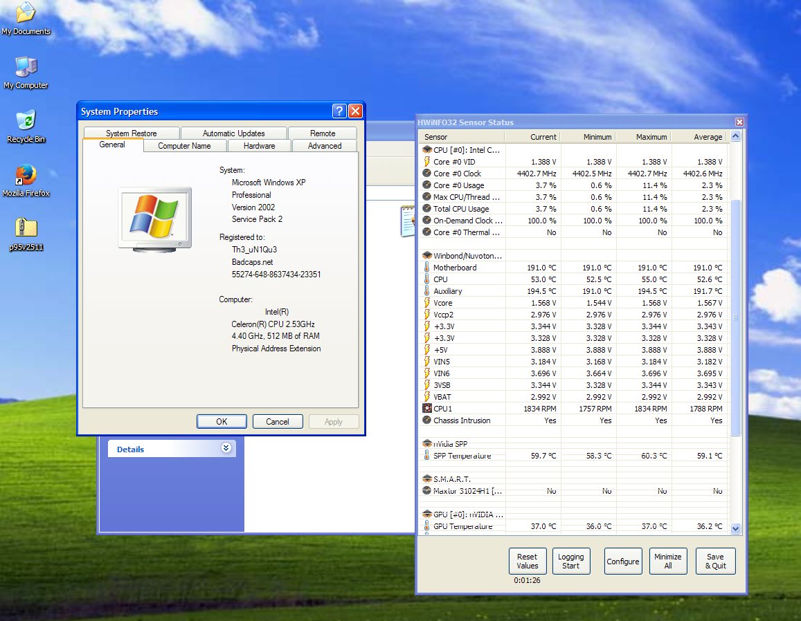

    I was bored so i did something stupid.
    Board: EVGA 650i Ultra
    Memory: 512MB Geil DDR2 667 4-4-4-12 @ 730MHz
    HDD: 10.1GB Maxtor ATA
    GPU: Palit GT210 1GB 128-bit
    CPU: Celeron D 2.53GHz @ 4.4GHz 1.56v
    Cooler: Stock intel cooler with copper base
    Had this board lying around since forever, it came in as "no video", and for the longest time i didn't have a PCI-E card to test it. It did display video with an old ATi PCI card. Now that i have this GT210 PCI-E i decided to test it. Seems there was nothing wrong with the board after all, except it's very finicky about RAM. Well, there is one thing wrong: Maximum Vcore voltage it gives in the BIOS is 1.6v, which is 1.55-1.57v in reality. And it looks like my Celeron wants more. Nothing that can't be modded tho...
    I also have a 3.06GHz Celeron D, but this 2.53GHz one overclocks better and runs MUCH cooler. I couldn't even POST past 4.26GHz with the 3.06GHz one.
    Btw, i did get it to boot at 4.4GHz, but maximum stable is around 4.33. And what exactly is this doing in custom tweaks? Mods coming later on. MOAR VOLTS! PS: The ridiculous temps you see there are wrong. The motherboard doesn't even report anything except CPU temperature in the BIOS.

          Follow-up: No need for pics, as the Vcore mod for this board does nothing for stability (it actually makes it worse!). It also heats the VRM like crazy, so i took it off. However, the vdroop pencil mod i found on the internet did help.
          Eventually i settled for something that draws less power and makes less heat, 4GHz at 1.42v. Above 4GHz this chip starts demanding a ton of voltage. Also interesting to note is while VTT (also known as "FSB Voltage") is essential for overclocking Core based chips, it doesn't make the slightest bit of difference with this one.
          Anyway... Is a Netburst-based, single core Celeron worth anything at 4GHz? Well, kinda. It can run a HTML5 fullscreen 720p video fluently, while not going over 70% load. That makes it at least remotely useful for multimedia. I also know the GT210 card is helping here however, i just don't know how much. I have found Adobe Flash no longer installs on XP, that's the reason for HTML5 - don't have anything else. Flash installer throws a IE script error and it quits. Both the activex version for IE and the version for firefox/opera. Good bye XP... I couldn't be bothered to try and find Flash 10.6 again, that worked fine IIRC.
          But realistically speaking, 512MB RAM and a slow and noisy (bearing noise, not churning!) HDD isn't my idea of a decent computer in this day and age. It just happens that i really don't have any more DDR2 around. And you don't wanna know how many tabs i normally keep open. With 4GB RAM, a better HDD and a beefier, quieter cooler, this could actually make a decent el-cheapo backup computer to have around the house.
