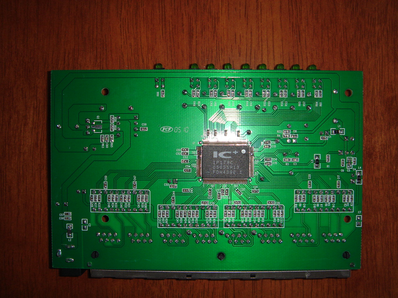

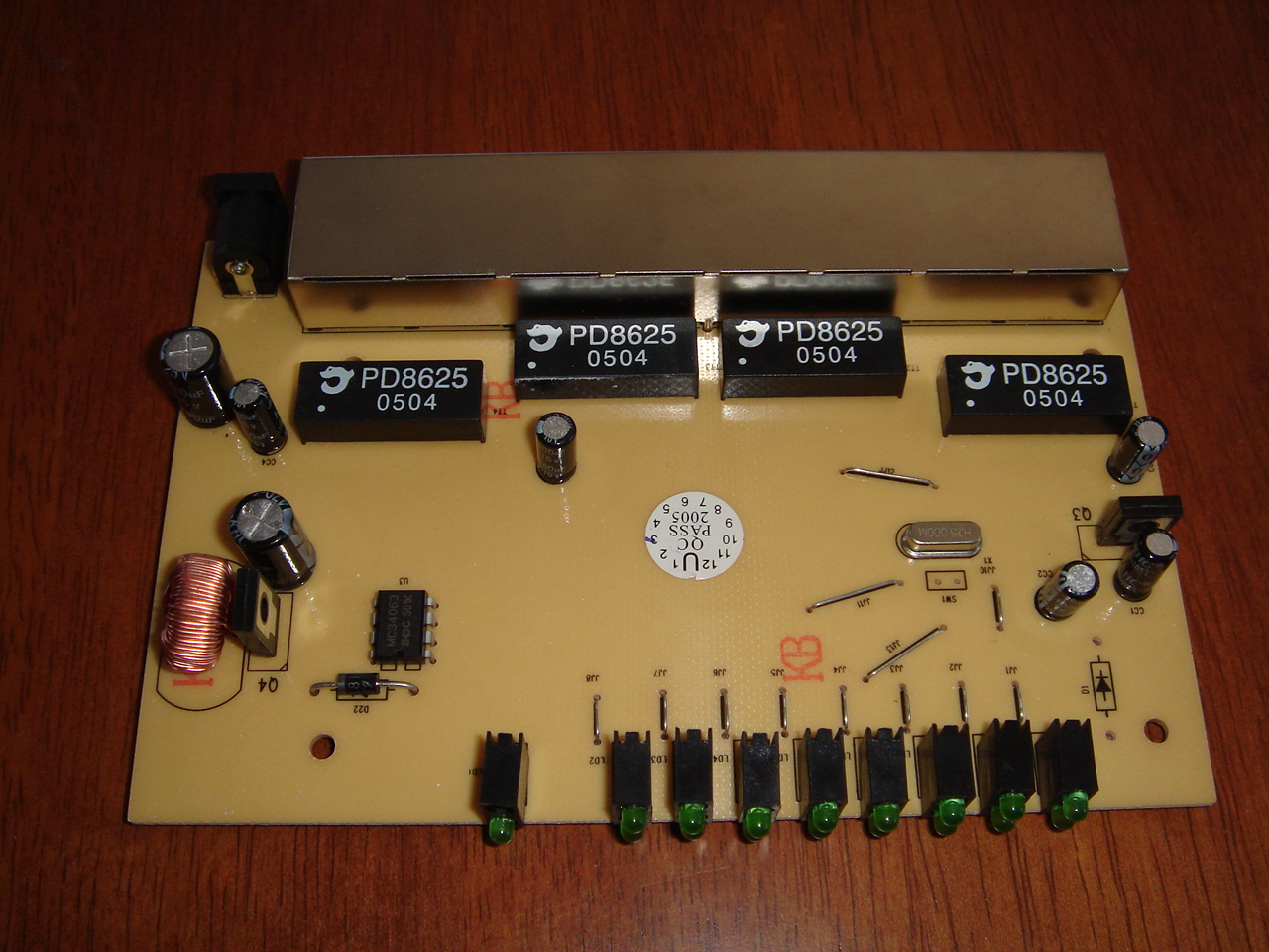

                I have some images of the internal components, anyone have ideas to any of these components? The caps are KHC? havent heard of them before. I'll send more pictures afterwards.... my cameras battery just died, sorry, i could only get two images up.
                Thanks.

                      He he he i am not shure if you have learned the lesson , any way if this switch will someday refuse to boot up, or realy won`t work, than you can replace those KSC crap caps. I have found some of them in many PSu`s 5v SB supply circuit, and they are failing alway very early and realy worse with severe bulging & leaking. But this is probably not only due the inferior quality of those caps, but more likely as those PSU manufakurers have used caps with inadequat ripple capability. That said, i think they should last some time under that not that harsh conditions in your switch.

                        Thanks gonzo0815, i am actually considering to recap this switch just to be on the safe side.... They are currently KHC 470uf 25V -40+105.
                        If i get around to recapping it, do the capacitors have to be low-ESR.... i am only guessing that the current caps are general purpose because they are in a network switch?
                        If they are just General purpose capacitors then i can replace them with the Hitano brand capacitors at my local electronics store.
                        Thanks.
                        Don't find love, let love find you. That's why its called falling in love, because you don't force yourself to fall, you just fall. - Anonymous
                          Re: Generic router not assigning IP?
                          The left side of the circuit is an MC3XXX SMPS, thus i would use high quality long endurance low esr caps like Panasonic FC FM or equivalent series from others. I would certainely not use ultra low esr caps for thsi circuit. The VRM on the right side is an linear converter, thus you can use GPO caps or the same as on the left side. But i would avoid again ultra low esr caps on this circuit too. The other caps, i would use something very long lasting like Rubycon ZLH or similar. But GPO caps would be fine to. Anyway, i would use for anything 105°c rated caps.
