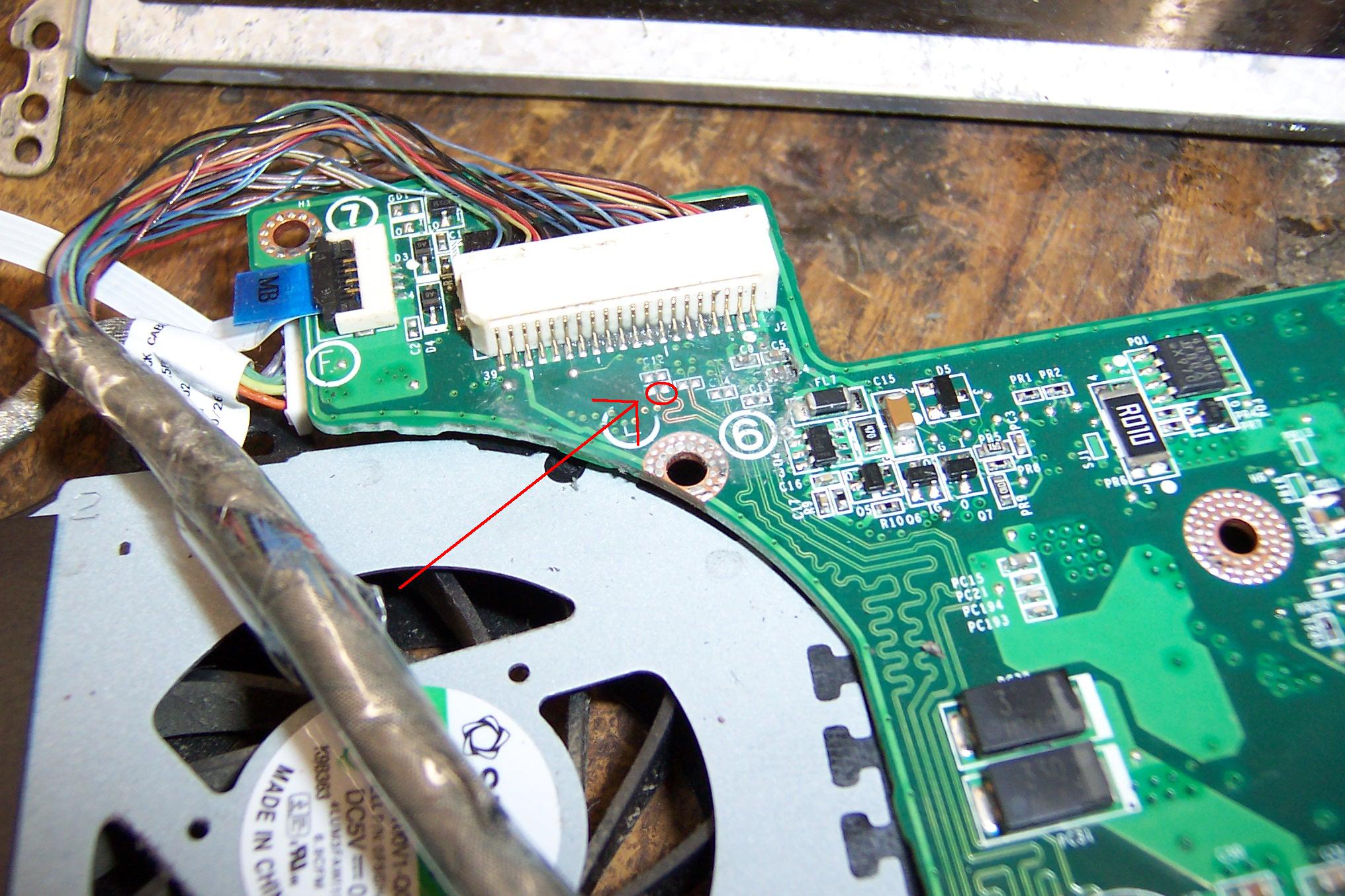

    From power On a Toshiba Satellite A500 display is filled with vertical multi coloured lines. Sometimes after boot the screen can sometimes begin to fill in very very slowly with what is like dark greyish patchy but appearing semi solid dark greyish colour and sometimes remains with the vertical multi coloured lines and in both case will go black within 1 or perhaps 2 minutes and not recover unless powered off then on.
    The laptop is completely dismantled and the soldered on motherboard battery measures 2.72v for a 3volt battery.
    When the laptop is apart I can press around the screen outer where the chrome is around the screen and the screen may change from some solid mainly darker blue colours to solid blue coloured lines almost like operating system colours and shapes and sometimes the word Tools appears in the mid left of the screen.
    I can press the motherboard all around and when I press over the socket where the screen cable plugs into the motherboard the same block colours can appear and change when I press on and off there. The changing to the coloured blocks is most consistent when I press that socket.
    This laptop had been dropped and the display cable had one broken wire in it so I replaced the cable and this problem persists. I also bent and place a piece of tin around the power socket and covered it with electrical tape because the plastic power socket surround inside the side of the laptop broke.
    So what could the problem be? I have replaced capacitors and may be prepared to replace a mother chipset at this point in my experience of computer and electronic repairs.
    Also just thinking now, it may be the new cable is broken near the motherboard socket plug, but the cable did appear to be brand new. I will inspect it closely, but also the fit into the socket is a little loose. The pins in the socket are all ok and I could not see any solder cracks and the joints all appear to be soldered ok.

    mightbe an lcd issue from when you repalced the cable you could have broke the little chip on film tab things or you could have damaged the LVDS slot when inserting the cable. remove the cable and check the slots... does the laptop work when connected to external monitor or tv
      Re: hi, laptop display issue, component level
      sounds like you broke the t-con board for the LCD or have a micro fracture running through the motherboard severing critical traces from when it was dropped.
      Does the laptop come with a vga/dvi/hdmi/display port out? Have you tried connecting an external monitor and see if the issue persists on that monitor as well, if not then it could be the cable or bad LCD.
        hi, I forgot the most important detail - yes the laptop display works perfectly connected to an external monitor by the laptop VGA port. I checked the board screen display cable socket and the solder joints and saw no cracks and the pins inside the socket were all ok. But the quick on and off finger pressure I apply to that socket has the most instant and the most display changing effect on the laptop screen although the display will not restore completely by doing this.
        The vertical multi coloured lines are the same with the old cable that was broken, but fewer multi coloured lines than with the new screen cable.
            I repaired a Dell which had intermittent video on its screen. I found open circuited LVDS tracks by checking the continuity of all track pairs going to the connector.
                Love...oops. I like pictures showing things like that, super. I think I find the pictures rather motivating.
                I will check the board carefully. I bought an endoscope on ebay for things like this but it only seems to want to work in XP so will try to crack that mystery for Windows7 if I can.
                The multi-coloured display colours are no different after I cracked the small round part in the "battery holder".

                        Anyhow, the laptop motherboard must be ok because external display is perfect. So I guess I am trying to solve a definite problem with the screen itself.
                        Problem solved....and a here is that chuckle.
                        And I don't think I can repair it myself. I think the ribbons are pulled from the screen somehow and I see the guys who post videos on YouTube about problems like this are also looking for repair solutions.
                        The solution may be something like a special type of heating resoldering process like reballing but for the ribbons to the display somehow.

                            I have many times tried repairing broken ribbons to an LCD and failed every time, I have tried a hell of a lot of times as I'm a comp tech...
                            There is nothing to lose in trying but my advice would be to replace the LCD if its cost effective.
