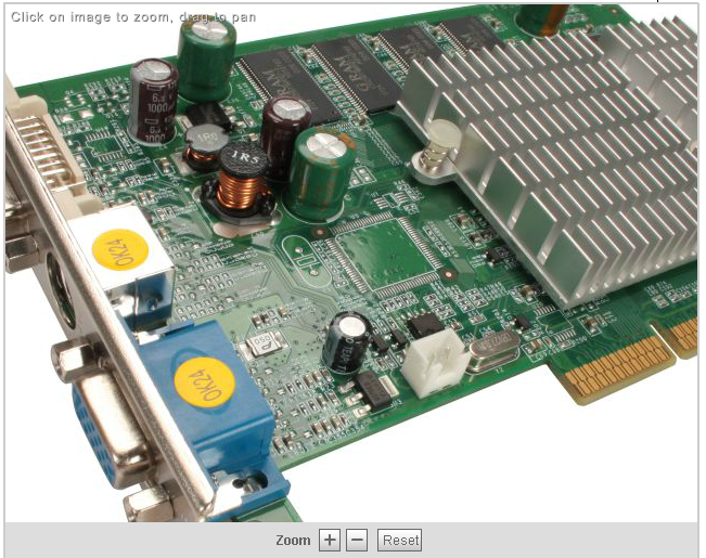

    My company is replacing dozens of video cards made by GeForce FX5200, due to bad caps. Now we've selected a SPARKLE SF8834DT256MB (alternate eVGA 128-A8-N306-LX) to replace the GeForce.
    Does anyone know whether these particular manufacturers have a clean record with regard to bad caps? Or did we jump out of the frying pan into the fire?

    Geforce 5200FX is a model of GPU chip by nVidia. Decent chance somebody else made the card... the chip companies stopped making entire cards around the time of the 5200fx IIRC.
    Anything older by eVGA (pre-poly caps) is probably riddled with Sacon FZ firecrackers. They recap well but w/o a recap are junk. Not sure about sparkle...

          Nobody has a clean record. I see low end server boards going out with UCC KZG and KZJ. I know where those will be in 3 years.
          Capacitors change from run to run. They can pick from 3 categories: bad caps from bad brands, bad caps from good brands, and good caps from good brands. The only real way to tell if you've gotten the shaft is to compare some brands and type codes to the bad and good lists.

                    I think EVGA now uses only good caps (after going through Sacon FZ and Sam Young but now mostly FP with a few conventional 100uF CapXons), and I believe PNY and 3Dfuzion have long used only good brands. My PNY FX5200 card with puny heatsink and Sanyo WX caps has outlasted two EVGA FX5200 cards.
