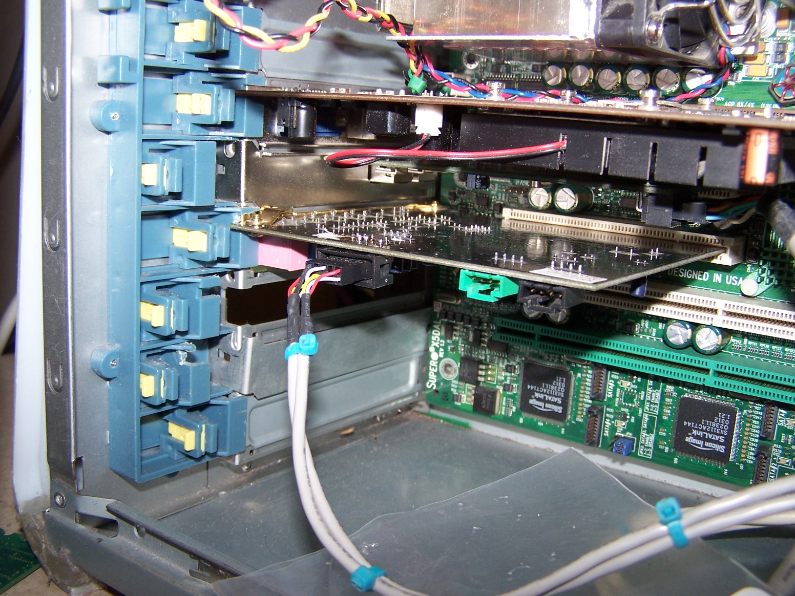

                    Due to the new RAID card, I now have a clearance issue with the front audio header.
                    Solution:
                    I ended up having to cannibalize another Firewire card for the connector. Not optimal, but the card I stole from had a smashed up bracket anyway. In addition, since the key pin is on the opposite side of the pin block, I had to omit a pin. I ended up omitting the pin opposite the key, which is a 5V supply pin not used by my case.
                    The soldering didn't go too well either... thanks the the piss poor PCB of the sound card, it didn't like the removal of the old pin block too well. Luckily, after some careful rework, I got it in... and after testing with a live DVD, I can say the new connector is functional.
                    Why the bastards at chaintech didn't use a right angle plug in the first place is beyond me; they used right angle plugs for the CD in and Aux headers...
                    If I have issues down the road, I may end up having to go to an ASUS sound card, since those are the only other cards with AC97 headers that I know of.
                                Solution:
                                After further review of the 3ware 9500 Manual, I didn't actually need to mod the sound card. The 3ware card only will run at 66MHz, so it wouldn't have mattered whether I used the upper 100MHz slot or the lower 66MHz slot. All I would have needed to do was move the card to the lower slot.
                                In the mean time... I bidded on an ASUS Xonar DG card... Knowing my luck I'll get sniped on it... but given the uncertian linux compatibility, I didn't feel like risking a lot.

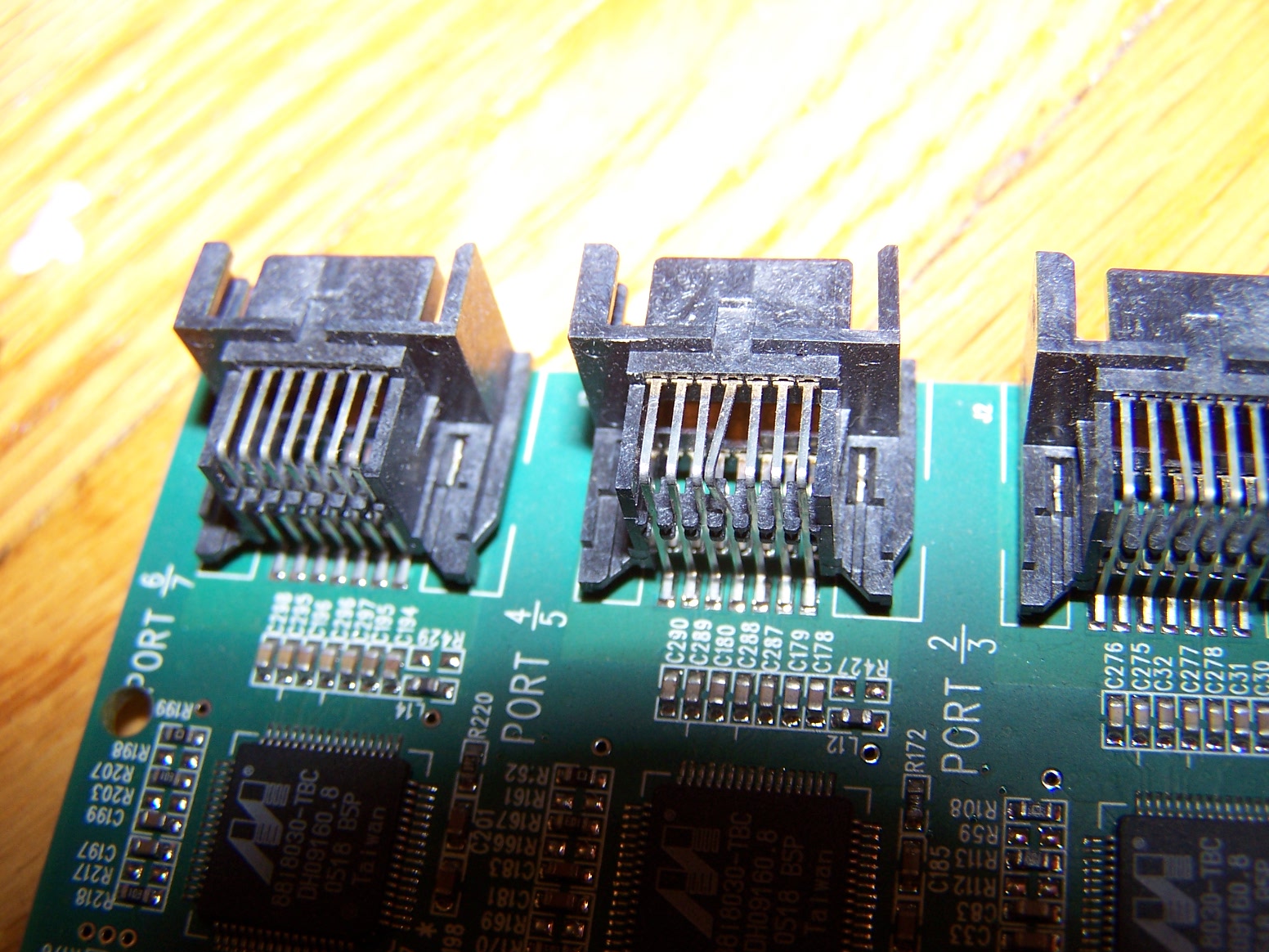

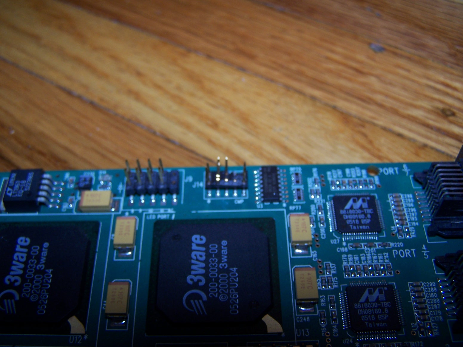

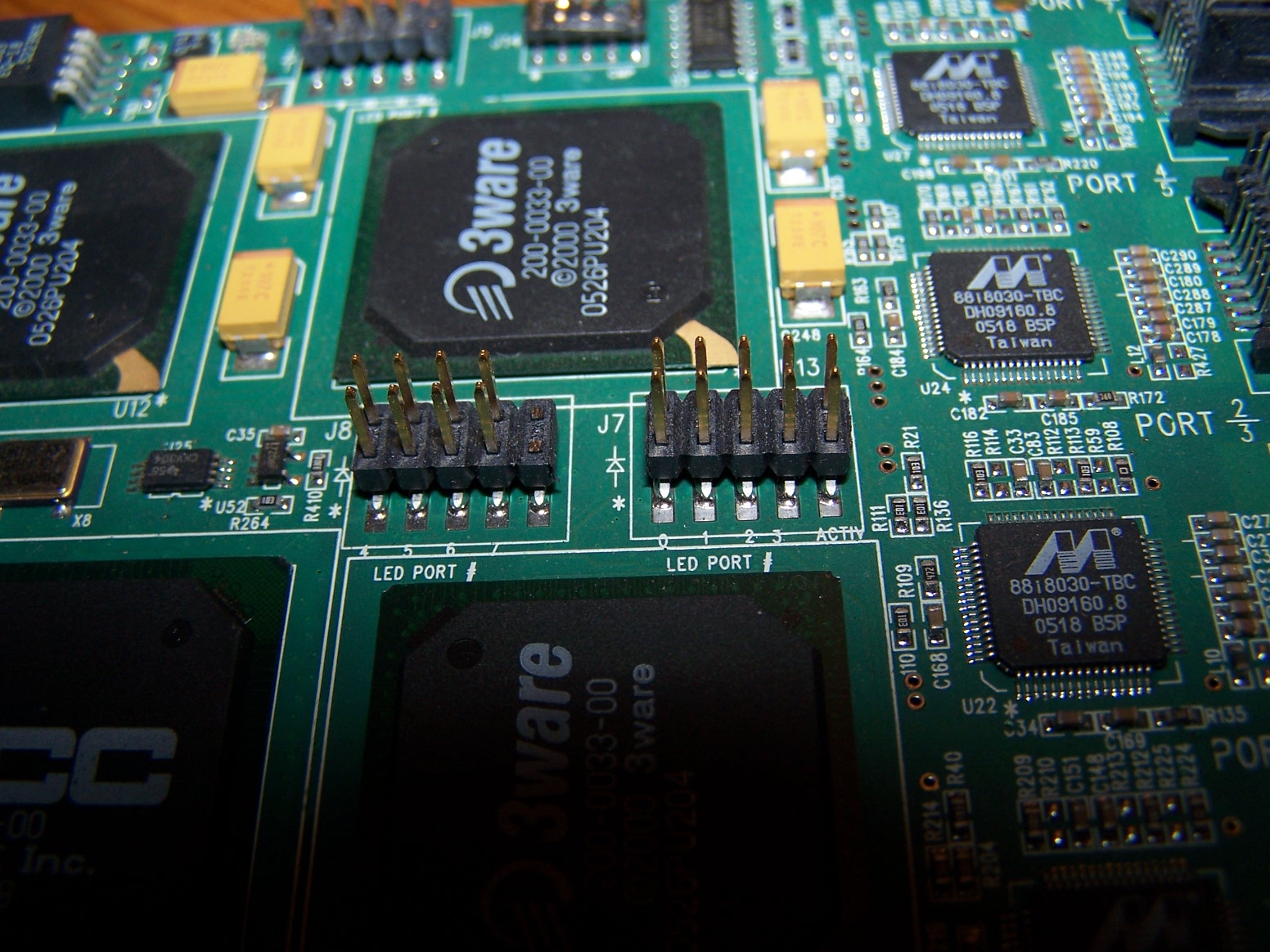

                                    The card came in... and It appears to have had the crap kicked out of it:
                                    (BBU removed)
                                    At least one of the 3 main activity LEDs is intact. I wish th upper one was intact but, it ain't
                                    Also, I'm dubious of the RAM module:
                                    Supposedly it's an 128mb like the one from the old card... just to be safe, I swapped the modules.
                                    Somehow the dumbass got the Card bracket on wrong... so when I went to install it, it didn't line up. How one could do that and not notice is beyond me.
                                    I haven't had a chance to test since my keyboard is on the rag (shouldn't have cleaned it, now it complains about a stuck key) and I had to grab lunch and head back to class.
                                    sigpic
                                    (Insert witty quote here)
                                      Re: Ratdude's Main rig V2
                                      Ouch. I hate it when sellers don't treat the stuff they are selling well. I suggest you inspect all SMD components on the board carefully. Hopefully, none got chipped.
                                        I looked hard... and no other damage other than the pins (the board is 100% SMD, even the pin headers).
