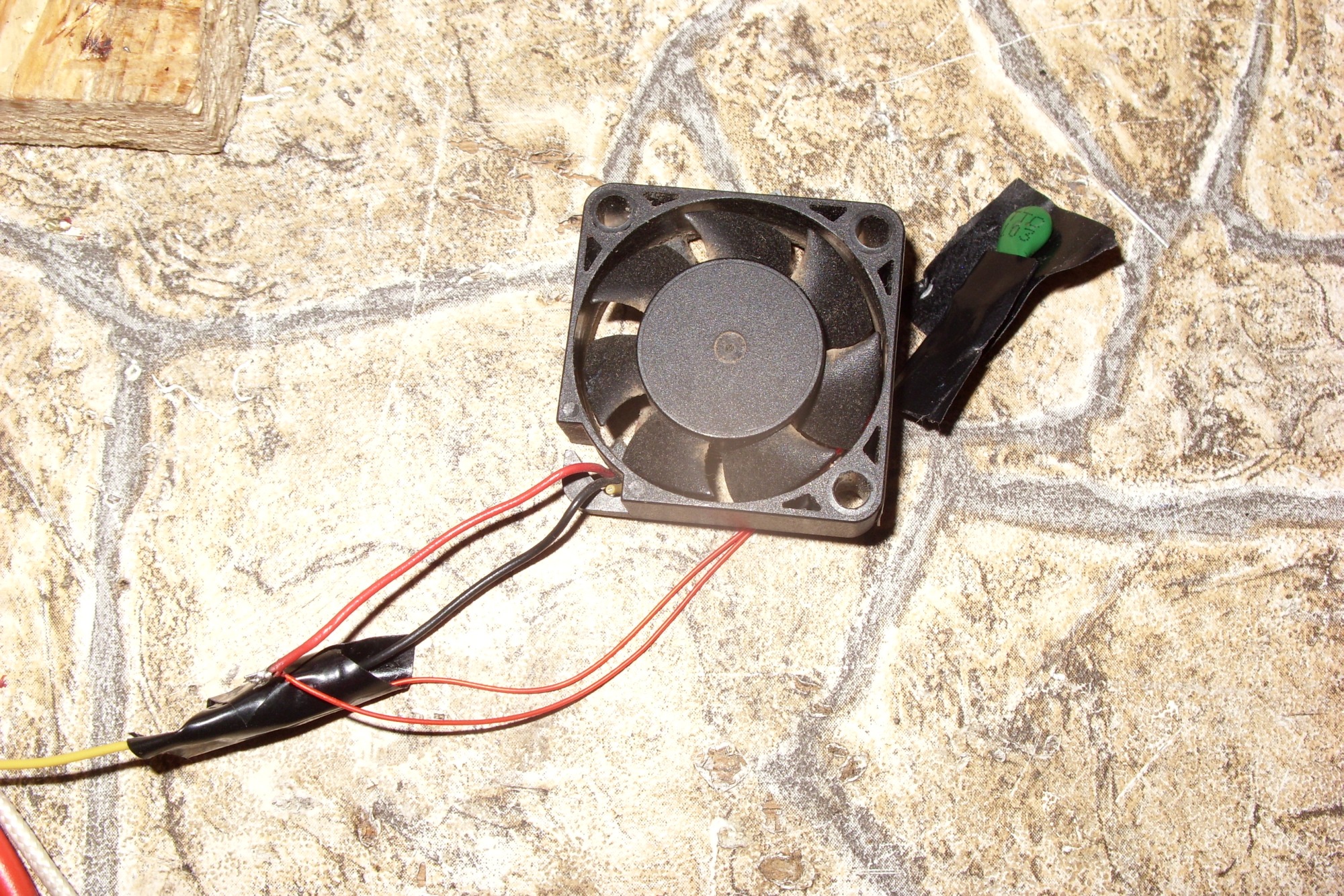

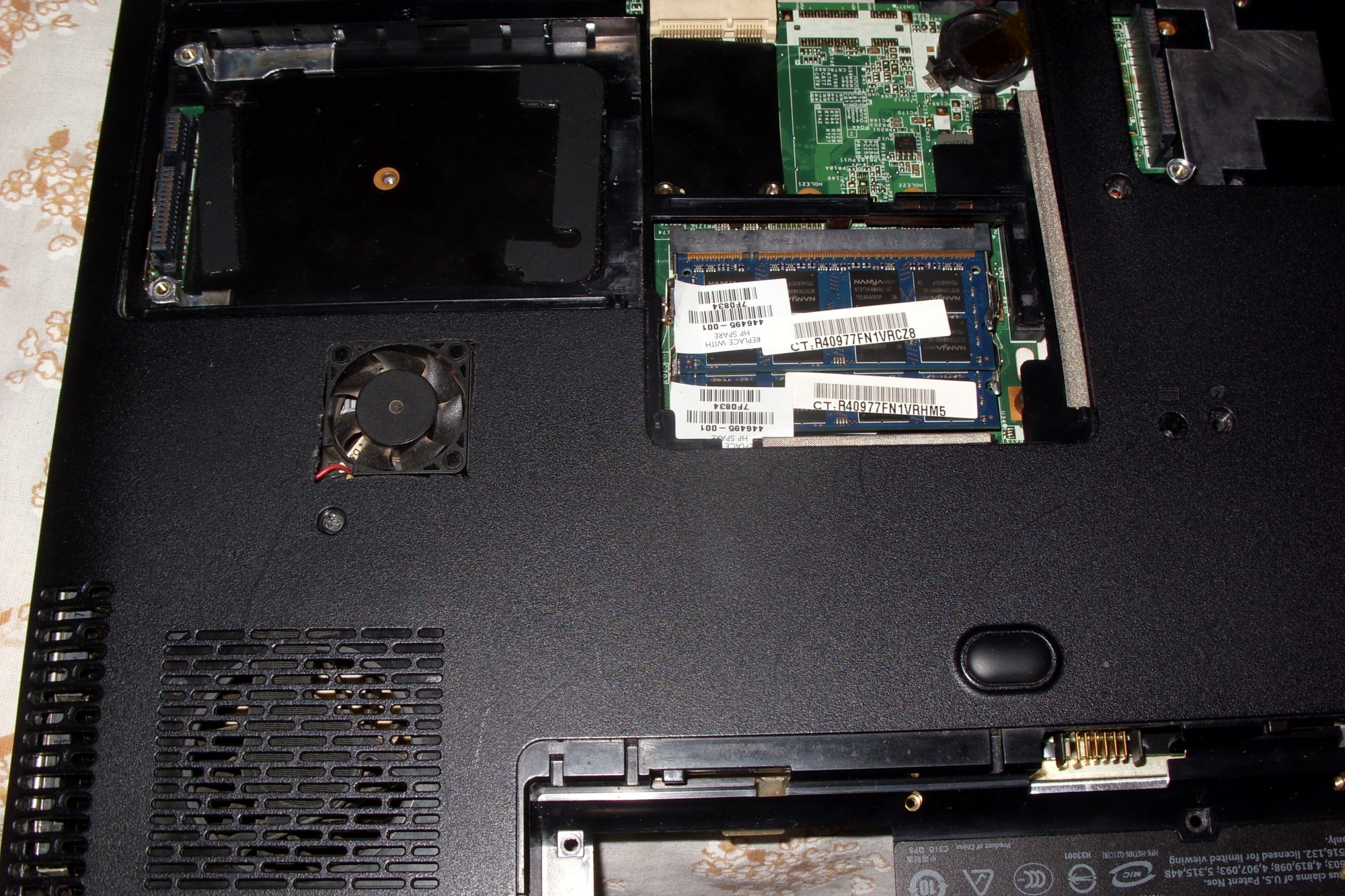

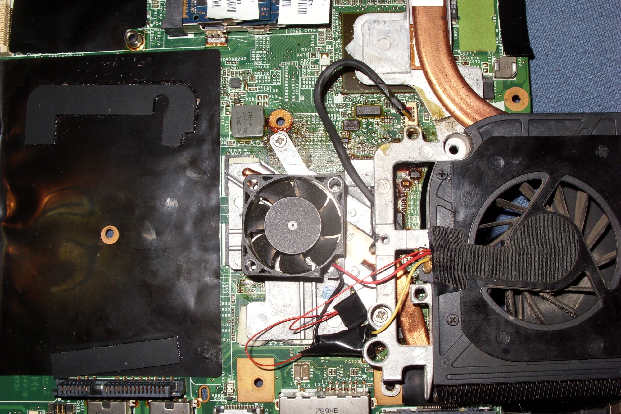

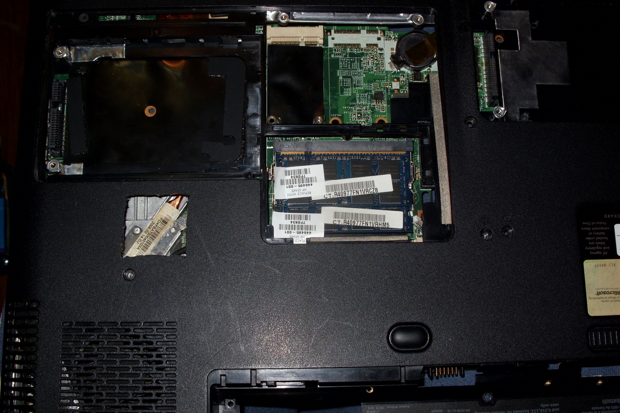

                  Re: Reballing does NOT mean it'll last long!
                  And... here we go again. I was watching a HD video and bang. And this time i can rightfully blame the guy who reballed it as it was the GPU which failed. But nothing can stop a man with a heat gun.
                  And i thought a little case mod would be in order as well. A little extra fannage. I made it temperature controlled too, so i don't have to put up with that wheeeeee all the time. It starts making its presence felt at 50C, and reaches maximum speed at 60ish. It does whine quite a bit, but it moves some serious air for its size. I have a couple larger ones of the same height, but they are both 12v fans so they'd spin rather slowly at 5v and not do much. I haven't checked the mobo for a 12v or higher source that is present on both charger and battery, maybe i will, and fit one of the larger fans if i find one.
                  While i was at it, i also added a little something for the RAM chip on the top side that used to be in free air (i had already arranged for its neighbor to get some heatsinking from the top cover when i reflowed it). It isn't a lot, but it's better than nothing.
                  And yes, i do have to make some sort of grill for that fan, but that's for tomorrow.
                  PS. A big Fuhjyyu () goes to HP, Quanta and a certain dude who does "professional reballs". I'll never trust a computer service in my country ever again.

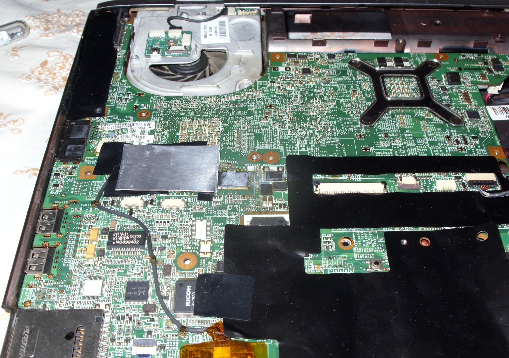

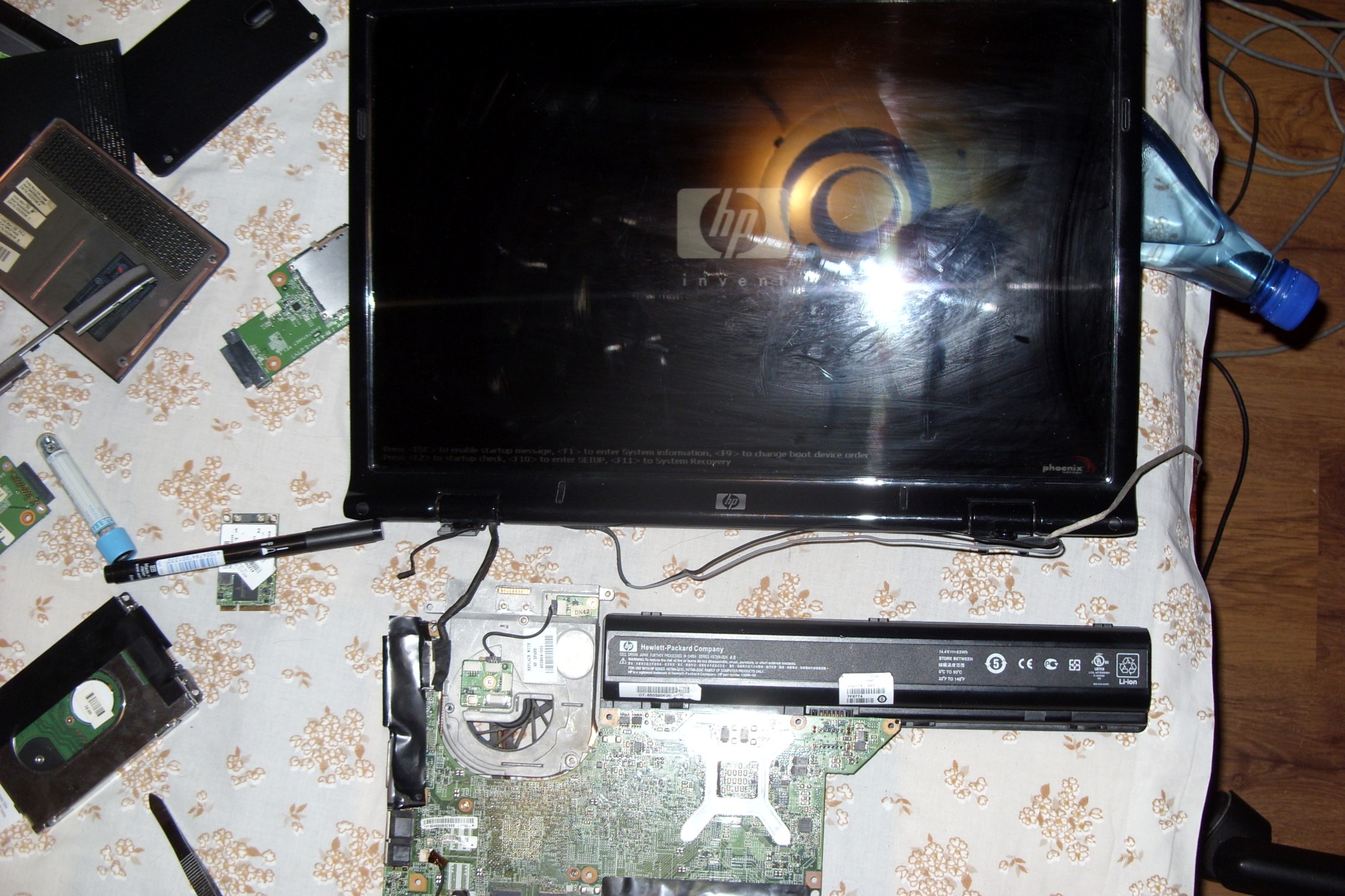

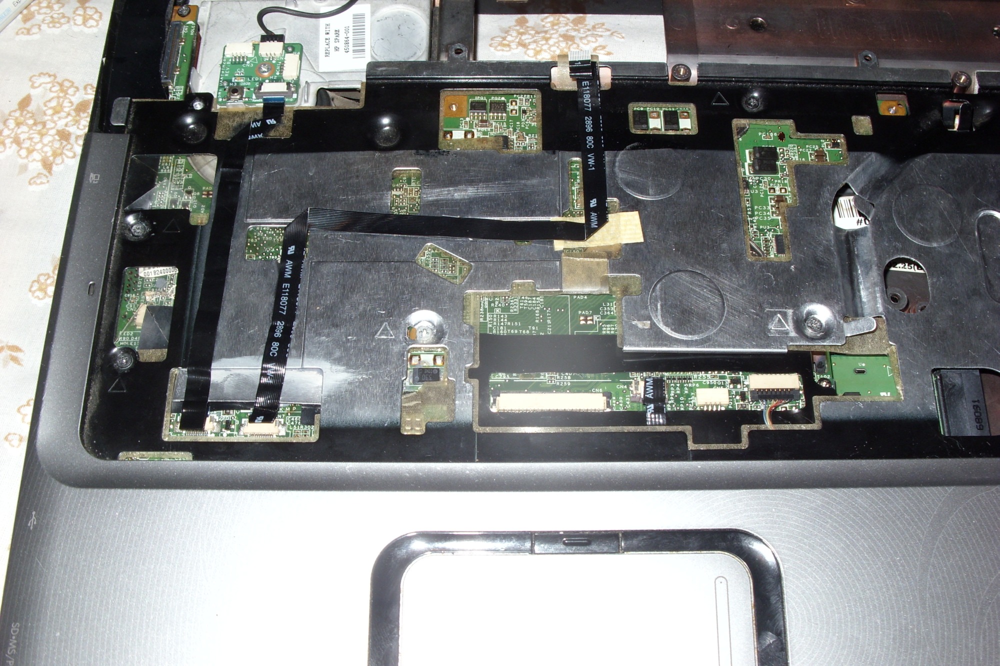

                            Doesn't really fit in the reballing topic but it's still about the same laptop, so here goes.
                            I got tired of the dust inside the screen and opened up the panel to clean it. I got rid of the dust alright, but i managed to leave some smudges on one of the polarizers... crap. Also the left hinge is completely gone now.
                            So i called this guy which i knew had some parts for sale, and sure nuff, he still had the panel, and a 2.3GHz CPU. Unfortunately the CPU didn't work as it was a newer generation, it was a RM while mine is a TL (board didn't even POST), but i ended up dropping $90 on the following:
                            1x Clean, ass-spankin' LG panel. The backlight is more even than my AUO one, it's a bit harsh but the colors need to be redone anyway. The AUO had a yellowish backlight, this one is cool white. Vertical viewing angles are slightly worse, horizontals are better. But hey, it's CLEAN.
                            1x Battery, sensors dodgy but so far it appears it will charge fully. This guy was nice enough to wait until the battery charged to 44000mWh (50% capacity, my battery has 50% wear and won't charge more than that), and it reported exactly 50% at that charge, so it looks like it'll hold full capacity.
                            1x Matsushita DVD-RW with lightscribe, made in 2008. Pulled off some Lenovo.
                            And 1x 128MB SDRAM for my DOS gaming laptop as a bonus.
                            All in all, i think it was worth it. Now all i need is a new set of hinges and i'll be set until the end of the world in December.

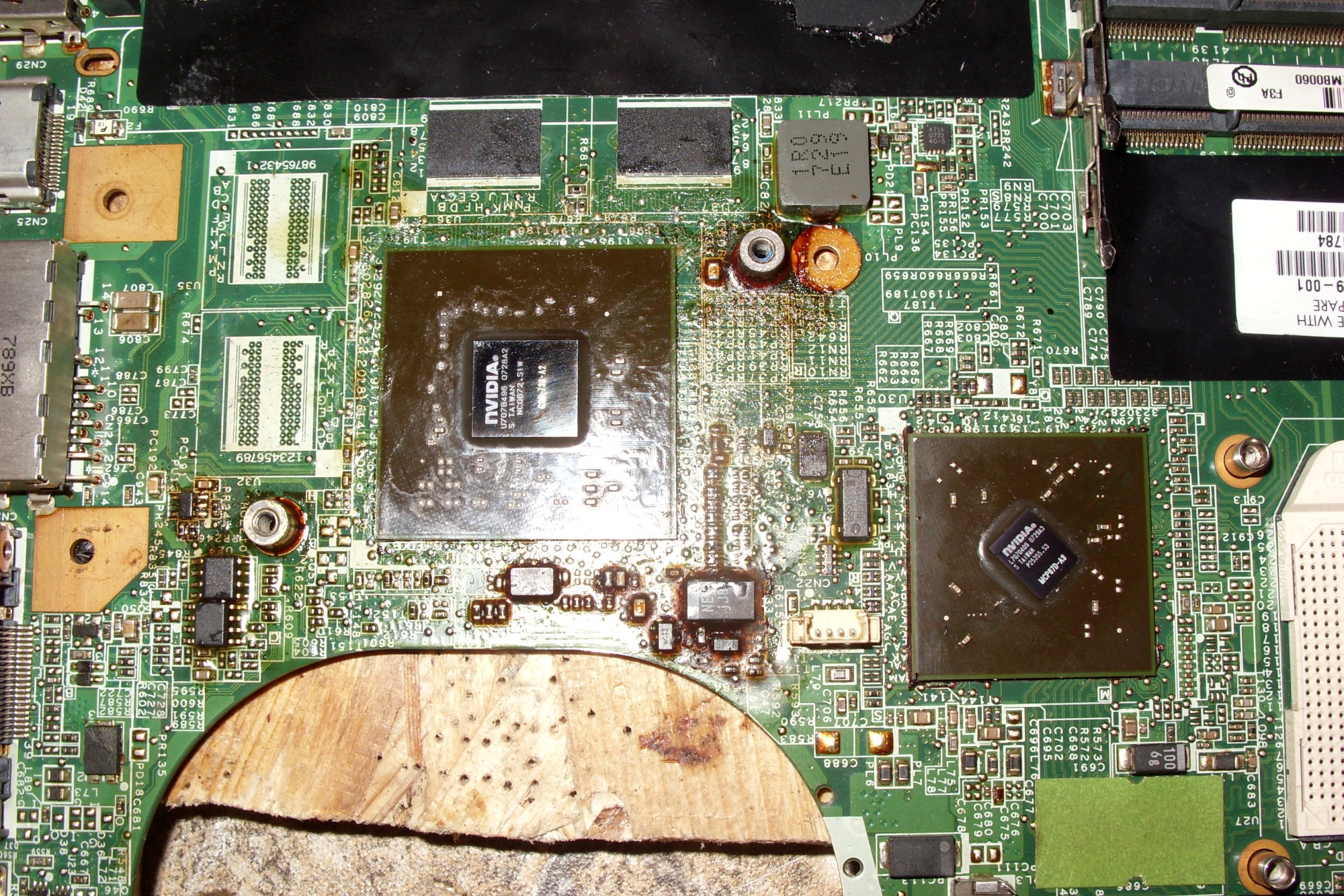

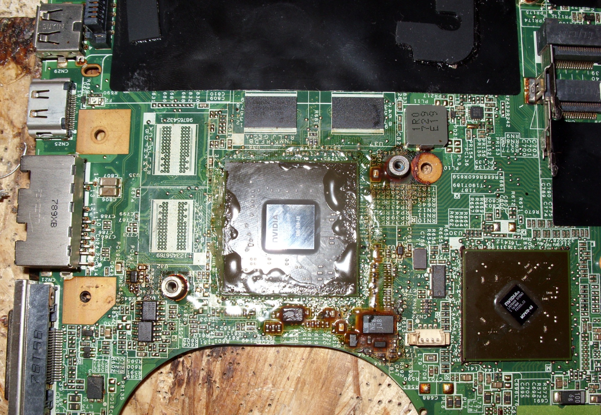

                              Well, today i had to hit it again. Just under 4 months... Ah well. Sometime this month, the wired network card went out, just like it happened last year with the other mainboard. If only i knew... i woulda kept that one.
                              I used momaka's reflow method this time, putting flux on the sides of the chip then preheating the board from the bottom so the flux goes in by itself, and only then heating it from the top. It worked surprisingly well - the chip ate a lot more flux than i thought. I also reflowed the northbridge but still no go on the wired network - so it's not the NB, and not the realtek PHY (replaced that on my old board, no dice)... i have no idea why the network failed but apparently it can't be fixed. I guess i'll buy a cheap USB ethernet card and be done with it.
                                  Just be careful not to put too much flux - very easy to do with this method. Not that it would do anything bad but you'll waste a lot of flux because the chip will keep eating it until it saturates all of the empty space under itself. I don't know exactly what causes the flux to get drawn under the hot chip, but it works. Still magic to me.
                                  It's unfortunate that the reflow didn't work, though. Maybe re-ball time? Although I find that if a proper reflow doesn't work, then a re-ball rarely does either.
                                    Isn't that the idea... to prevent tin whiskers (if it's ROHS), reduce oxidation (in case that was why the original soldering didn't take hold), increase the ahesion of the solder, and to prevent solder bridges?
