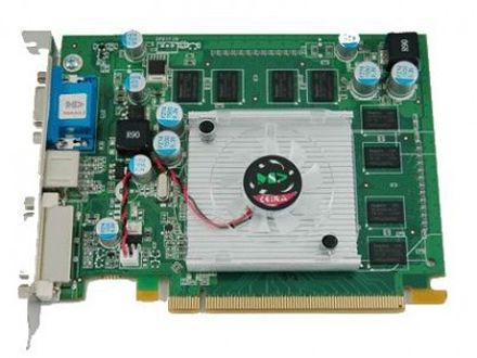

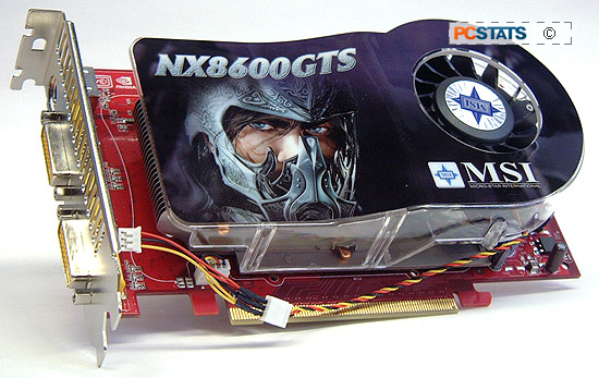

      I've seen my fair share of (semi-)dead desktop Geforce 8400-8600 cards aswell. The ones with the tiny cheap coolers or the entirely passive cooled cards die first, while the ones with a proper sized cooler are usually still going.
      My stepdad for example has a MSI Geforce 8600GTS with a rather big (2 slot) heatpipe cooler that pushes the hot air out of the case. Still no signs of failure or glitchy-ness. The generic (Manli ?!) 8500GT I had as a test card on the other hand died with pixel-salad on the screen after less than 2 years. It had a ridiculous little active cooler and always ran pretty hot (around 60°C in idle)
      Last time I tried to use it the computer acted as if there was a graphics card (didn't beep), but the card didn't display anything anymore
      edit: added pics. Yes.. the Manli 8500GT came with the lovely Sacon FZ pest.. That wasn't why it died though as I had replaced those.

          The Manli 8500GT had random symbols (in the BIOS) and colored pixels (in windows) appear out of nowhere, but was otherwise stable.
          Got worse over time till you couldn't really tell what the hell you were looking at. Kept crashing in that state too. Later on it just didn't display anything (monitor not coming out of standby)
