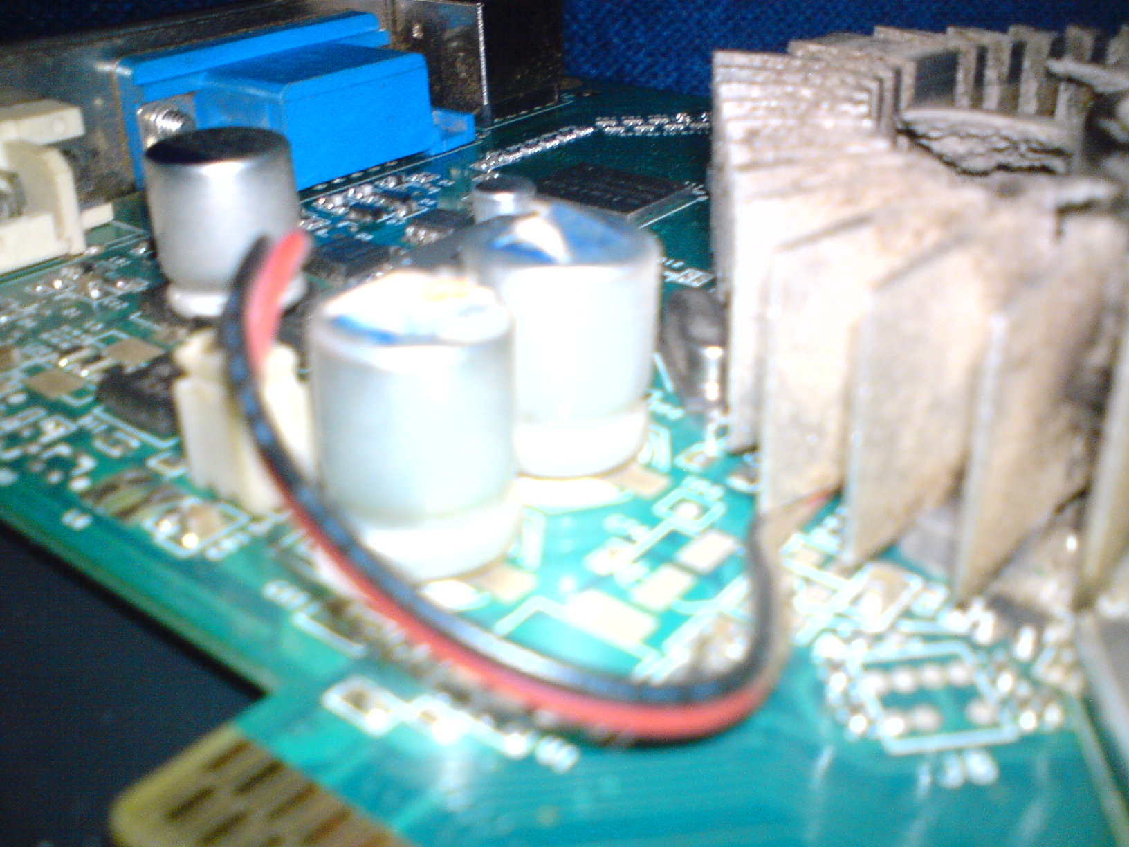

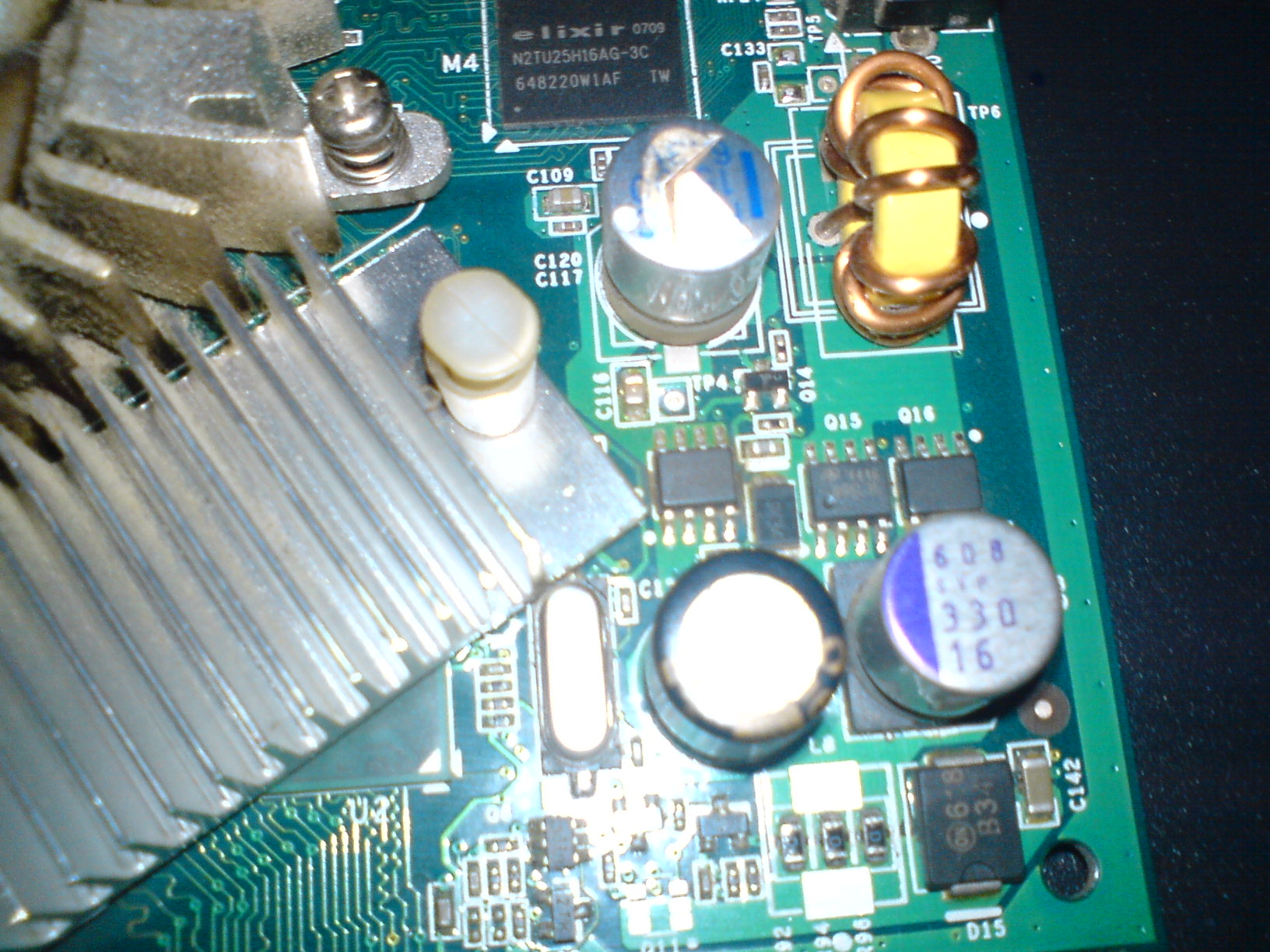

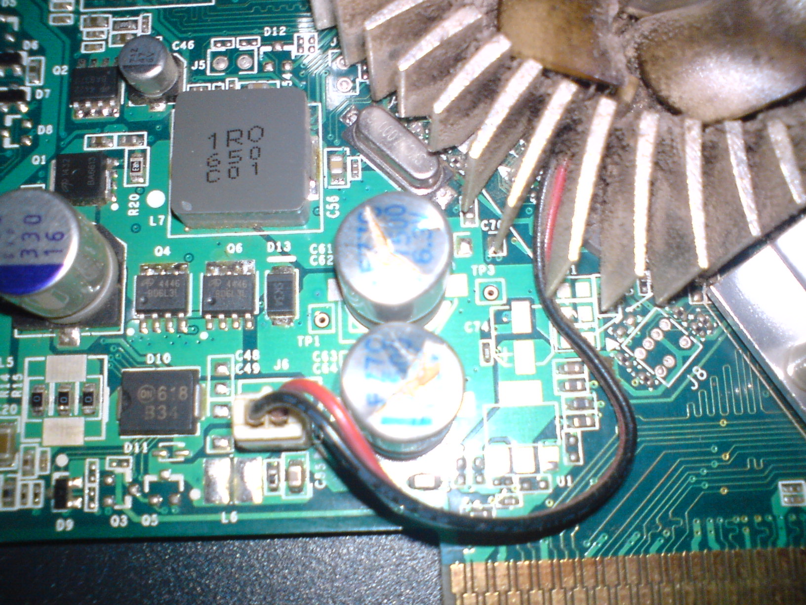

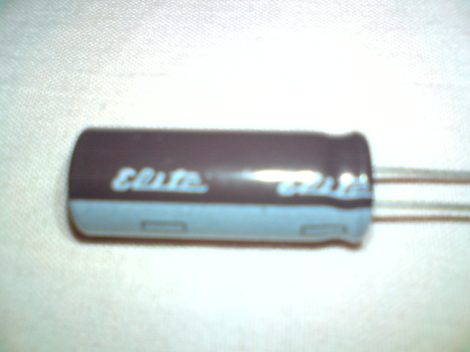

So I got this GPU with three blown Sacon FZ caps 1500uf 6.3v and I thought I'd post it here. I'm still having trouble finding replacement caps of the same specs and most probably they will be some cheapo low quality caps because I can't find find any good quality parts in my shithole of a country and paypal is not approved so no way ordering them from badcaps. Anyway even bad quality caps should hold for a while or maybe not??? Here are some pics from the GPU. I think the manufacturer is Inno3D but I'm not sure, there are no markings on the board itself. Sorry for the low light and bad quality pics. I'm not sure if the recap will work because according to the owner of the card the card worked for a few hours after the caps blew (he heard popping sounds coming from th case) and then the pc shut down completely. Since then the monitor would not display anything. Tell me what you think.

The manufacturer of the card doesn't really matter - cheaper video cards are using the original design made by nVidia.
I'd say it's worth trying to fix it - the video card was probably running until the capacitors broke for good by causing shorts or disabling the video card's "power system".

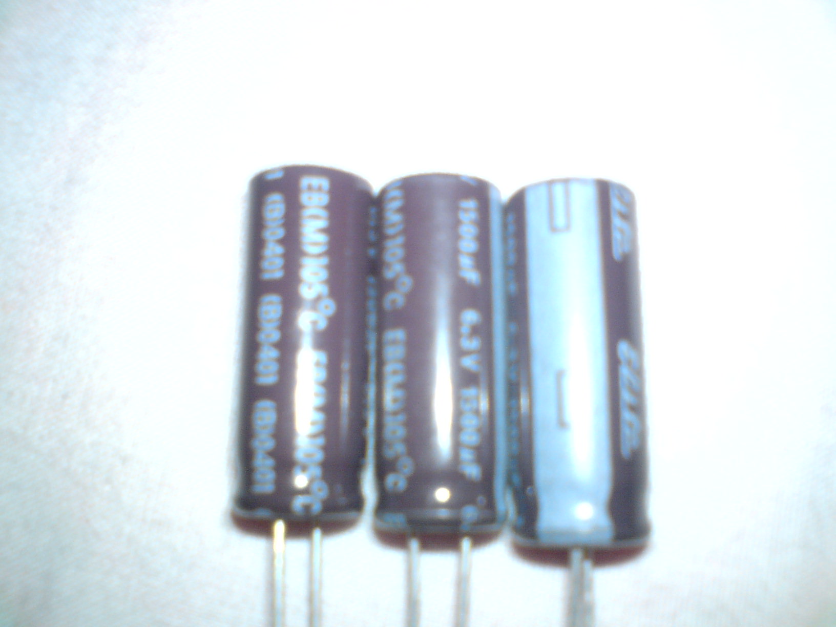

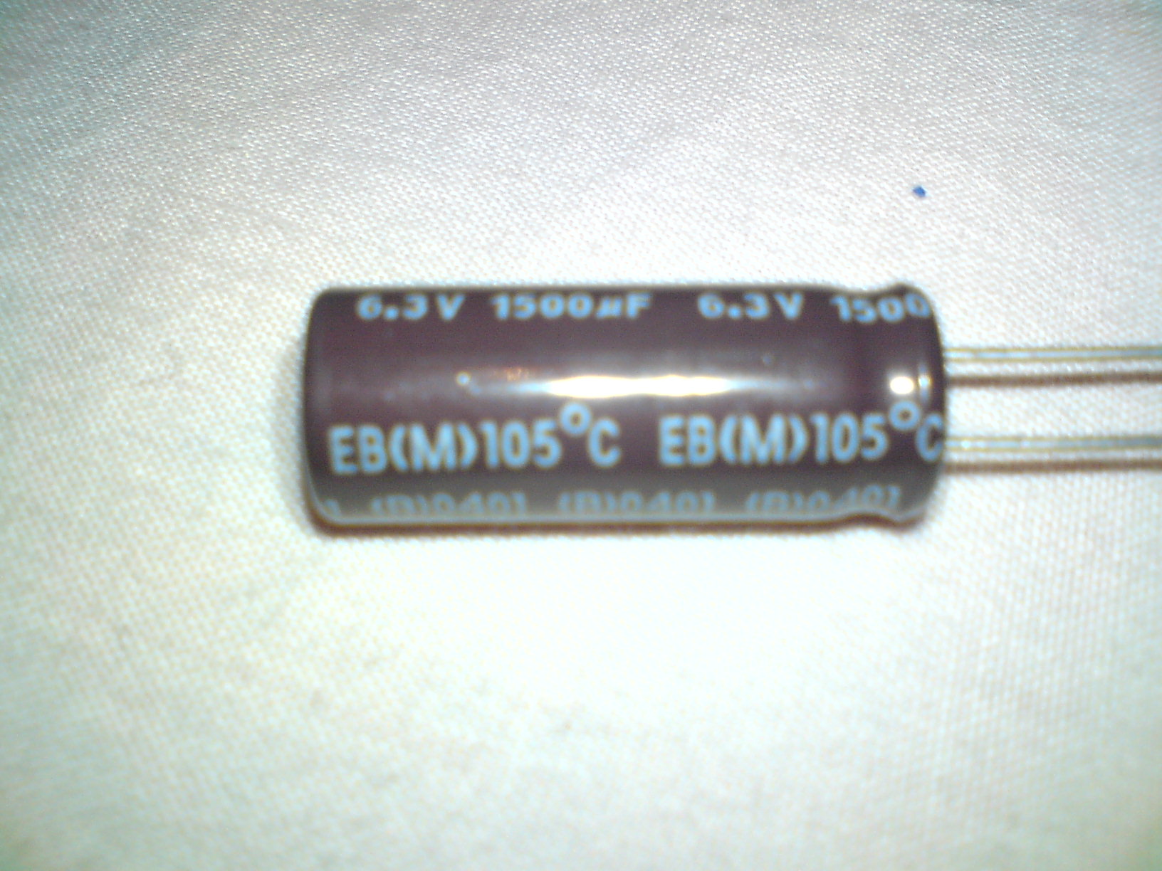

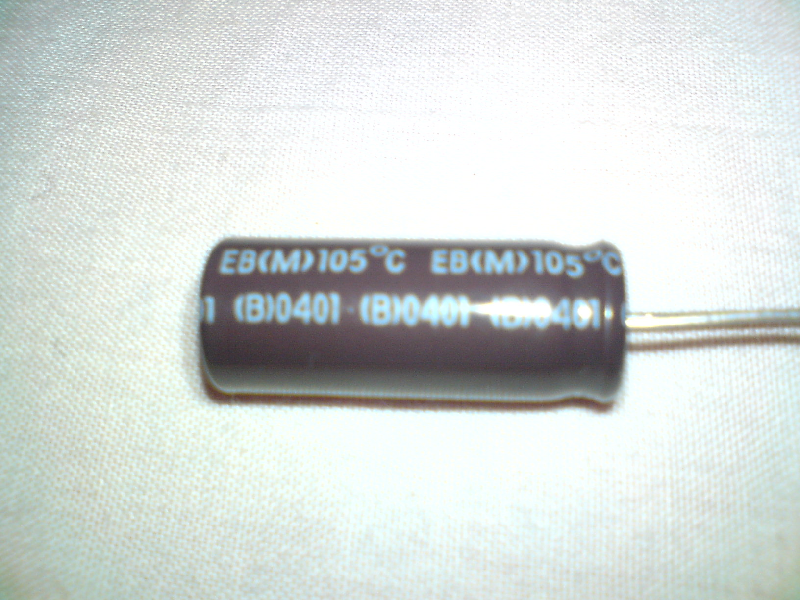

Well Rubycon or Panasonic caps are not an option for me because there arent any in my country. The only and I really mean the only brand of capacitors I could find are Elite capacitors. I have already used them on 2 previous GPU recap jobs and so far they are doing ok but I don't know how long they will last.
Here is the spec sheet
http://chinsan.co.th/files/EB.pdf
I'm willing to use them again since I've used them before and they gave me no grief so far.
Here are some pics (again sorry about the quality)
I'm recapping the GPU tomorrow and I'll post some pics. Sure some of you guys will go crazy seeing some shitty caps going on the card but you gotta understand this is my only choice at the moment.

Spec-wise, those Elite EB are (more or less) equivalent to Panasonic FM, so they should be alright.Comment
Re: nVidia 7300GT AGP recap job
Elite have horrible reliability so keep an eye on them.

Ok so I recapped the card and it ran perfectly afterwards. Those elite caps seem to be doing an ok job. They were slightly warm to the touch while the card was working and 12 hours of intense GPU benchmarking did not reveal any problems. I will post some pics later on if I find the time.Guns don't solve problems. I'll take 12

In my experience, Elite aren't that bad actually - almost as reliable as Teapo, actually. Just keep them well-cooled and they will most likely be okay for quite a while. With that said, I wouldn't put them in a hot LCD monitor.
Funny, though, because my 17" Dell E173FPb is on its 5th year (or maybe 6th, I'm not sure) and is still going strong. I opened it a few months ago for cleaning, and none of the caps seemed bad (at least not visualy). All of them are Elite.
Also, I recently just fixed a 17" Dell E177FPb with a bad t-con board. That one had Elite EB caps as well and none seemed bad (and mind you, I got that monitor from a corporate place where it was working about 8 hours a day).

Well I have also seen some LCD monitors using elite caps and they are working 4+ years without blown caps. Yes they aren't of the best quality but a replaced cap by my math should at least hold for another year. Anyway by then I will be getting more quality caps. The owner of the card knows the risk of using low quality caps on the card but its either that or throw the card away. What qould any of you do in the given situation? And btw three caps on a graphics card aren't that much of a hassle...Last edited by Koda; 09-17-2011, 02:21 PM.Guns don't solve problems. I'll take 12

Working card is better than nothing. Just one thing what i have noticed. This card fan and heatsink are very very dusty. Don't forget to clean it well. There is bad cooling of the chip and it heats up more area arround it when there is so many dust. It is also heating up your capacitors. As you should know hot capacitors dies faster.Ok so I recapped the card and it ran perfectly afterwards. Those elite caps seem to be doing an ok job. They were slightly warm to the touch while the card was working and 12 hours of intense GPU benchmarking did not reveal any problems. I will post some pics later on if I find the time.Comment
I already cleaned it and reapplied thermal paste. The card is well below 50*C under load now. The caps are only slightly warm to the touch so I think all is ok.Working card is better than nothing. Just one thing what i have noticed. This card fan and heatsink are very very dusty. Don't forget to clean it well. There is bad cooling of the chip and it heats up more area arround it when there is so many dust. It is also heating up your capacitors. As you should know hot capacitors dies faster.Guns don't solve problems. I'll take 12
