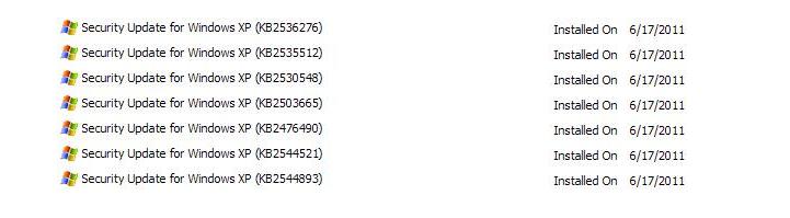

    After an automatic update on one of my XP machines today, I can no longer connect to my NAS. I still have internet access, and can ping the server, but when trying to map the drive, it says "The specified server cannot perform the requested operation". If I click on a drive that was already mapped, it says "The connection has not been restored". Anybody else run into this yet? Apparently it's been happening on my Sister's computer too.

    What updates have you installed?
    Is your sister's PC trying to connect to the same NAS? Have you rebooted the NAS?

        The NAS is on a static IP. My Windows 7 machines are working fine still.
        Here are the updates that installed today:
        One thing I just found out, is that iTunes can still access the shared library on my Win7 machine, so I know it's just limited to mapping a drive.

              Fixed it:
              http://www.networksteve.com/forum/to...=22232&Posts=0
              My NAS is Linux based, so that was it :-)
