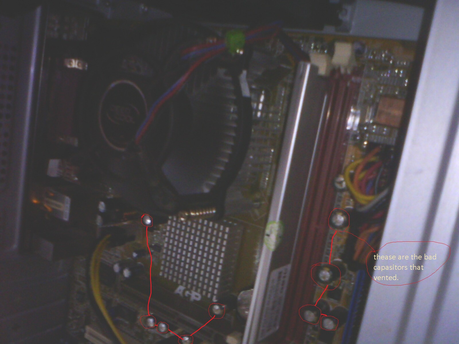

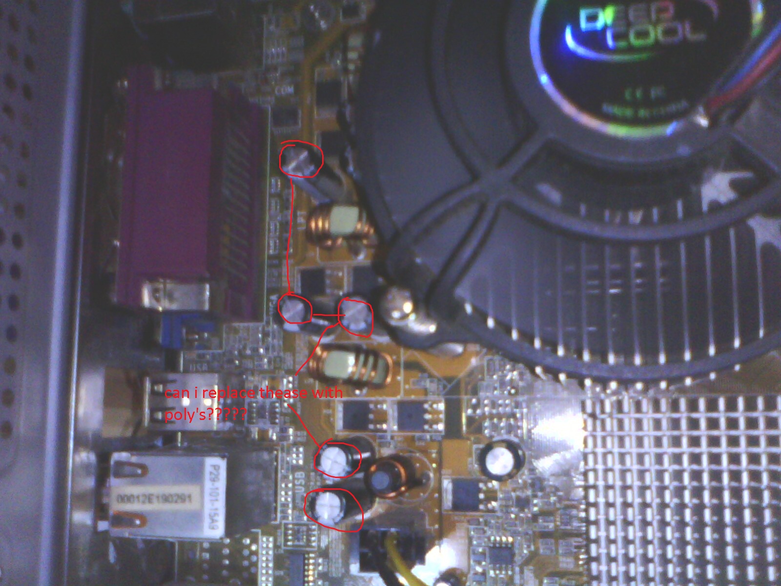

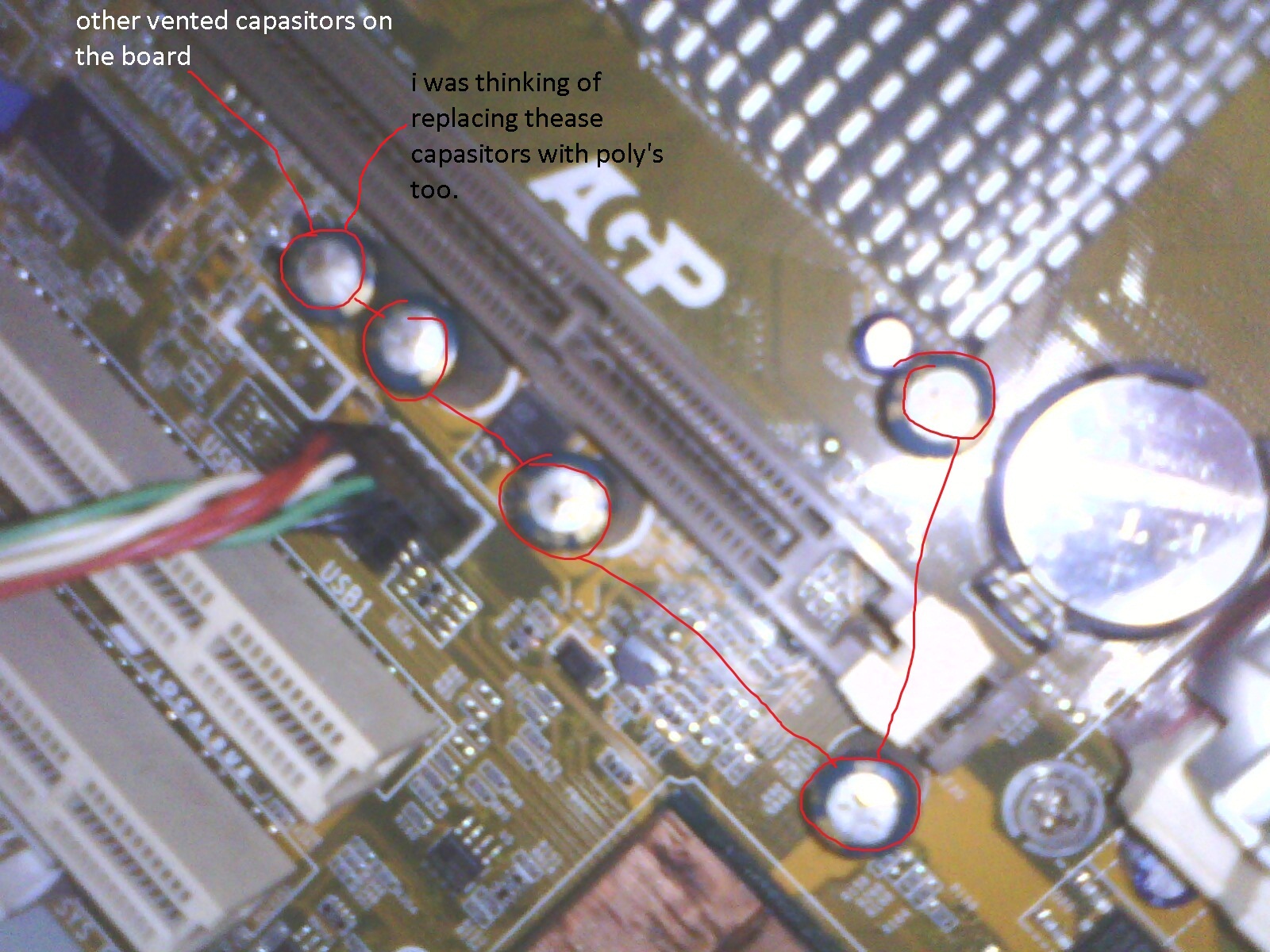

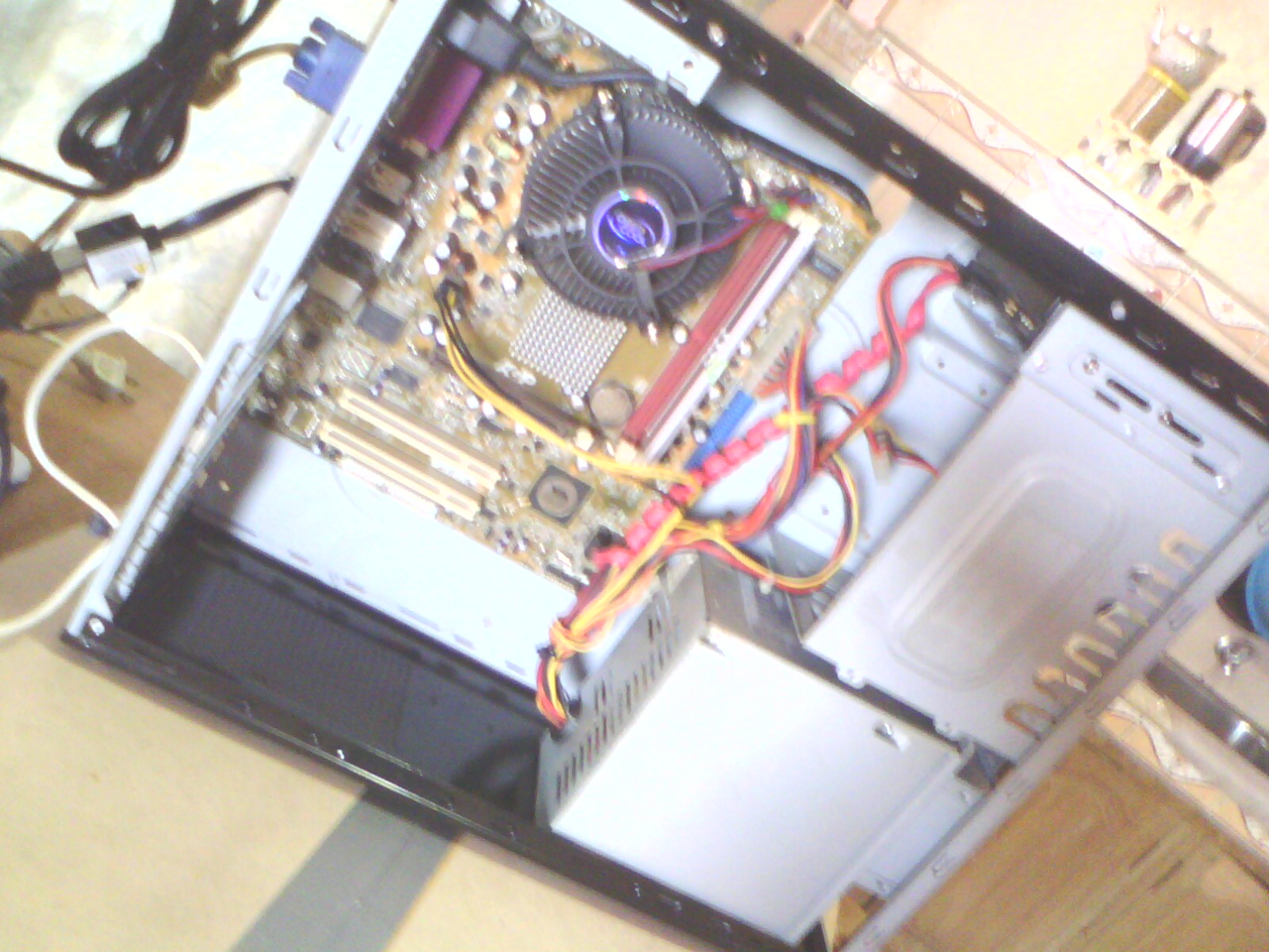

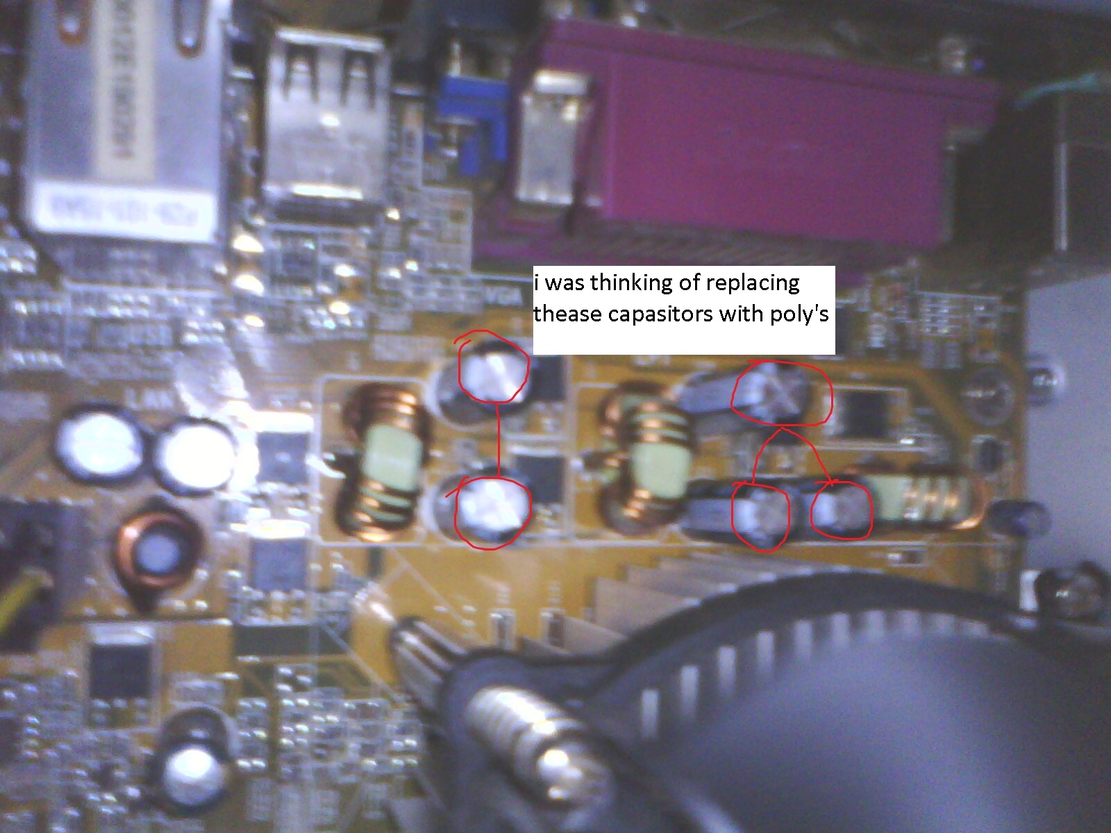

    hello everybody. i just discovered this site and did alot of reading.
    my pc was fine when i was using my old 256mb ddr2 ram but since this is too small for windows 7 i upgraded it to a 2gb pc 6400 geli memory module. only 1gb is detected by the motherboard. i guess this motherboard dosent recognize dual channel ddr2 so anyway. at the time of the upgrade my pc was running much much faster. so then i was pleased. but after 3 to 4 months of operation things started to get real bad. slowdowns,lockup's the mouse just freezes ect ect. up to this point that im real desperate in fixing it. because i literally cant use it. for anything!
    i found out my motherboard has (12) 6.3v 1000uf teapo capacitors bulging and some residue on each of the vent. on the ram side. while on the CPU side there are a couple of capasitors rated 16V i was thinking of fully poly modding this board. please would somebody help me/give me advice?
    http://valid.canardpc.com/show_oc.php?id=1839332
    thank you in advance and more power.

    The board is old enough to not be worth a poly mod. Heck, it doesn't even see a 2GB memory module. Try 2 1GB ones.
