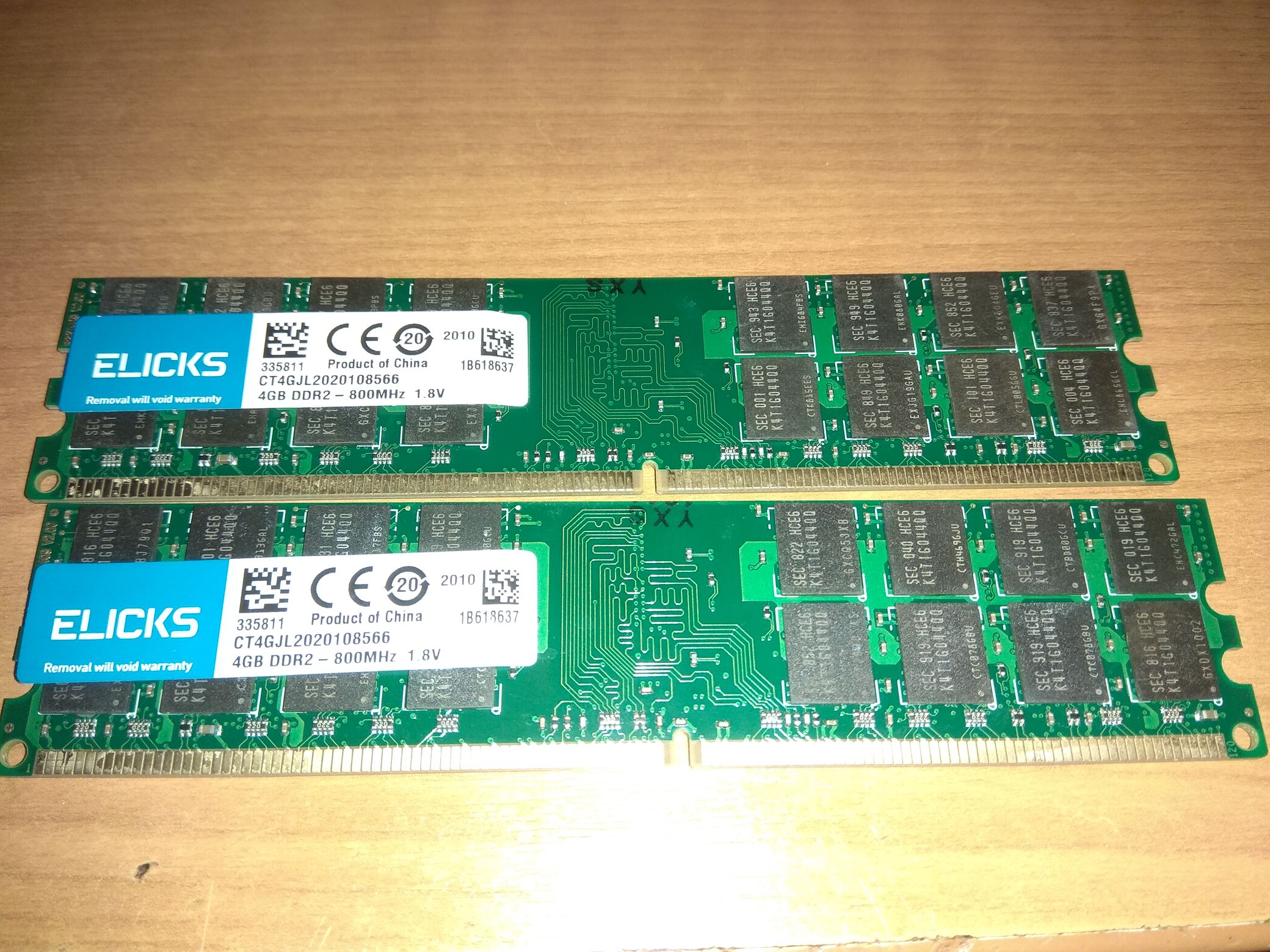

    "amd" ddr2...
    So what's with the "AMD" DDR2?
    My (Intel) board "officially" supports 4G DDR2's (four slots, 16G total) but this "AMD" deal is kind of scary recalling back to the old SDRAM deal. In fact I have a few 512M SDRAM modules now but they don't work in my 440BX board, which is too bad, would rather run this board with 2GB RAM through its four slots, else have to use the VIA boards with only 3 slots is the best I can otherwise do.
    But anyway I heard these "AMD" DDR2 still "work" on an Intel board but cannot clock at PC6400 speeds if it comes labeled as such, and must underclock and run at PC5300 speeds... but is that all?
    Really should look into getting 8GB DDR3's instead of dumping more into DDR2...

        I was thinking about ripping up old modules and sticking more chips on unused double sided boards but finding equivalent chips is kind of tough.
        But the weird thing is that some of these 4G modules look legitimate... 32-chip modules, 2x8=16 on a side, samsung, hynix ?

                      DDR2 AMD only RAM is a thing because Intel had one less (column) address bit available on their memory controllers, so depending on the memory organization some sticks aren't compatible with Intel platforms.
                      The well-known RAM stick manufacturers very rarely used these chips, probably to avoid confusion with the end-user, but it seems like the sellers on Aliexpress got a hold of these (probably used) chips and are selling sticks with them cheaper than the "Intel-compatible" ones.
                      You can look for the datasheet of the RAM chips to see what the memory organization is.
                      I'm not sure about DDR3, but I remember that in the early days sticks were mainly 1.8V instead of 1.5V, and people were saying that it is an issue with (DDR3-only) Intel's Integrated Memory Controller, Intel specifications were only for 1.5V DDR3.
                      AMD AM3 CPUs still supported DDR2 that typically ran at 1.8V so it may be the reason why it wasn't seen as a problem for AMD.
                      I did confirm myself that both AMD-only DDR2 and DDR3 won't work in an Intel platform. So there may also be an issue similar to DDR2 addressing with DDR3 on Intel.

                          I have such dimms (2x4GB AMD DDR2), those dimms use different chips/arrangment/rows "256Mx4" that have issues/incombatible with the intel memory controller design. I have tested the memories on intel P35 and the board only read them as 2GB dimms. Other users said that these memories work fine on nVidia s775 chipsets. It was meant as a cheap DDR2 alternative for AM2 platform.

                              It's not an issue with the total memory capacity but an issue with the RAM chip organization. The "x4" chips transmit 4 bits at a time for a given memory address and have to use an additional column address bit to address the full memory that apparently Intel memory controllers don't support.
                              However it should not POST at all if you use this incompatible memory. (the SPD profile inside the stick should report the memory organization, and since the memory controller doesn't support it the BIOS should fail RAM initialization)
