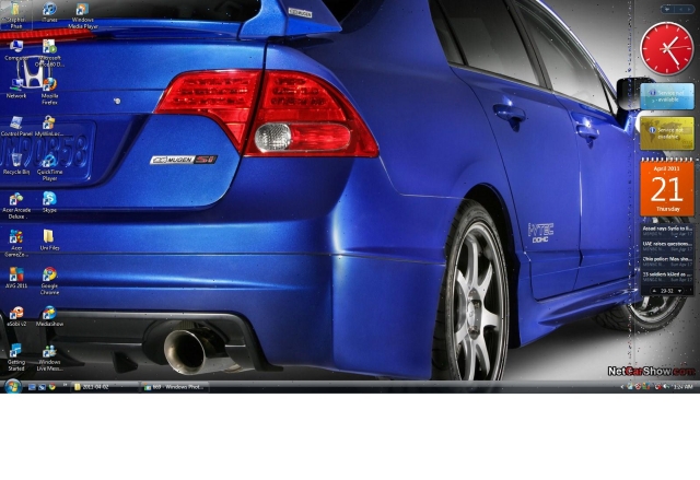

    Something's wrong with my Acer desktop...

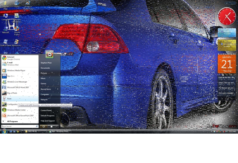

    It gets stupid dots and lines all over the screen. It comes up randomly (and changes after say I refresh the page/desktop or alike), usually happens after sifting through photos or editing photos, never happens after a youtube video or anything like that.
    I'm not sure if it's the graphics card, drivers or my RAM. But I can actually print screen all the funny lines and dots? which is weird, thus is has to be happening before the video output?
    I installed the newest nvidia drivers (replaced old drivers which always restarted and so on), but everytime I try something 3D, it crashes and restarts. Sometimes my computer will just play stupid and freeze and I have to do a cold boot.
    Really want to get this fixed, but not sure what I should do (been out of computing for a long time now unfortunately, so skills are pretty rusty). My brother suggested new graphics card? But I doubt it's my graphics card for some funny reason. The graphics card is a G210 512MB and the Acer is an M1800 using an MSI motherboard w/nvidia chipset.

    Typical nvidia failure. Reflow, reball, or new motherboard. If you're lucky enough to have a replaceable graphics card you can just replace that.

        Yes its your graphics card, assuming its a removable card since its a desktop. If it were anything else you would get other problems as well like BSOD, random reboots and stuff.
          Re: Display issue
          If the errors are in the video RAM (which seems to be the case, as if the GPU itself is bad it just hangs up or crashes the driver) you can printscreen them.

              Typical ram failure on a video card. Replace video card for diagnosis and confirmation.

                Ok, i went out and bought another GT210 today. I haven't installed it yet, but once I do, I'll tell you all how it goes.
                Don't find love, let love find you. That's why its called falling in love, because you don't force yourself to fall, you just fall. - Anonymous
                  Re: Display issue
                  Just got home from work and first thing I did was install the graphics card, so far no problems... I'm hoping it stays this way too.

                          Had a similar issue, the reflow did not work for me (did not follow Th3_uN1Qu3 instructions exact) but changed video card and all is well now.
                            Re: Display issue
                            Seems like a new graphics card did the trick for him. It sucks to see that they're still failing, regardless if it's an unrelated issue to the 8400/8600 series fiasco. nVidia has gotten a bad rep lately.
