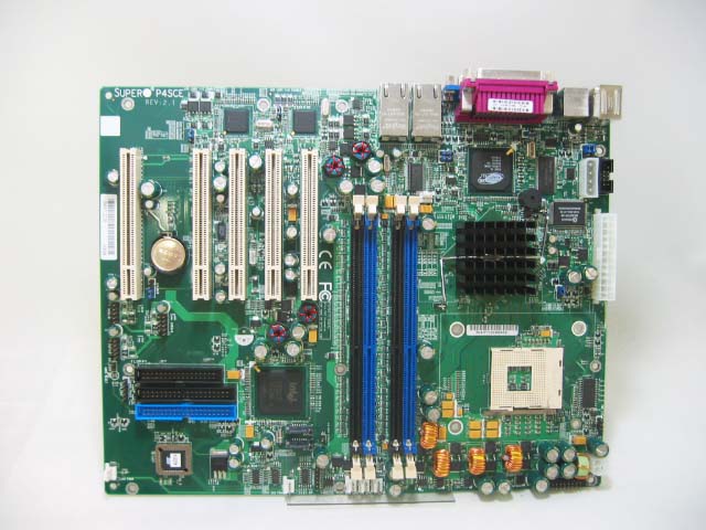

                      Arrgh! This is why you -MUST- post pictures of what you are working on. I'm chasing crapola pics across the net of this mobo.
                      The caps near the RAM slots are on a group of VRM MOSFETS. The spark and pop you heard could have been one or more of the FETs blowing. It will not work until repaired.
                      The manual and a poor web pic are attached.
                      The manual states that one of the two 4 pin connectors *MUST* be connected for CPU power.
                      Given the suspect list, I'd hang heavy bets on the PSU. There are -known- problems with these. As to what specifically happened, we may never know or find the answer.
                      These PSU's are -known- to blow the 5vsb line and it can rise to 20v or more. It is an inherently bad 5vsb design. The PSU whining sound is a sure sign of something gone -very- wrong.
                      Surmising a blown FET - If the blown FET is part of the 5vsb onboard, and the 5vsb from the PSU went nuts with high voltage, the FET would self destruct, trying to keep the onboard 5vsb regulated. The fact that you left this on for 45 minutes would have been more than enough time for the PSU 5vsb to die and go high. Not that it was "good" to begin with, mind you.
                      I know nothing about the previous PSU. Again, looking for others input... (Hello 370..?) It appears from what I found that it too was not a good quality PSU, just going by some old prices.
                      The motherboard is a different story. I seriously doubt the motherboard was the source of the problem. Those P2SCE are well made boards and use Sanyo caps. You'd have to do something seriously wrong to have it fail. That PSU will do it though.
                      Toast

                          Super Micro does not distinguish on their pages between P4SCE's. I think the Super P4SCE is a 1U server with that mobo in it. The boards certainly don't appear any different, and the manual is the same.
                          Okay on the time with power applied. It doesn't take much time for the PSU to cook. It was most likely bad already. Perhaps the P4SCE board requires a higher amperage 5vsb than the Antec or HEC could provide.
                          Regardless, until BOTH problems are fixed, nothings going to work.
