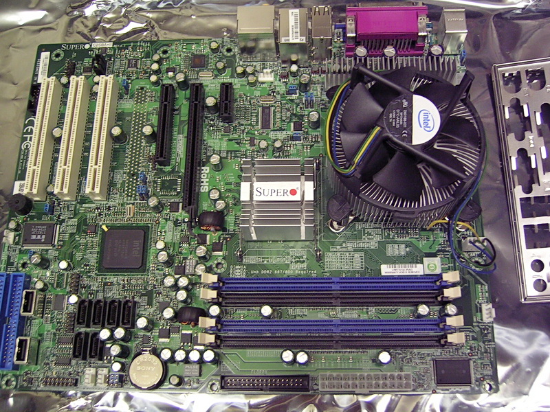

                      Are you looking for ATX or uATX?
                      I personally would probably look on eBay for a used Supermicro C2SBxxx series or an i945Gxx chipset based board that has the features you want.
                      They use polymer and Sanyo caps.
                      [The C2S series has one 'bug' being they don't work with KVM's, but that doesn't matter to most people.]
                      REALLY check the features closely. Some have the printer ports and some don't. Some have IDE ports and some don't.
                      http://www.supermicro.com/products/m...oard/Core2Duo/
                      http://shop.ebay.com/?_from=R40&_trk...cro+C2S*+-chip
                      I check eBay once or twice a week for good deals on boards on my 'hunting list' and by being patient I've picked up several C2SBA+II for around $50.
                      This one might be an awesome deal for you and I know the vendor is okay.
                      It's full ATX [which I'm not sure works for you] and it comes with CPU+cooler and has the printer port you want.
                      - Take a look.
                      http://cgi.ebay.com/SuperMicro-Mothe...item564018f639
                      http://www.supermicro.com/products/m...3/C2SBA_II.cfm

                                        #79
                                        New Beastie Arrives!
                                        The "new" beastie came today -
                                        SuperMicro Motherboard C2SBA+II 775 w/ Core 2 Duo E6850
                                        Wow!! ALL Sanyo caps and SEPC's on CPU VRM. I'll never have to touch this board.
                                        I have 2 gigs of Crucial PC2-5300 from another build.
                                        Now just waiting on the HSF (pic) I ordered.
                                        Thanks PCBONEZ for the heads up on the board combo!
                                        Q

                                          #80
                                          Re: Upgrade system to Core 2 - Recommendations?
                                          The ROHS compliance bothers me. What I/O do you have on the back BTW? I wish manufacturers would still make boards with full blown PS/2 and com/LPT ports and no integrated audio.
