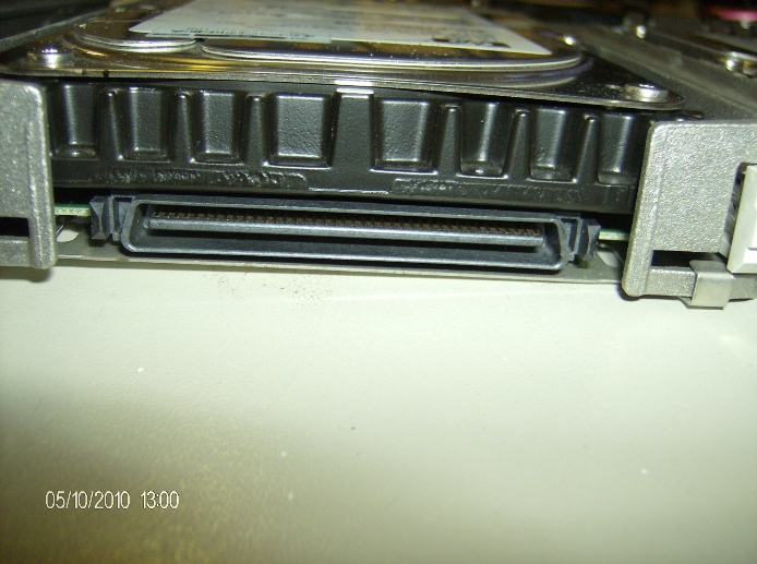

    hello everyone, serious help required.... i am in the urge of finding some sort of adapter from SCSI to "whatever works" (not other type of SCCI but ie. USB, SATA, IDE? and so).... these disks seem to be Wide Ultra320 SCSI, or at least are an 80-pin drives.
    long story short: the server broke and they want to get some registry indexes of a main and huge database, for reasons i dont know, (dont really know much details since this server isnt in my unit) they cant rely on other hardware capable of accessing this type of media... so they have approached and required me this :/
    My question is if someone's got something on this, if such adapters exists and if theres a link or a path i could follow, im even down to DIY stuff... i already am doing the necessary googling but i thought i'd ask here before gettin conclussions, based on the quality of replies ive recieved here before and to the urgency of obtaining data from those hdds...
    Any helpful info is much appreciated.
    Thanks,
    peace.

    What you need is three items, fix it to your computer and you can see or download all the files from the scsi 80-pin server hot-swap hdd.
    1) The scsi pci card refer here: http://www.adaptec.com/en-US/product...y/ASC-29160LP/
    2) The scsi internal cable with terminator refer here: http://www.adaptec.com/en-US/product...bles/int_scsi/
    3) This adaptor for 80 pins drive to 68pins cable.
    from DX or other supplier.
    Good Luck.

      according to this, i would plug the 80 to 68 pin converter (#3) in my hdd then use the cable (#2) to attach it to the pci card (#1) installed on a workstation ? im guessing some drivers required for the card but im guessing they will come along with it?
      Thanks a lot!!!!!!!!!!!!!!

        eauyong; Welcome to Badcaps and great first post!
        MXM, I can confirm what eauyong listed should work, of course you can use other SCSI cards etc but these are readily available and come quite cheap...
        I have not seen SCSI > USB, Firewire or SATA external boxes, like you can buy for IDE and SATA harddrives to easily get the data off such drives
        But even if they existed they would be quite expensive, because SCSI is very very different to those protocols, and the market for something like this is very small so no benefit of big production runs lowering costs...

          Any advise on this: http://www.scsisource.com/scsi_to_id.../scsitousb.asp
          will it work?
          the HDD specs are
          HP Part#300955-016
          "146.8GB 10000 RPM Wide Ultra320 SCSI"

            Well as you see it's really expensive
            I'd just go for the PCI card or PCIe card instead, much cheaper and more probable to actually work
            You can see that thing has been hacked together, I'd be afraid to power up something that is critically important on a hack job like that!
            http://cgi.ebay.co.uk/IBM-06P2215-AD...item35ac89d0d3
            http://cgi.ebay.co.uk/VALUE-SCA-80-P...item35ac859b63
            http://cgi.ebay.co.uk/ADAPTEC-149082...item45f5169166
            These are all from the same seller, of course I don't promise anything, ask him if those 3 are all compatible before buying or do more than the 2 minutes eBay research I did

                          I dont know how i forgot to add pic, thanks everyone for the help.
                          Leaving it for posterity.........

                            that's a very nice drive,
                            questions:
                            do you know the o.s. / format used ?
                            do you know if they where raid / jbod / some other strange multi-drive setup ?
                            just because you can connect the drive doesnt mean you can get the data.
                            • MXM
                              • 430
                              • Unknown
                              Re: SCSI adapter.......
                              hey, yeah i hope this works
                              the os is W2k Server
                              and yes they were in an array (3 disks, raid5)
                              and i hope i get to extract that data, the stuff is on its way
                              i have thought on some issues on this as wel... thanks for pointing that out. i might try to re-set the raid, if the card im expecting doesnt suport raid i guess i might just have to get me another card... 3 disks they sent me -along with the issue-, as i was told they suffered no damage (we'll see).
                              what would you recommend me??

                                get the details of the original server, and if it was pci - get the scsi card.
                                • MXM
                                  • 430
                                  • Unknown
                                  ^ Thanks, the server must've been a proliant dl380. i have managed to get me a dell power edge 2850 im trying to put that one up since it was second hand, so, lots of work still left to be done
