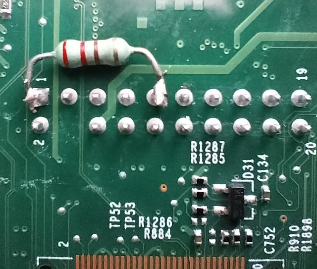

          Bodged for the AVR54 errata for B0 C2000 chips!
          At least it still boots just fine minus the slowness.
          Hope this will last forever and ever...
