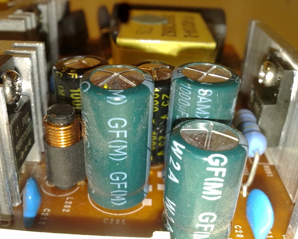

            Have a look at this power supply from an LG monitor:
            Besides the 470uF 25V Samxon in the front, the other 4 caps are 1000uF. The bulgy ones are a 16V Samxon and two 25V Decon short-heights. The one that looks okay is a 25V Samxon.
            Do you suppose if that 16V Samxon was 25V it would survive? What about if those short-heights were full-size?
            And by the way, how come the Samxon 1000uF 16V and 25V are the same physical size? The Samxon GF specs I found indicate 16V should be 16mm rather than the 20mm that it is here.

                Samxon GF series caps are Good For nothing. They are known to fail without bulging.

                  I know they use whatever is readily available or is the cheapest. But the question is, suppose a 16V cap will work but last only 5000 hours at normal usage, and a 25V cap will last 15000 hours. Will they consider compromising the product and using the 16V if it's cheaper?
                  Because, if I'm not mistaken, that's what it looks like above. A mix of 16V, 25V, and 25V short-height. No diameter or height constaints. And surprise surprise, the 16V and the short-height 25V failed.
                  retiredcaps: I'll check first if replacing just the bulging ones works. There's also another 1000uF 25V, all alone at another part of the circuit, and it's not bulging so it does suggest a pattern.
