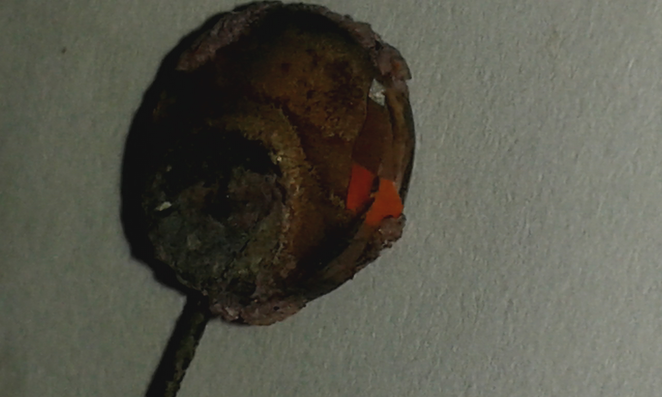

    A friend asked me to help remove the mains hum from an old 60's or 70's portable record player.
    The brand is Motoplay, which is an obscure Brazilain brand.
    Anyway. One of the caps seemingly decided to launch itself into outer space and exploded in the process.
    It appears to have been a ceramic disc with coloured stripes, and from the bits I could find and see, it appeared to be either violet or silver on top, followed by some brown, then some orange.
    It definitely had silver, brown orange going down, but the brown could have been the overall capacitor colour and the that the orange and silver had some space between them.
    It just doesn't fit into what I know regarding capacitor colour coding.
    So the question is, does anyone have any idea as to how to identify it's value?

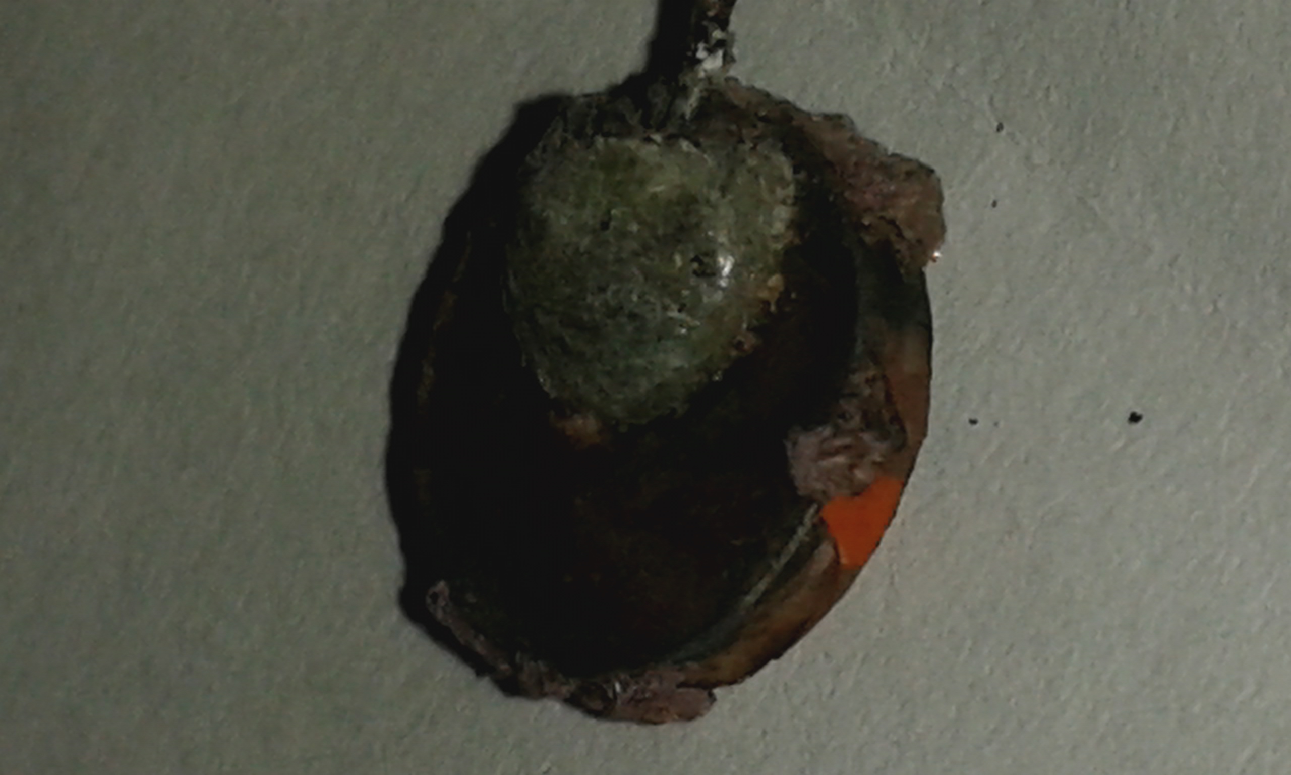

                    The picture below is part of the casing which had blown off, with the silver band being above the orange

                      My guess is a thermistor, warm it up a bit and recheck the resistance. This is the best I can figure out because of the glue etc.
                      It may be a similar circuit to this (I said similar) in the ampf1 you can see a manual bias adjustment.
                      newer thermistors color bands end with the tolerance color (silver 10%) at the top it may have been 130Ω (ntc?)

                        Looks like you are correct as the resistance goes down with heat applied.
                        I never knew that thermistors were also colour coded, so that is another lesson learnt.
                        In fact I have found a picture online just to prove the point (below).
                        The resistance now reads around 255 - 260Ω which is too high...? The 68Ω in parallel must give a hint, as electrical current always takes the path of least resistance.
                        Here is where having some knowledge of circuit design would be helpful.
                        EDIT:
                        Looking further online there is a 220R thermistor which is 'Red', Brown, Silver - So is it too mistaken to imagine that the 'Orange', Brown and Silver, is in fact 330R?

                          It may have been brown, orange, brown, silver 130Ω 10% ntc likely not too critical, it changes the resistance across the 68Ω to slightly vary the output transistors bias when the temperature changes
