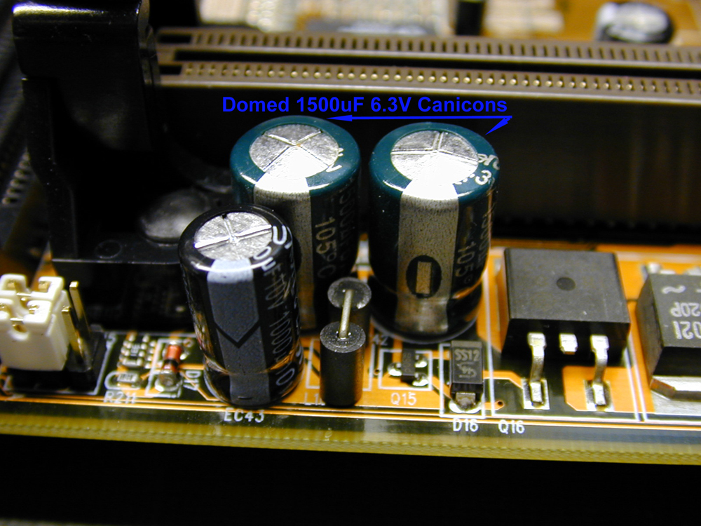

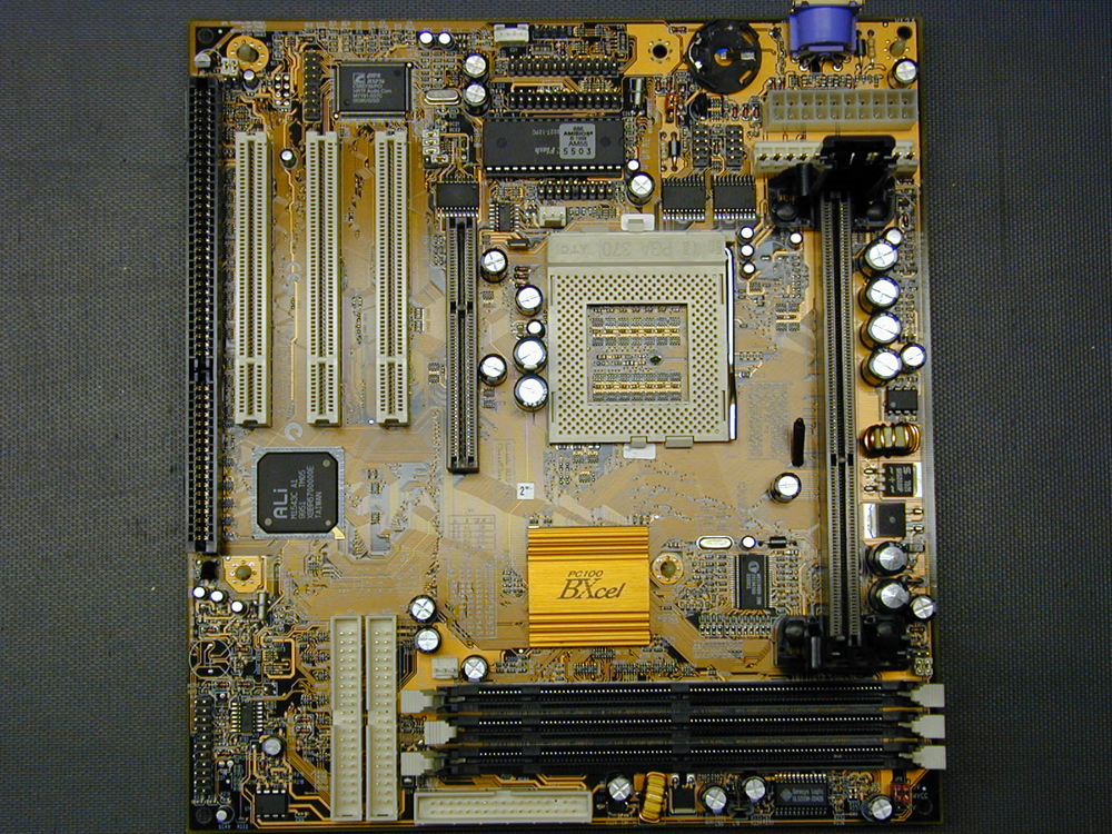

    Pics of my troubled boards #4
    PC Chips 726MRT
    v1.2A
    I know it's a P.O.S., but it has given 3 years of great service and is configurable for different proc generations. I have two of these in service. I even saved my driver disk, because I know from previous boards of theirs I've worked on, they are a bitch to get correct drivers for. One board has the AMR modem and I have to use the other board's CD for its drivers. Damn I can only imagine if I didn't have the second board to use the driver disk to get the modem to work. Whew! Good upgrade board after you get tired of the Slot 1 and want to put a PIII pull in the socket. Of course, recapping is a PITA with the sizes they use and placement.
    Material list:
    1500uF 6.3V (8) Canicon
    1000uF 10V (7) G-Luxon
    470uF 16V (10) G-Luxon
    100uF 16V (2) G-Luxon
    22uF 25V (1) G-Luxon
    10uF 25V (14) G-Luxon

    "Canicon"
    That's a brand I dont ever remember seeing....

      @Topcat
      I'll post a pic of the elusive Canicon when I re-cap the board. It's real!

        Re: Pics of my troubled boards #4
        canicon are a well known crap brand.
        not a common as others but i have seen lots of bad ones.
        i pulled some from a video card last week.i will see if i can find them and post a pic.
          i have them on a celeron motherboard (tx?). 10 x 1000uF 6.3v. bulged - leaked.
