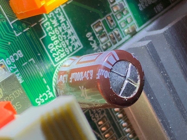

    Hi all.
    Just joined and looking for some capacitor assistance. I am new at this so please bear with me ....
    I have an ECS RS780M-M3 motherboard and the brown ATWY caps are bulging and the board has become unstable. Caps say 6.3v and 1000uF. But I have some confusion Picture attached.
    This link ATWY Reference says the size is 10x16mm. Measuring them myself I get 8x12mm (Still on the board) which implies 3mm between the legs.
    So first question is are the specs link incorrect ? I want to try and get a capacitor with a similar size, impedance and ripple but I am thrown by the size difference and what specific capacitor would be a suitable replacement?
    As I need about 10 replacements I'd like to get it right before ordering. I have shopped around but struggle to find such a high ripple, 2000mA and low impedance 0.034ohms. Any thoughts ?

    custom size,
    pretty common to find that happening.
    use polymers to replace them.

      470uF polymer caps would be a suitable replacement.

        oh thanks. Is there some formula here or do I just target the impedance and similar ESR and 6.4v and see what that leads to for capacitance?
        Is that something sold on this site or are there recommended places for such caps ?
          • 31086
          Re: Capacitor TK ATWY Replacement for ECS RS780M-M3 Motherboard
          well i would use higher, like 820uf.
          no real formular to it, just people experimenting.

            I'll pick from one of these
            RNU0J821MDN1KX
            or
            870025174009
            or
            870235174003
            appreciate all the assistance

              I'd use Nichicon but the Wurth ones look really nice - it's an aesthetic decision at this point.

                The cap in first post appears to be just a general filter on the motherboard. Many motherboards have small 8 mm diameter caps in the range of 820-1000 uF for various filter functions - RAM Vdd, RAM Vtt, SB/NB Vcc rails, and general 3.3V and 5V rail for PCI/PCI-E slots. The ESR of these caps isn't critical in most cases - rare exception being any buck-regulated rails, which aren't too common, except for RAM Vdd and/or NB Vcc, typically.
                In any case, I've had no problems using these the most often:
                Rubycon ZLH 6.3V, 820 uF
                Rubycon ZLQ 6.3V, 1200 uF
                Rubycon YXG 6.3V, 1000 uF
                The ZLH above is probably the easiest to find anywhere online, like Digikey, Mouser... or even here in the BCN store
                I wouldn't go for polymers, due to higher cost and not really being needed.

                    You can also measure the actual voltage on the capacitor if you power up the board.
                    That might allow you to go down in voltage to say a 2.5v polymer capacitor if the capacitor is filtering the chipset for example.
                    As that will be a voltage much lower than the capacitors rated 6.3v...
