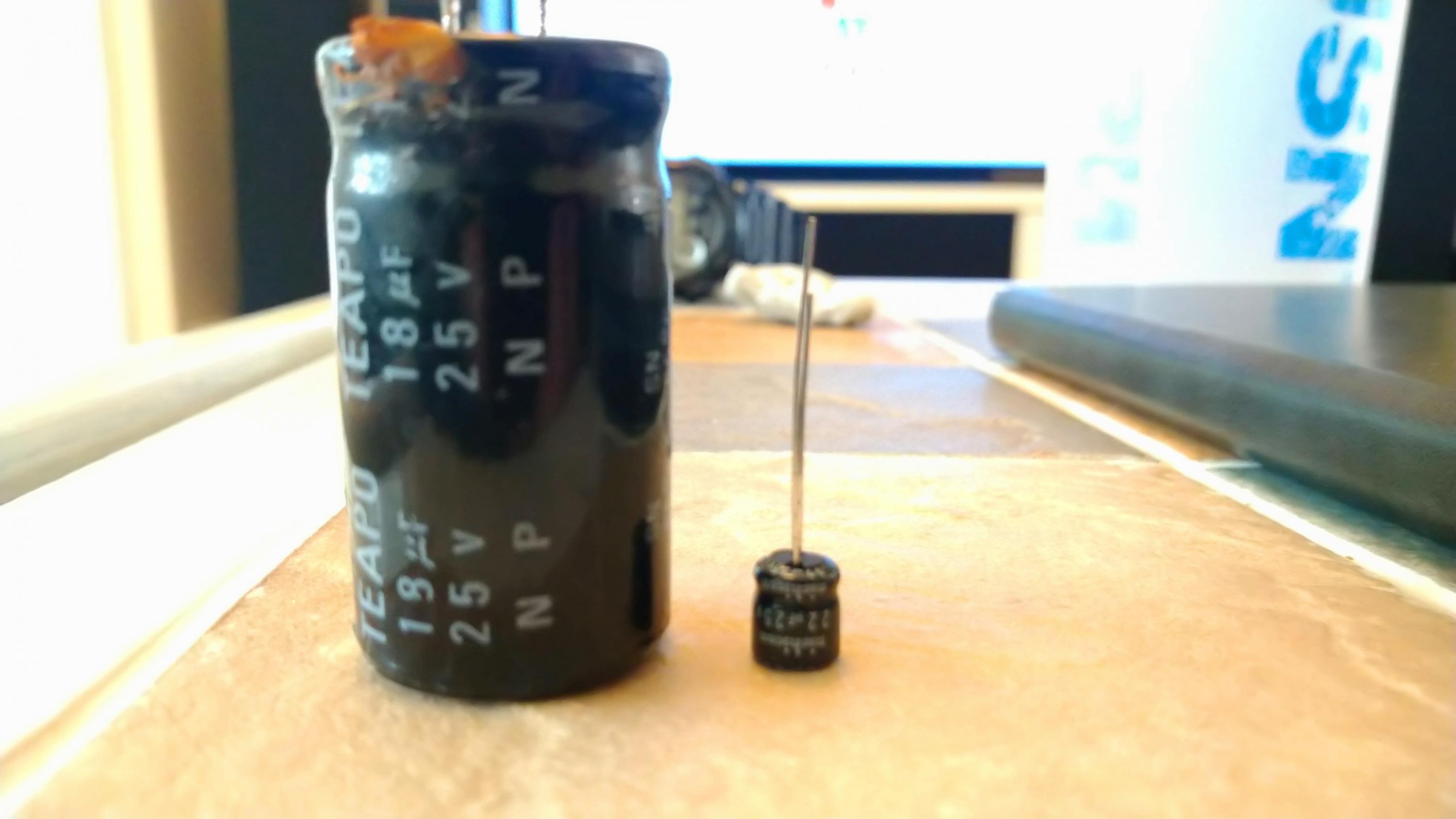

    So the replacement caps arrive, I've had to obtain a 22uF 25v NP cap as there weren't any 18uF 25v available, not sure what the consequences of this might be.
    But check out the attached.
    The replacement caps are tiny, I ordered two different 22uF 25v NP caps and one is pictured beside the original 18uF 25v NP cap.
    Something's afoot. That size difference is alarming.
    I feel I've missed or misinterpreted something.
    Would really appreciate some input here...

      Re: This can't be right...
      But how would you explain the physical size difference?
      That's what I'm alarmed by, the old cap is a lower capacity same voltage as the replacement capacitor so why is it 20x the size?
      I really feel we are missing something here...
      None of the other replacement capacitors have shrunk in dimensions by anywhere near that magnitude, the others are maybe 10-20% smaller, not 2,000+% smaller.

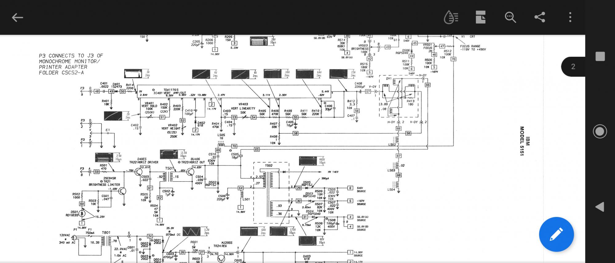

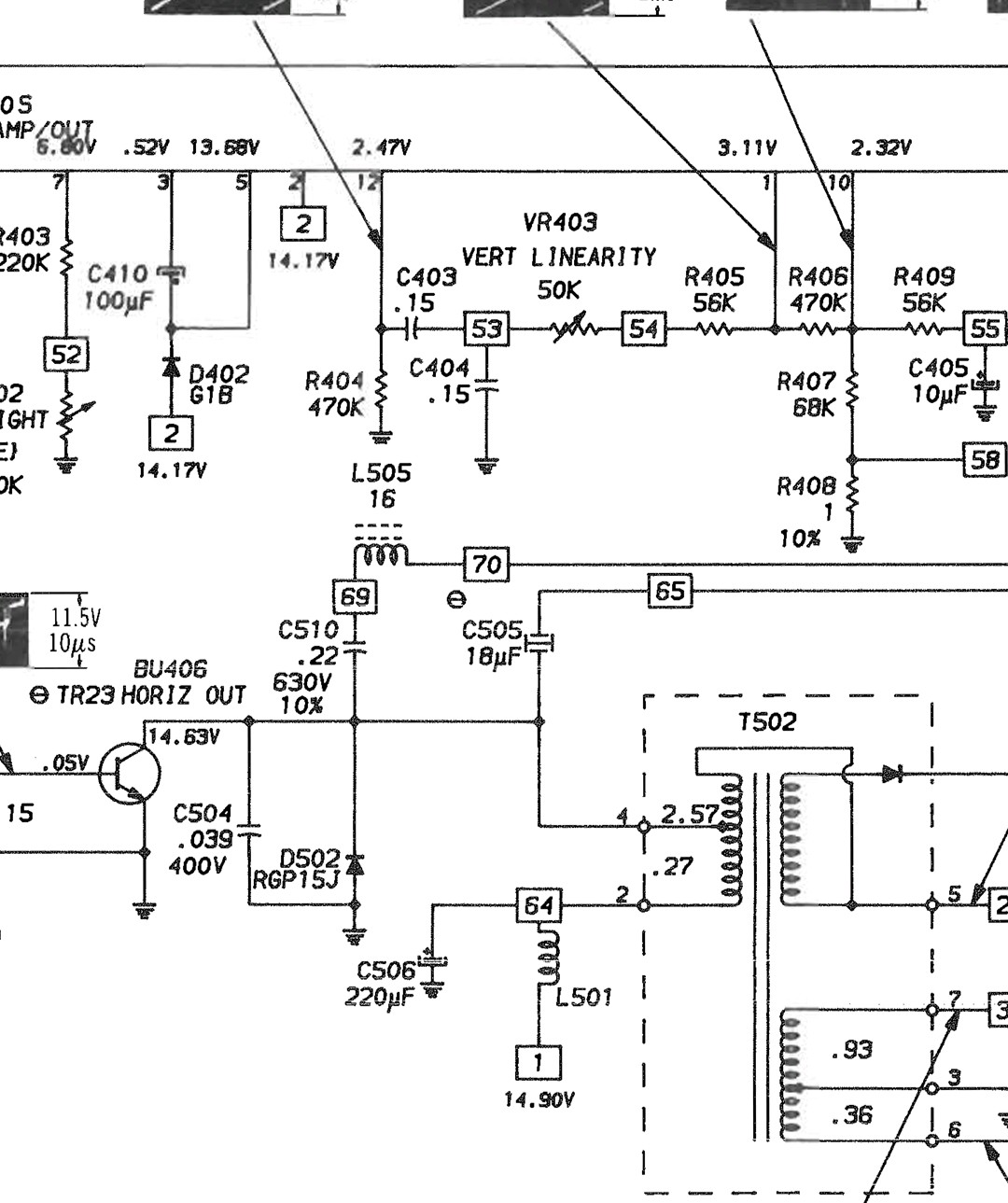

        Yeah, I've zoomed out on the SAMS for this monitor and you can see that C505 is positioned between the flyback and the horizontal deflection coil.
        You can also see that it's referenced to the HV output of the flyback, it's not galvanically isolated.
        I really feel like we are missing some kind of special characteristic that this capacitor exhibits... Either that or the voltage rating on the old cap is just plain wrong on the label?
        Probably not given the collector of that tranny is rated 14.63v on the diagram... But then why is C504 rated 400v?
        You see what I'm scratching my head over?
        I'm not confident on this, never worked on something like this before...

          In short I would just leave that capacitor as-is.
          Because I am not sure you will find any modern replacement.

            The small cap will not handle the current, it will last about 1 minute and blow. Leave the original in place. If it was bad (as in open) you would have no horizontal deflection. You could use a 18µf polyester film capacitor.

                              Is this the original problem with the monitor BEFORE you replaced the capacitors?
                              That fault looks like it is with the power supply, What is the voltage on TR24 collector?
                              Upload the service manual/Schematic
                              Post #4
                              The cap has to handle high voltage spikes at the horz. frequency so it is rated 400v
                                  This capacitor has to sustain 5-8A of current and a sawtooth AC voltage which will blow any electrolytic capacitor not specifically made for this purpose.
                                  These specific capacitors are very rare since they were produced exactly for CRT monitors. And, of course, they are out of production.
                                  The current is so high than even a generic polyester capacitor will have difficulties handling the required current.
                                  You should parallel three 6,8uF polyester capacitors and they should be adequate as a replacement.
                                  The voltage should be 50V, not less. There are spikes in this current so even better if 100V.
                                  No worries if the resulting capacitor will be higher in capacitance: I've tested replacements of this exact capacitors (which is present in most CRT monitors) and a larger capacity won't affect the width of the picture.
                                  I suggest Panasonic ECQ capacitors or something of good quality. There is not only a lot of current but also high frequency (15.8KHz)
