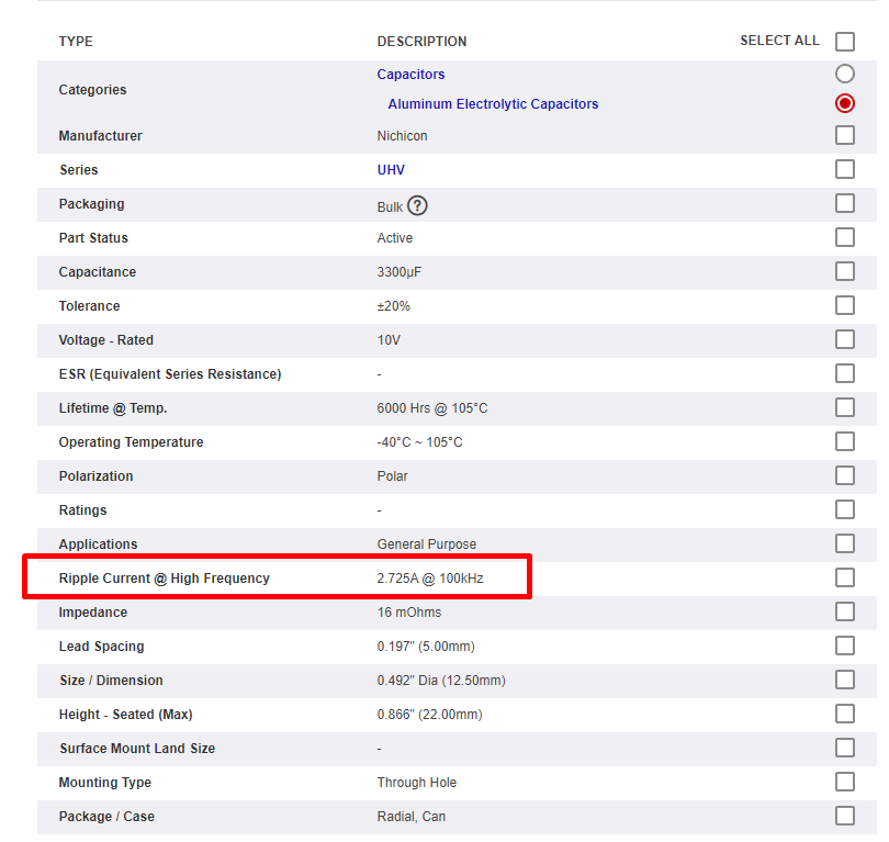

I see this value varies within several 3300uf caps. Do you want that number low as possible? It's very high on polymer caps.
Do I want Ripple Current high or low?

for capacitors, it refers to the maximum ripple current handling capacity before the capacitor goes kaput really fast. therefore, the higher the ripple current handling capacity rating, the better. there is no limit.aim for the sky. hope that clarifies it.
Re: Do I want Ripple Current high or low?
So is there overhead with this rating? Like near a computer processor, if you replaced a capacitor with the same voltage and capacitance but went lower on ripple rating, would it be an issue? I assume it would be more of an issue in a power supply secondary side?--------------------------------------------------------------

Well, a MB has DC-DC converters on it, basically DC input power supplies. So impedance and ripple current ratings for the input and output capacitors matter.
When you're talking about the decoupling capacitor networks for a processor, those can have current transients in the tens of amps at rates in the 100s of amps-per-microsecond. Narrowly speaking the electrolytic or polymer capacitors in the decoupling network need to be low impedance - low ESR and low ESL. But capacitors with low impedance generally have high ripple current ratings.Last edited by PeteS in CA; 09-30-2020, 06:32 PM.PeteS in CA

some of them are rated at 100KHz and some are 120Hz, i don't know why they are not measured at the same frequency?Comment
It's an XBOX. Original caps were something like 2800(mArms) and the new ones I've been replacing are 2200 and 2500 (ZLQ and UHV). I've been going with 10v lately because space permits the slightly wider cap while getting a boost on the ripple current rating.Last edited by jayjr1105; 10-01-2020, 06:46 AM.--------------------------------------------------------------

Modern low impedance and ultra-low impedance parts will be rated at 100KHz because the anticipated usage is power supply and DC-DC converter output capacitors. Switch frequencies vary, of course, but the datasheets typically have a graph that gives an idea of how a part's impedance varies with frequency.
120Hz rated parts tend to be general purpose or designed for bulk input capacitance for a power supply.PeteS in CA
