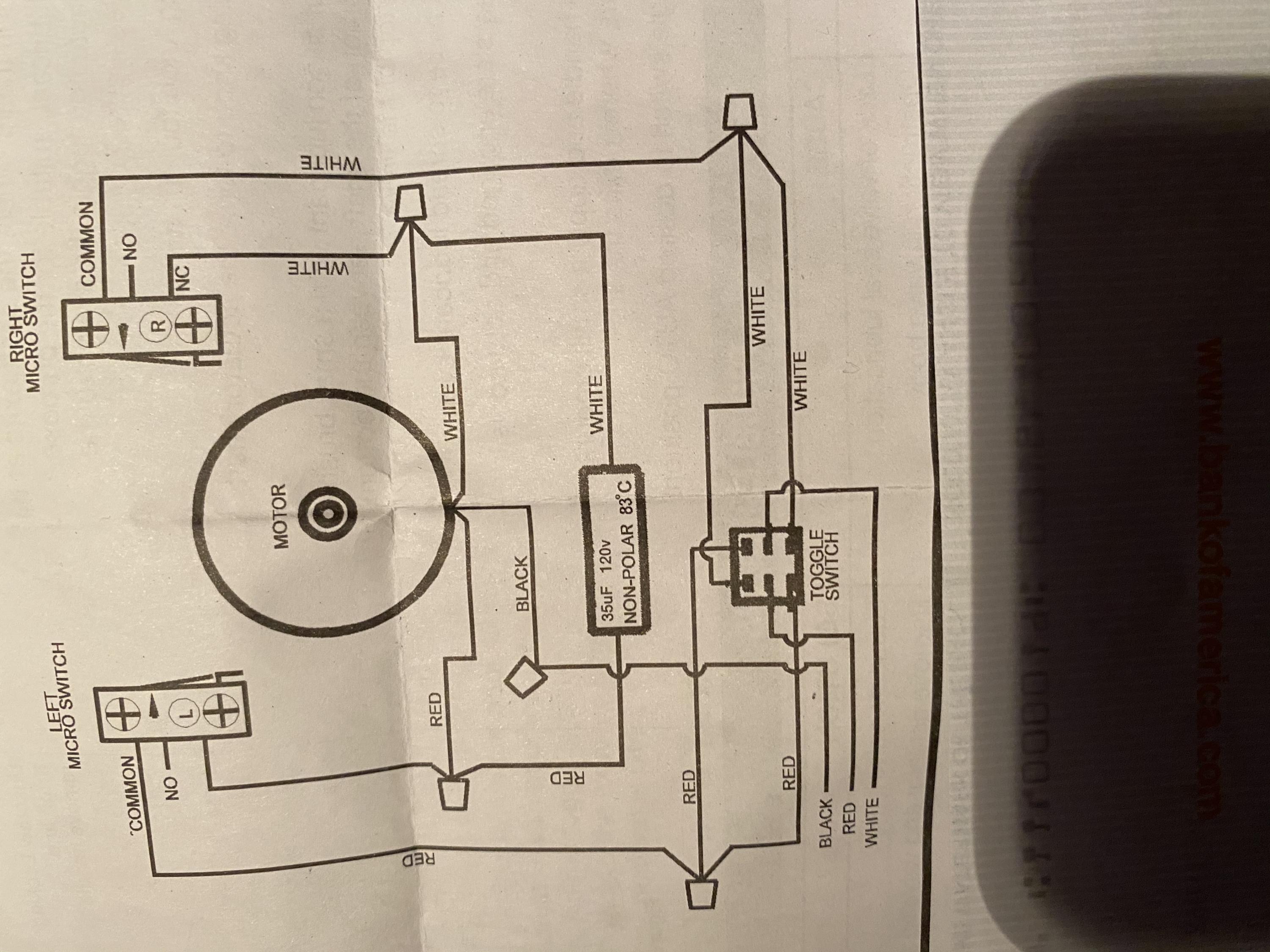

I have been having trouble acquiring an exact match for a capacitor that apparently activates a motor in my spa valve control. The schematic details a 35uf 100V 83c non-polar cap. On Line I have found many close to these specs but none are exact. Accordingly, I need to know how much these values can fluctuate. I did find a capacitor with the values 35uf 50V 83c non-polar and I have also noticed that the schematic diagrams indicate that this circuit operates using 24VAC. So can I use a 50V cap? I have also found many that are rated at 33uf and up to 250V. I know that having the capability of 250V being more than 100V would be OK (except maybe for the size), but is it safe to replace a 35uf capacitor with one that is rated 33uf? I also know that most, if not all, capacitors are rated plus or minus so a 35uf will probably be OK if it returns 33uf, but a 33uf might fall below minimum for the circuit. I've studied the net a bit, but I still feel I need just a bit more education. Where do I go to learn more?

1) Attach the circuit diagram for us to look at.
2) Attach good clear pictures of the whole top and bottom side of the board.
3) What is the reason for suspecting bad "35uf 100V 83c non-polar cap"?Never stop learning

AC feeding is only 24VAC? 33uF will be fine since the cap is +/- 20% tolerance.
The sch shows 120V rating for the cap, using higher Voltage will be fine.

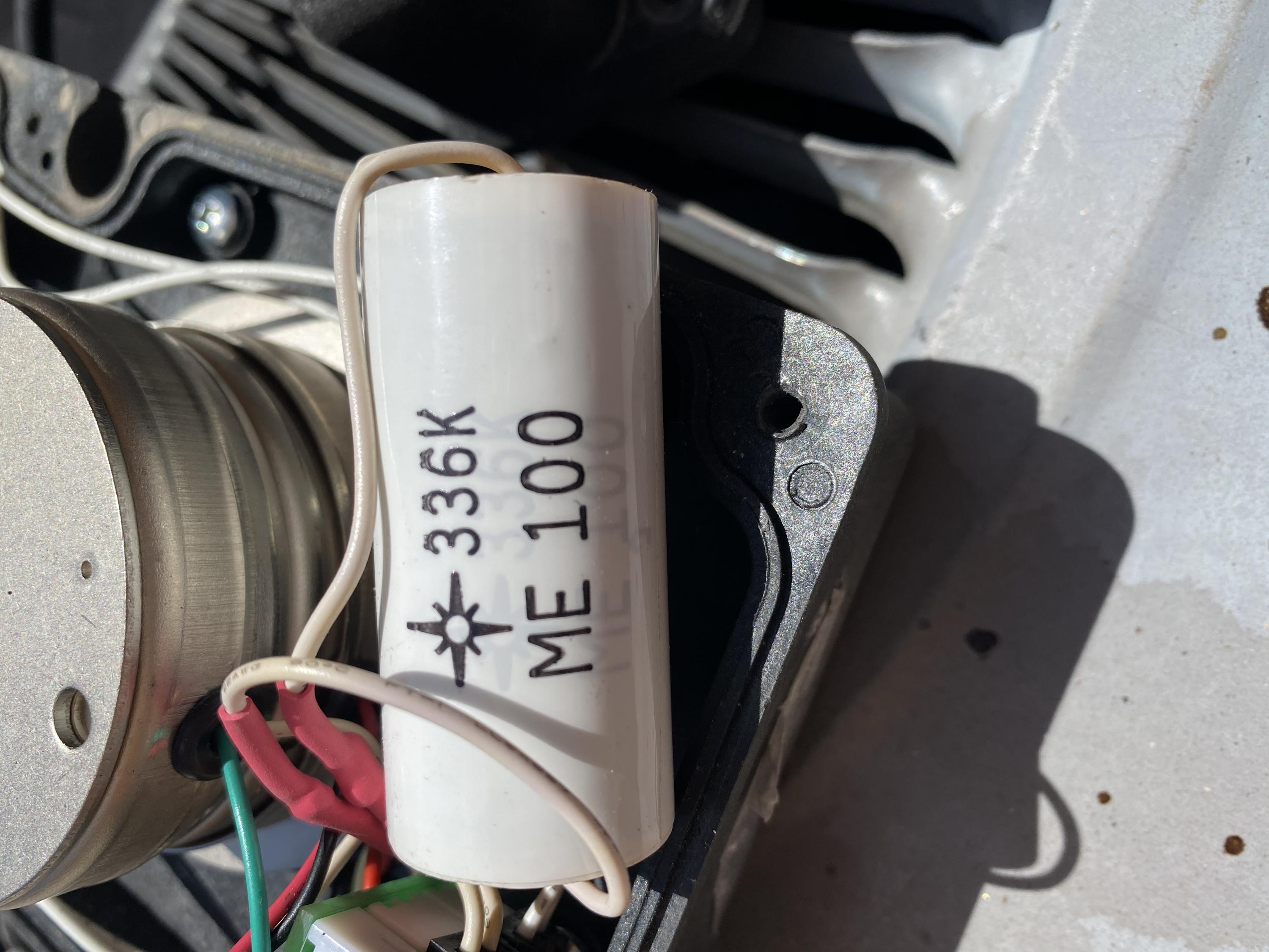

I have attached a photo of the existing capacitor.

The capacitor you have is 33uF (336, http://kiloohm.info/3-digit-capacitor/336), K = +/-10% tolerance, 100 = 100V. It will be rare to find this type of cap rated <100V.
This looks to be polypropylene film capacitor for AC motor.

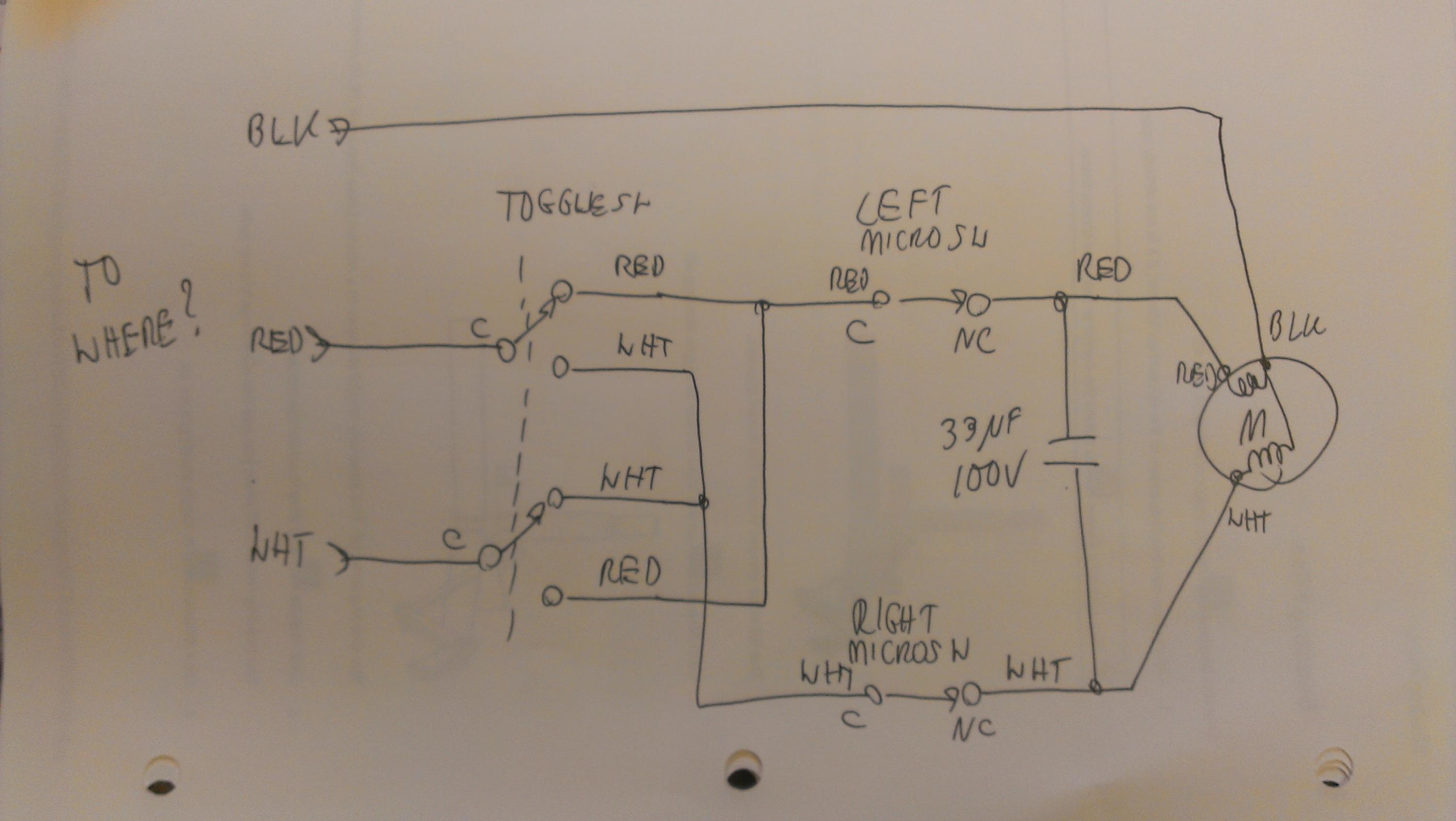

Typical 3-wire AC reversible motor wiring, I redraw your motor wiring as shown in second picture.

I am sure your drawing of the motor is accurate as it is a reversible motor.
Concerning the question in your second drawing the wiring goes to the spa control panel.
