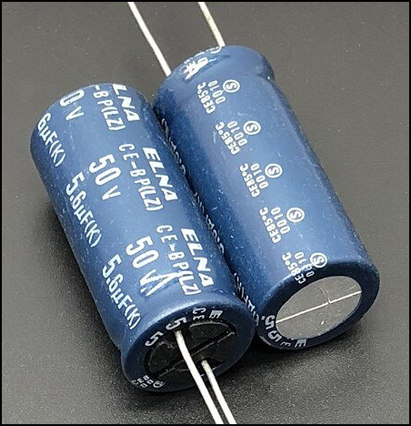

    Looking for the datasheet of this 5.6uF Elna capacitor
    I am looking for the datasheet of this (quite old) Elna capacitor. It is rated 5.6uF/50V, CE85° 0010 (S), the serie is CE-BP(LZ).
    Thank you.

            @Momaka: This is a good idea as this one measures a bit badly (around 2Ωs of E.S.R.) and quite high loss. Tipically this kind of capacitor as a E.S.R. inferior to 1Ω (measured other series took from CRTs) and very low loss (not higher than 0.8 on the average E.S.R. meter). It could be that it has aged. Howewer it is not clear if a single PP/PE is able to withstand 5-6A of ripple while this one should (though I will not use it as it measured badly).
            @japlytic: I think so. Howewer ELNA had another serie for this purpose and it is named with “H”. I've seen this different naming frequently even with other brands. Some are named “H” and some are named “LZ”. Sure they are both indicating high frequency capability but the differences are not clear at all.
            The suffix “LZ” is also used for several series low E.S.R. capacitors used in switching power supplies.
            The suffix “H” seems to be restricted to the purpose written by japlytic.

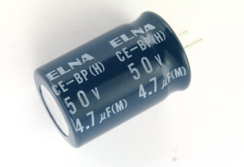

            The following one is the “H” variant. This is for sure for horizontal deflection coupling as it was listed as that onto an electronic store:
            Fitting the unproper capacitor in this circuit will result to failure of other components and the availability of replacements is quite scarce by itself. So it would be good (and also useful to other users) to discern which is which or if they are both suitable for the purpose.
