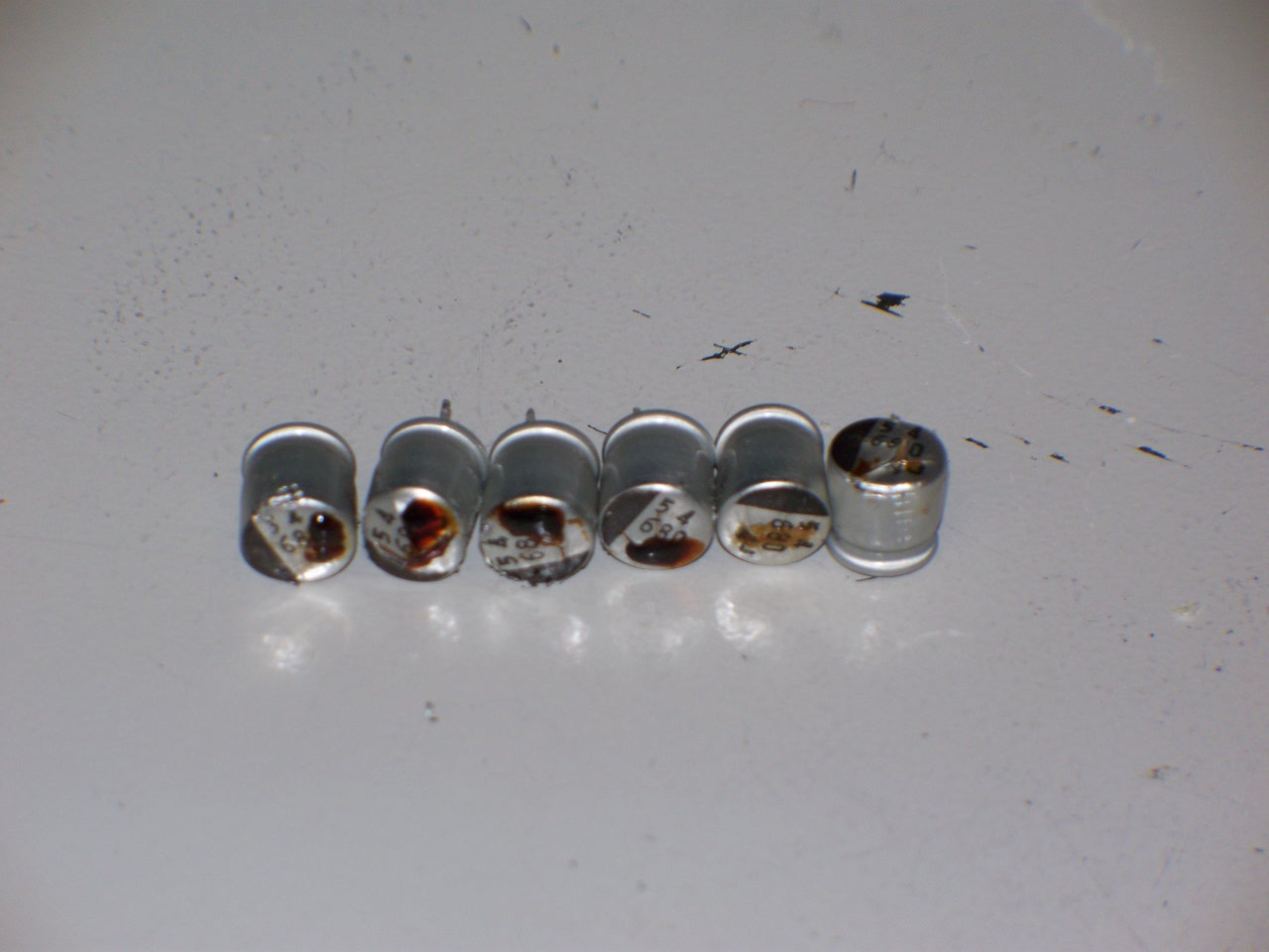

Just got a Dell Dimension 8400 for a recap. The CPU VRM caps are all UCC 4v 820uf. I'm guessing, since there's two groupings of 4 caps, that they're serial, for a total of 16v in each grouping. Two of them have popped in the one grouping, and I'm planning on replacing all 8. Am I okay to replace with 6.3v caps? If they are serial, that'd put it at 25.2v rating for the group.

Going from memory, the markings on the top were:
56
680
4
Nothing else, and the negative mark was black. For some reason, I was having problems getting them out (I've recapped motherboards before without problems), so they are a little marked up, but I'll take some pics tomorrow.Comment

I went with 680μF 4V Nichicon LF polys

Yup, not Poly and I don't think UCC.
They appear to be Sanyo [now Suncon] but too may use that marking pattern to say for sure.
[Sanyo sold their Lytics division in Apr 2009.]
http://www.altec-ag.ch/ger/News/Lett...etter_0409.pdfMann-Made Global Warming.

It's hard to see the "K" in the picture, but I think Sacon uses a similar vent.
The Rubycon "K" looks like a real K - all 3 lines meeting at a point.
The Sanyo "K" isn't really a K. One of the legs intersects halfway up the other.
From what I've seen, I think Sacon is in between Sanyo and Rubycon style. They look similar without being an exact copy:
