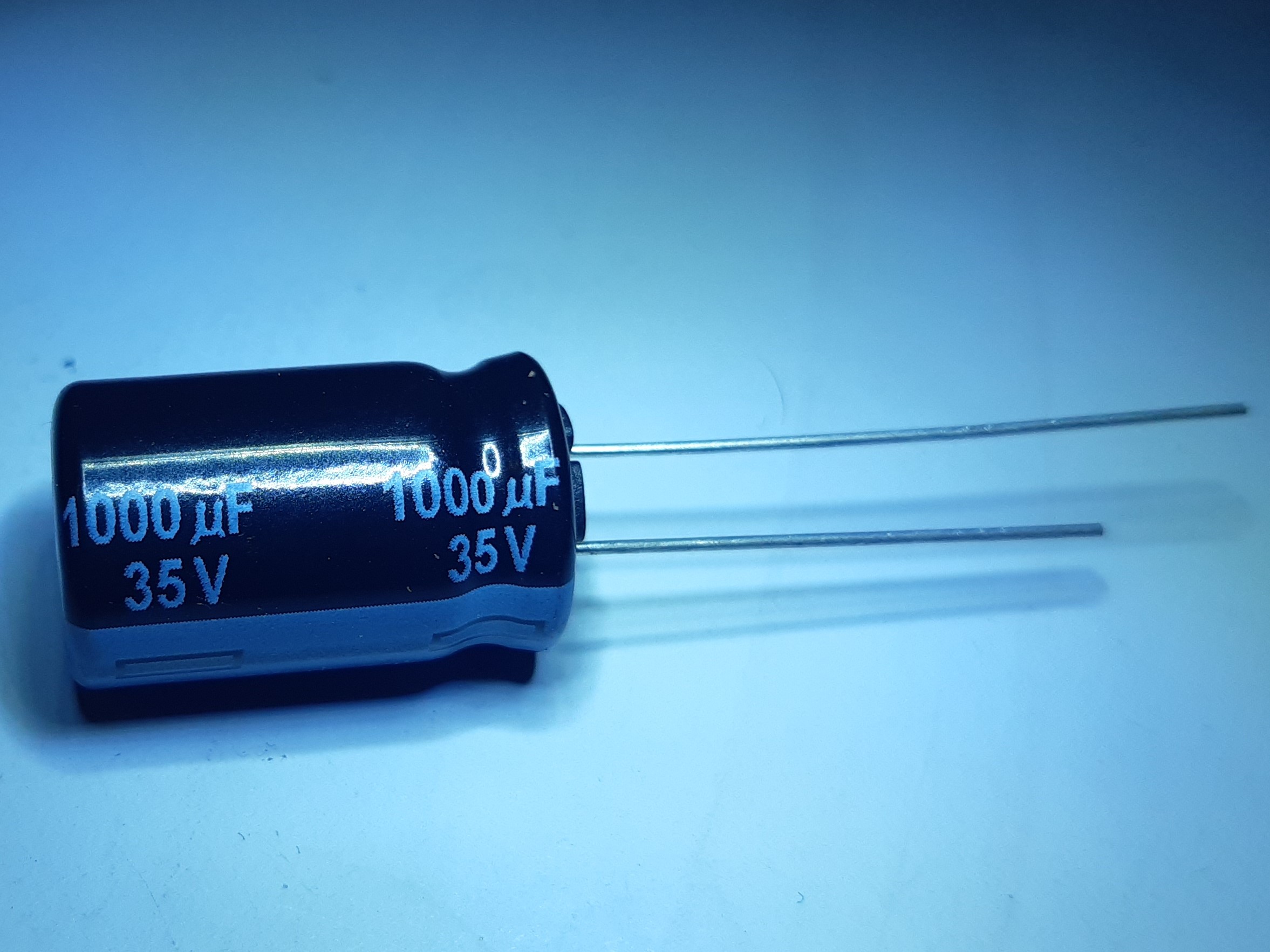

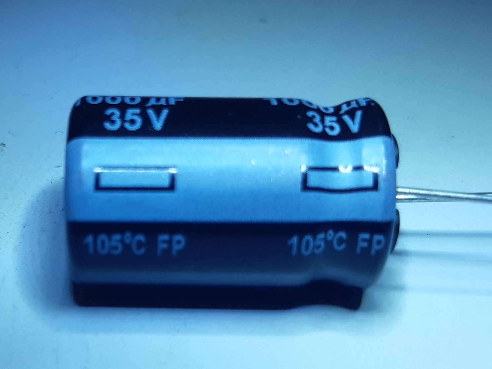

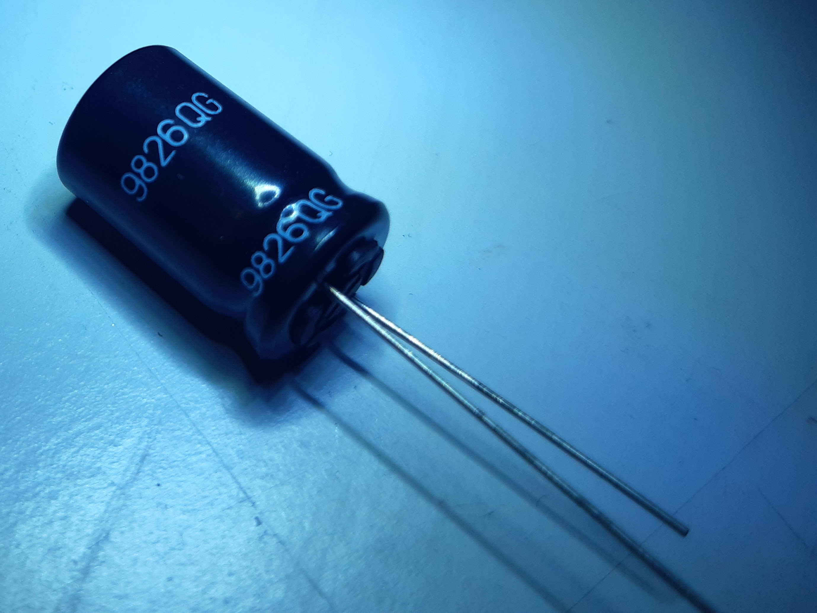

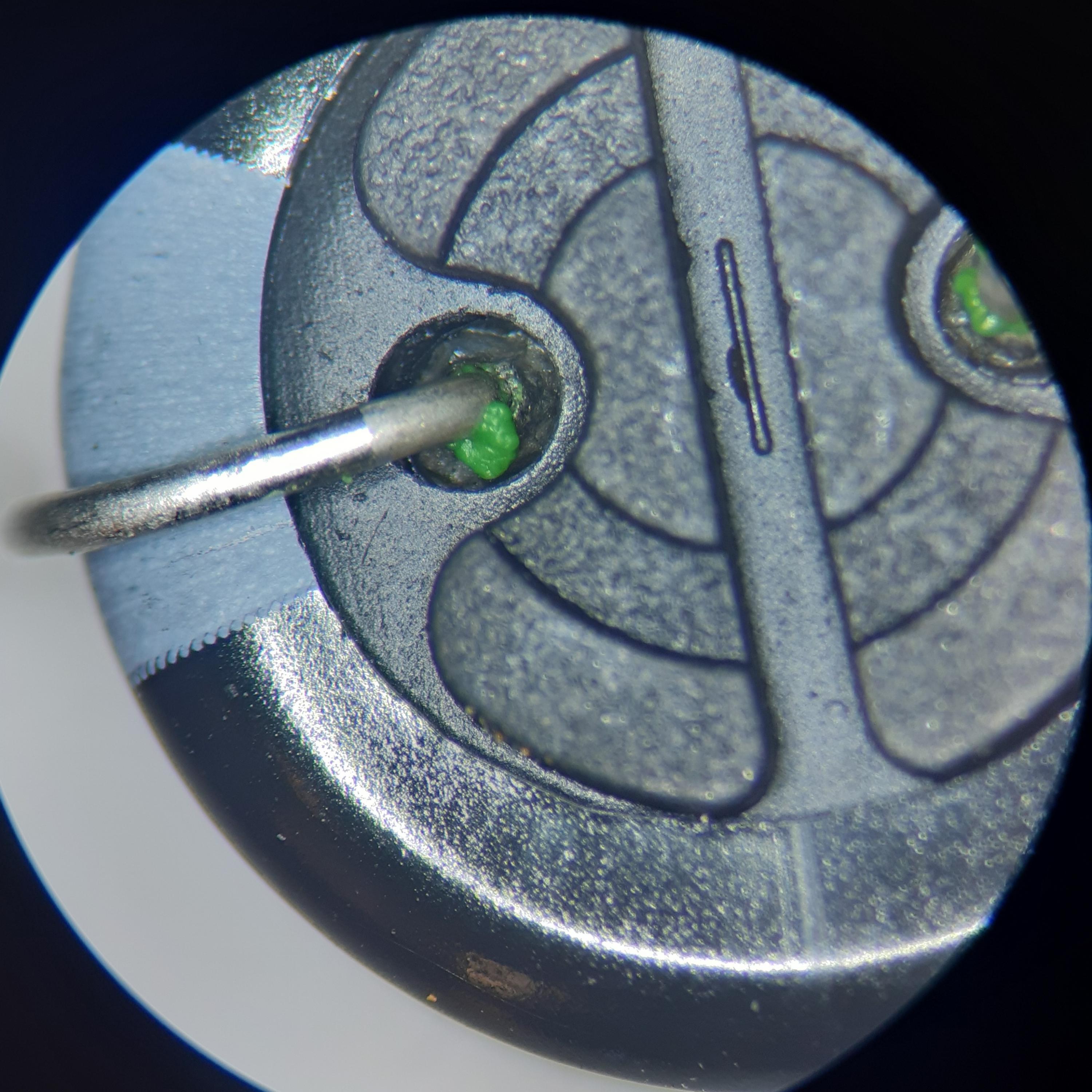

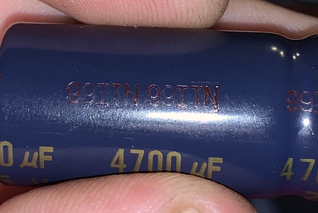

    Hi there, as this is my first message, I'll introduce myself briefly:
    My name is Peter and i have a small electronic repair bussiness in The Netherlands. I have visited this forum multiple times to gather useful info, and now I stumbled onto something you guys might be interested in.
    For a recurring recapping job I needed 1000 uF 35v caps. Normally I stick with Rubycon, but as there was no stock of YXH caps, I bought some Panasonic PF caps. Unfortunately, they got just a bit too hot due to the ripple current (maybe because of the smaller size) so I did not use them in the end but contacted Mouser and they kindly restocked the Rubycons.
    Today I needed a 1000uF cap with a smaller footprint for another repair and grabbed an FP that was still laying around (I think for a year or so) but noticed green corrosion at the legs base. This does not look good at all and after checking the rest I concluded that almost all of them (20) have the corrosion. As this is my firs post, I'm not able to post pictures, but I'll post them later.
    The production code on the caps is 9826QG. I don't think they are from 98, but could not find what the right production date is. Does anyone know how to decode this?
    The MFN is EEU-FP1V102. Pics:

      #62
      Re: Panasonic FC series - leaking? quality gone?
      The FP series is the miniaturized FC series with a much higher ripple current rating. It was released over two years ago. Both series are supposed to be certified for automotive applications. I’d guess it’s non-aqueous like FC going by the temperature rating in the datasheet (attached). In accordance to Panasonic’s date decoding system (also attached), those have August 2019 datecodes. That said, seeing nearly twenty of them leak at both leads unused (genuine Panasonics retaining their leads in full, assuming the pressure relief vent looks correct) just by sitting for a year at room temperature? ...Not good... maybe it’s time to start avoiding all non-aqueous Panasonic capacitors.

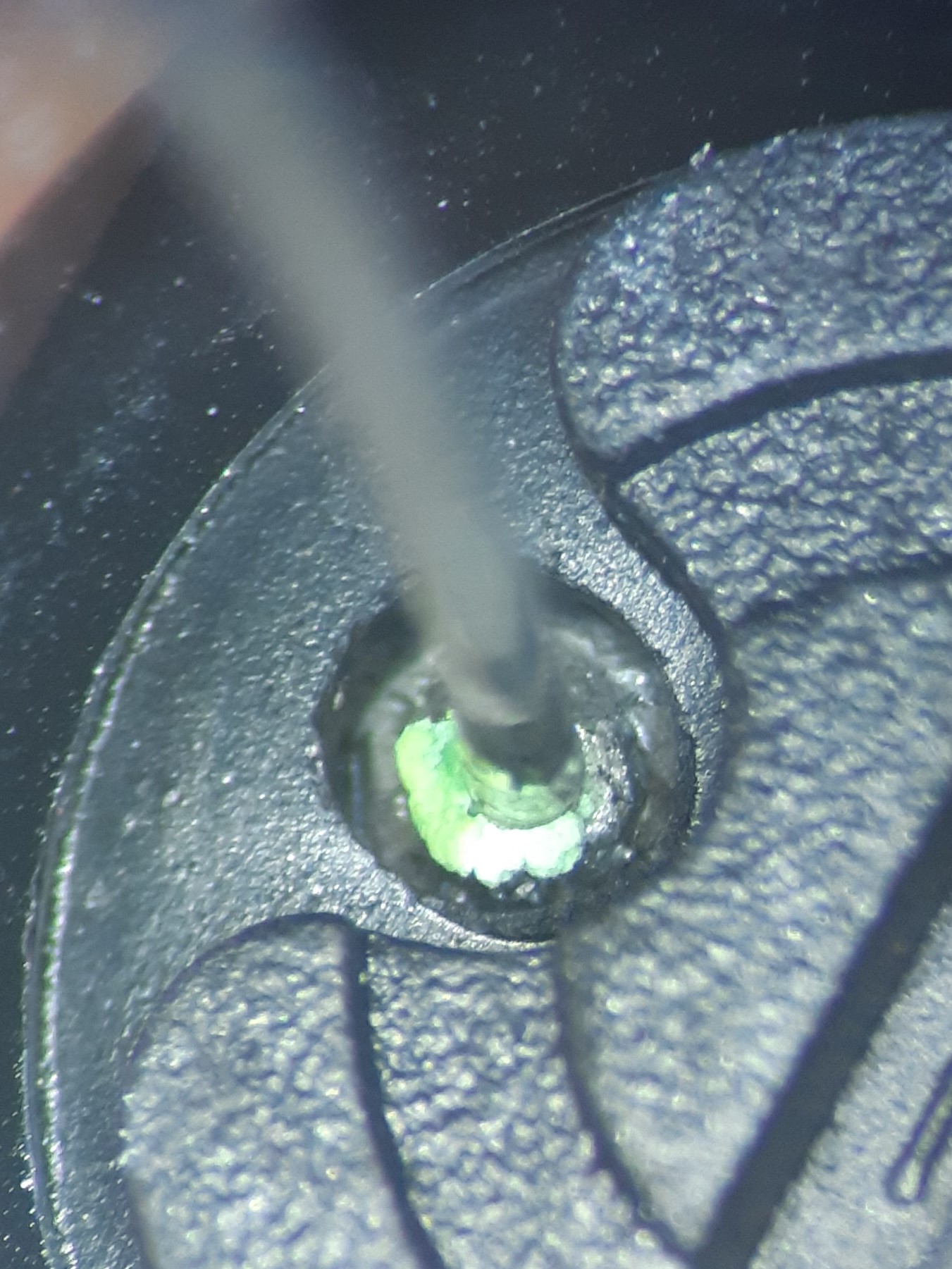

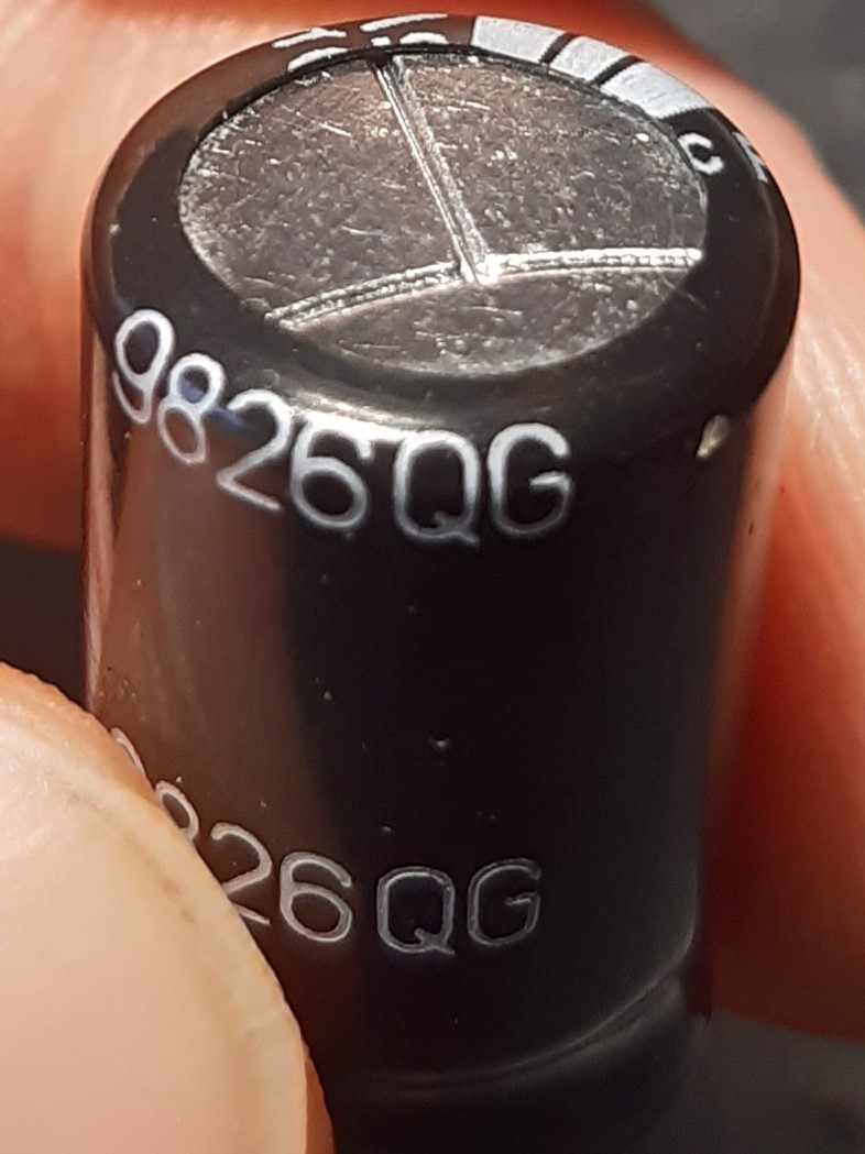

        #63

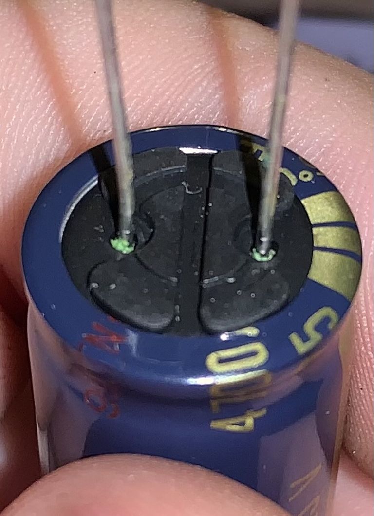

        Ah, I did not know that the datecode format works after 2010 for the last digit as well. Thanks for sharing!
        I was wrong about how long I stored these caps, because I bought them at June 6th 2020 from Farnell. I don't think the corrosion has formed in three months, especially because they are in a clean cabinet in a warm and dry lab. I doubt the storage Farnell wasn't optimal (but I don't remember the package).
        See the attachment for the vent.

            I don’t want to denounce Panasonic (as a brand) too hastily if my last post ever came across as such (Panasonic FK, for instance, seems to be fine). It’s a possibility those Panasonic FPs (and the 100uF 16V Nichicon PMs you purchased from way back when) were somehow subjected to non-operating shock between the time they were manufactured and delivered, which could have resulted in the seals being compromised and the obvious happening thereafter.
            It may seem dubious at first given that capacitors have easily survived long falls and dented vents before, but this thread from over thirteen years ago which details a Nichicon LU primary leaking at the top after a NPS-250KB took a very hard fall leads me to conclude it’s more than possible (and Panasonic recommends against using dropped capacitors in their engineering drafts as they may be damaged mechanically or electrically). It still doesn’t explain FC’s propensity to leak after a decade or so based on the experiences of other members here. It seems that series does have an issue with the rubber bung decomposing.
            The reason I came to the conclusion it’s a problem is it denotes the series can no longer be fully trusted and ideally when doing repairs you’d do them once and do them right for peace of mind, not to have to come back later on to have to redo them (especially in other’s equipment, I suppose if it’s not mission critical it can be overlooked). And what’s worse is Panasonic FC leak from the bottom which means its electrolyte will inevitably eat traces and cause all sorts of dastardly problems. It’s the worst type of failure for electrolytic capacitors. So for those reasons, I would no longer use them in repairs. But that’s just my opinion and of course others may differ from mine (as others might regarding brand reliability, etc..).

              The reason I came to the conclusion it's a problem is it denotes the series can no longer be fully trusted and ideally when doing repairs you'd do them once and do them right for peace of mind, not to have to come back later on to have to redo them (especially in other's equipment, I suppose if it's not mission critical it can be overlooked).

                      #70

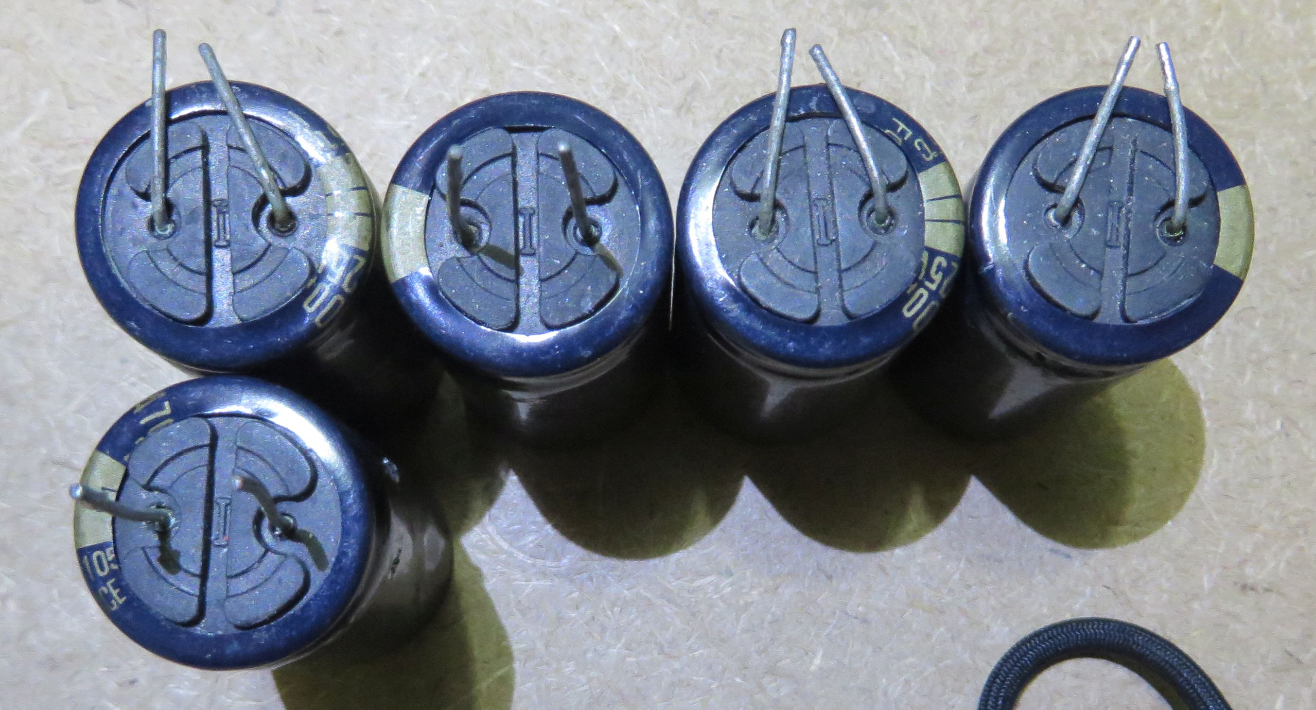

                      Some new findings here. Probably old stock (1999 September? Is it possible?), but this leakage is really disappointing. Do we have any information about how stable it is after this some leakage? Since there is no evidence of more leakage than this tiny amount already done its work. I will try to stress these with some ripple current to see if it gets worse tough. Measurements are fine except a tad higher Vloss. All 20 units affected and measured just around this one.

                        #71
                        It looks like they (the NOS FC series units) were manufactured in the second week of September, of either 1999 or 2009. Either way, disappointing since they were unused (and the FC series is supposed to be certified for automotive use…). I would not ever recommend using capacitors which have leaked because once they’ve leaked they may continue to leak their electrolyte. Added to that, they are leaking from the bung, and their acidic electrolyte could easily eat through PCB traces. Once this happens (the electrolytic leakage), it’s only a matter of time before they go out-of-spec since they’re losing electrolyte (loss of electrolyte will lead to plummeting capacitance, increased ESR, etc).

                                  #76
                                  Pay no heed to what brethin said, you were right to post and it is a good post.

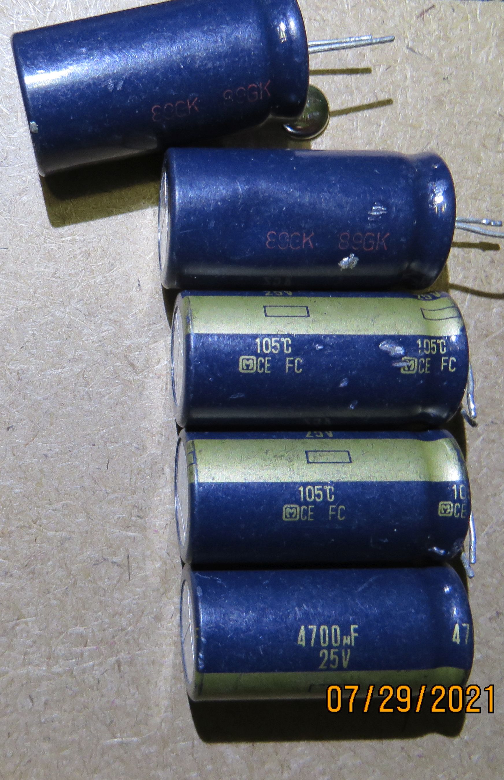

                                  Yes, there are definitely issues with FC. I set aside all my FC and no longer use them in my repairs.
                                  For comparison, I purchased some 'recycled' FC a long time ago from China (but I know they are authentic because they have 'patina' on them from the sweatshop where they were removed by someone who got paid with a bowl of rice noodle at the end of the day.
                                  These are fine I think, I don't see any green oxidation. I think these are very early FC. I ordered them because I needed two for an Altec Lansing main unit/subwoofer. But I do have other *newer* FC which do have the green oxidation.
                                  Somewhere along the line Panasonic changed something with the formulation of the electrolyte.
                                  To be honest, I don't even trust Nichicon PW anymore. I'm pretty sure I saw this same oxidation while looking through my stash.
                                  The only low-ESR non-aqeous series I would trust right now is UCC LXZ. It's very expensive though, so I try to use aqueous-only series (HE, FR, ZLx, YXx - whatever's on sale).

                                    It might be a manufacturing/construction error, the leads have a spot weld bulge right at the bung hole. I found the bung hardened up fast as well. It's not rock hard but poking it there is not much flex at all. So I think it's a sealing problem.
