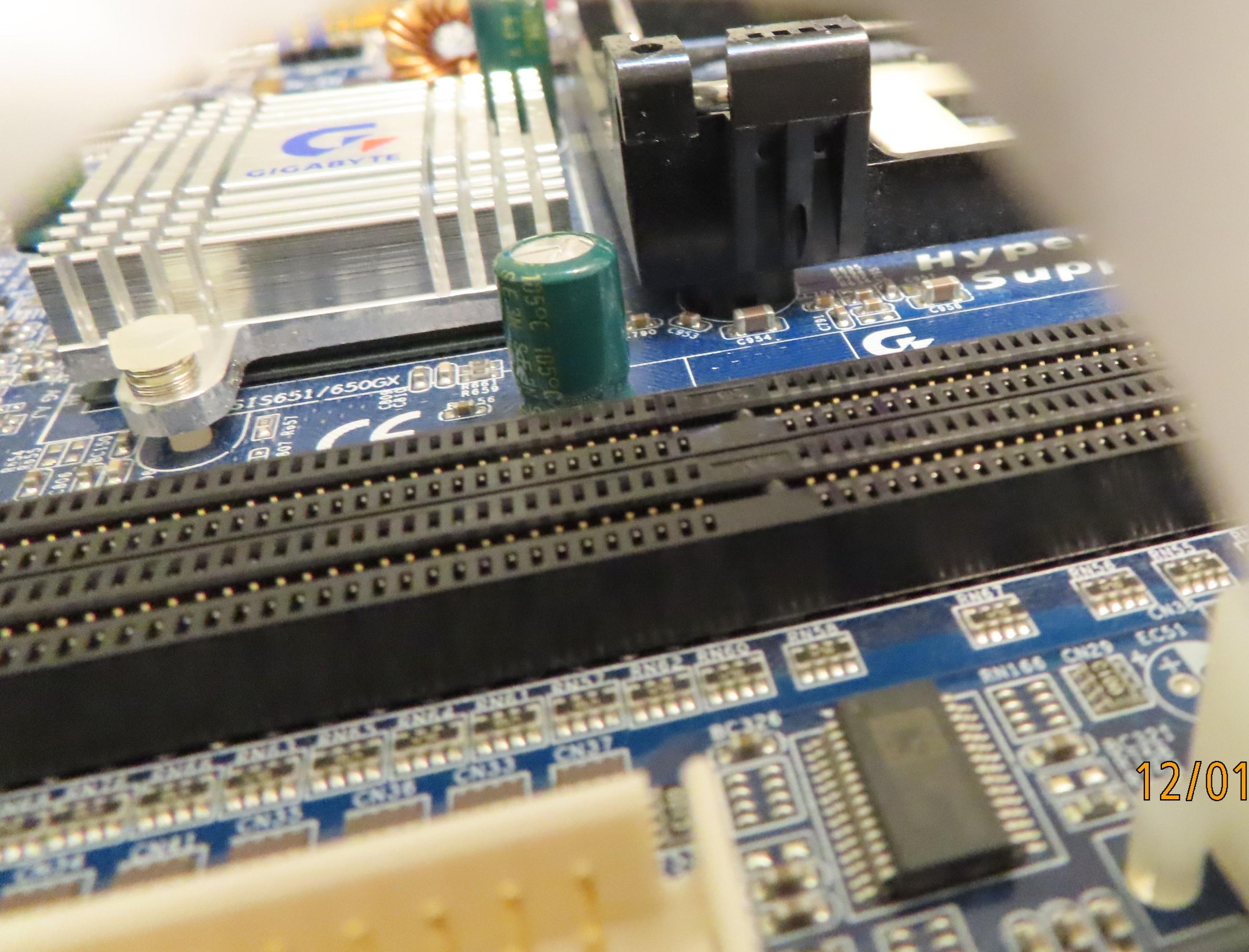

                        I have also discovered bulging Sanyo WG which have been sitting idly on an old P4 motherboard... True, the caps are from 2004, but in light of this it must be said that later HM and FJ/FL were probably superior.
                              WG or WF?
                              WF are known bloaters - same as KZG or maybe even worse. See my post recently here:
                              https://www.badcaps.net/forum/showth...98#post1000498
                              WG I think I've heard of people (Wester547) mention here that these caps had failures before... but generally are reliable overall.

                                        Re: Panasonic FC series - leaking? quality gone?
                                        Originally posted by momaka
                                        WG or WF?
                                        Yes:
                                        I tested the capacity and ESR. One read 1000uF or so and one was a bit under at 800uF or so... But both of them had an ESR of 0.7-0.8 Ohms. For comparison, I tested some 2014 datecode Nichicon HM, they all passed (around 10 mOhm).
                                        BTW, I've been using a few Rubycon YXJ lately for some of my PSU recaps. Seem like a good Nichi PW alternative right now and also quite cheap. Occasionally YXF too.
                                        Yes, great caps... You can get a 6.3V 220uF cap in 5mm with YXJ. YXx like ZLx are both aqueous series. ZLx is probably an equivalent to UCC KZE and YXx to UCC KY and KYx.
                                        Got a slightly better tester here... It's basically the same as your component tester with a programmable PIC chip, but the software gives better resolution on the ESR (up to 1mOhm) resolution... It's a $20 kit, but the PIC chip did not come programmed, so the programmer was like another $5 or so from China.
                                        The motherboard pictured is a Gigabyte GA-8SIMLH.
