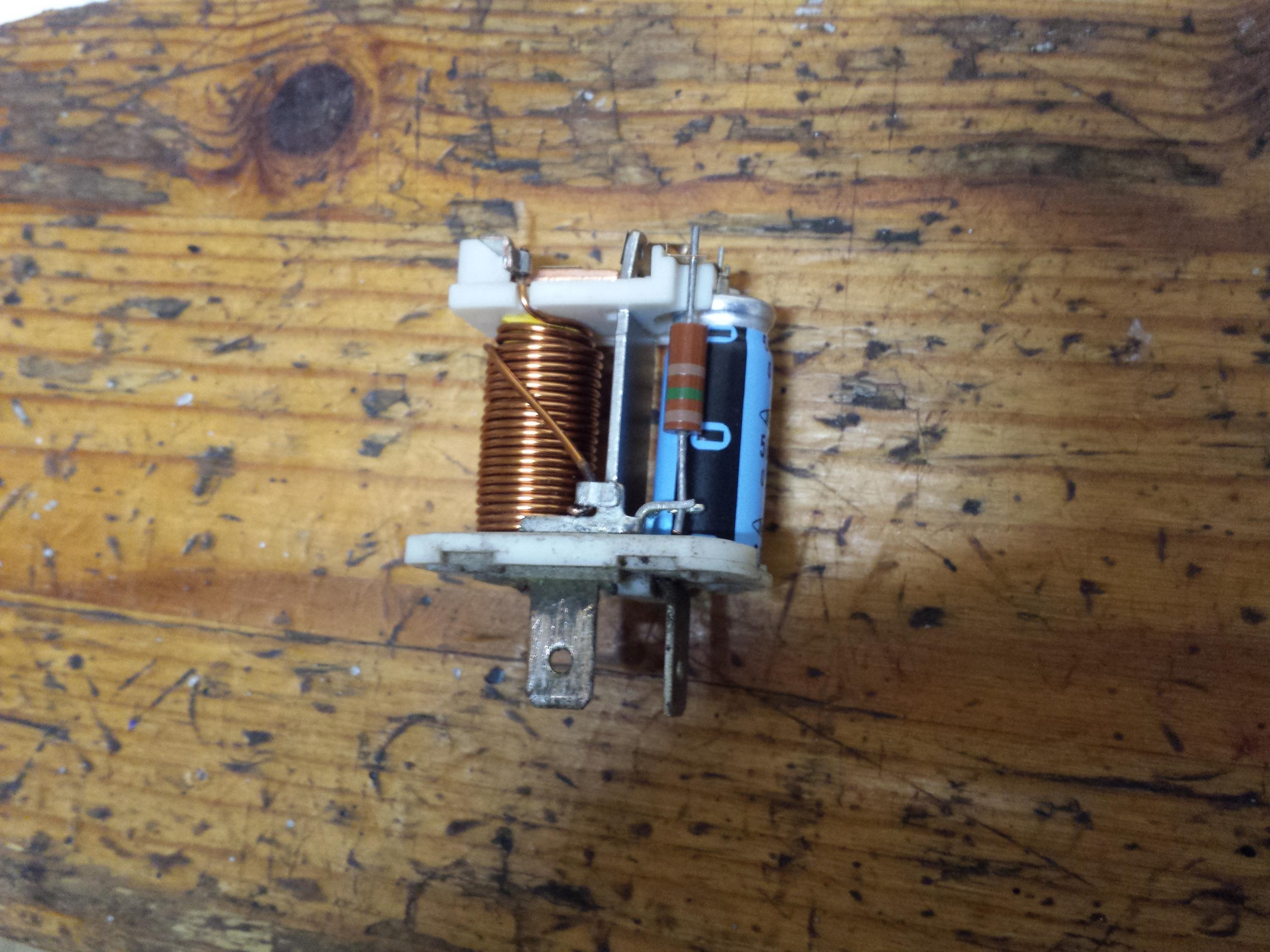

    What value is this capacitor?
    Can anyone identify what value this capacitor is?
    All I know is its 12v.

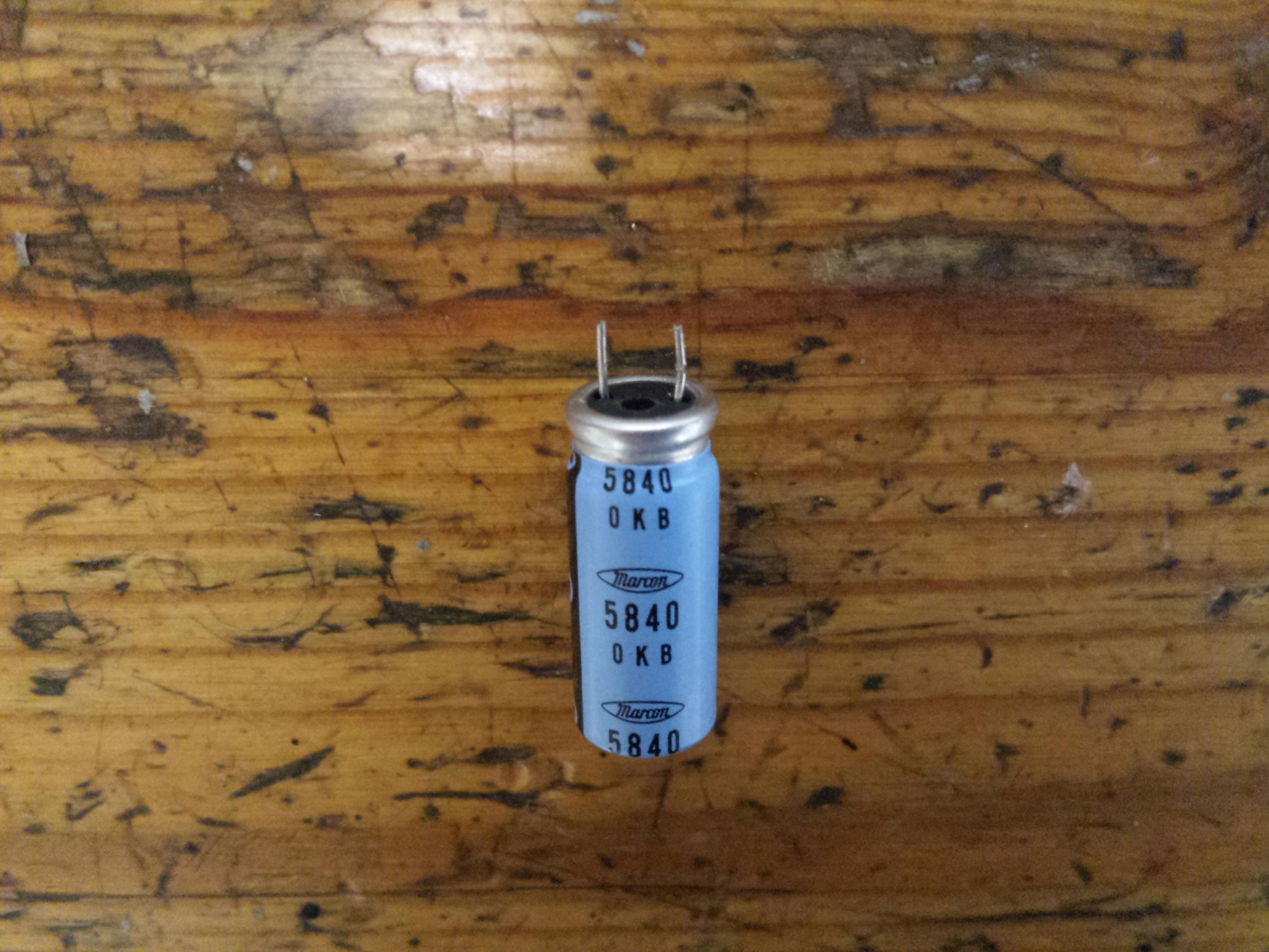

    Re: What value is this capacitor?
    From another site it seems to be a 2200µf/16 volt 10x25mm They used a Panasonic EEUFS1C222L as a replacement
    Other sites call it a 1200µf or 1500µf, the value will change the flash rate, Lower capacity gives a faster flash rate.
    For more information, Google, Marcon 5840
        Its only a old but well made flasher unit off a 1979 hona CX500. Easy to fix so for the cost of 1 cap why not?

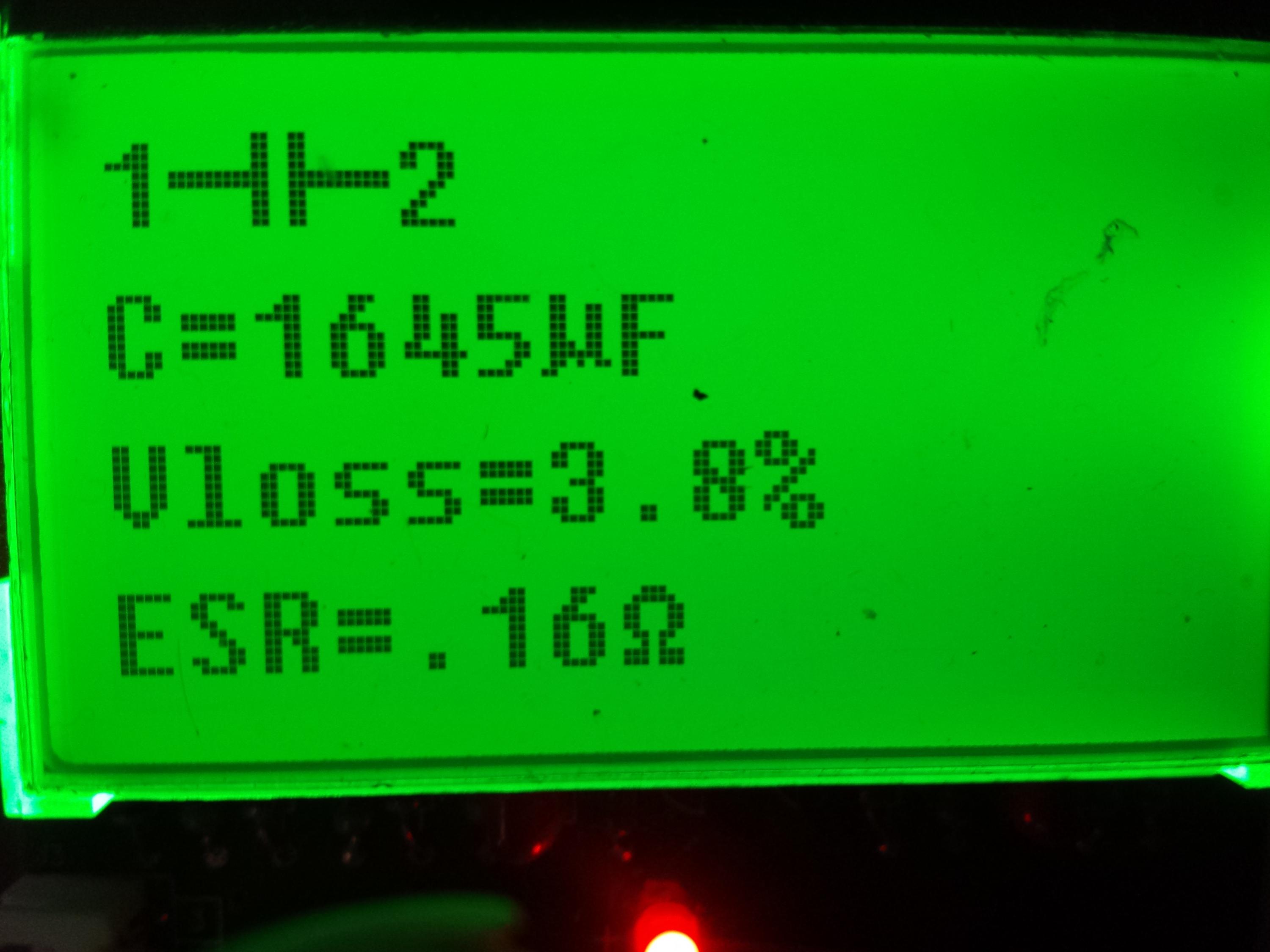

        Sorry to appear dumb but apart from the value being within tolerance i dont know how to interperate what the output from my component tester is telling me about this cap. I know what ESR is but what does all the rest mean and whats it telling me about this particular capacitor?
          • 31213
          vloss is leakage caused by internal resistance
          it can fool a lot of cap meters into thinking the cap has a higher uf, and makes the cap discharge itself faster.
          i'v seen far worse, but a good cap is in the 1.x% or less type of range.

            I know what ESR is but is there a value that you would say is ok and one thats makes it suspicious without having to keep looking at each manufacturers datasheets which is what can be done if its suspicious.
              • 31213
              no,esr varies greatly between series - but the vlos indicates it's fucked.
                  Sorry STJ that was a general question and not just about yhis particular capacitor. So vlos over 3.5% is knackered so is there a max and minimum to indicate whether a cetain cap is good or bad
                    • 31213
                    if it's 2 or more then it's higher than any good cap i'v tested.
