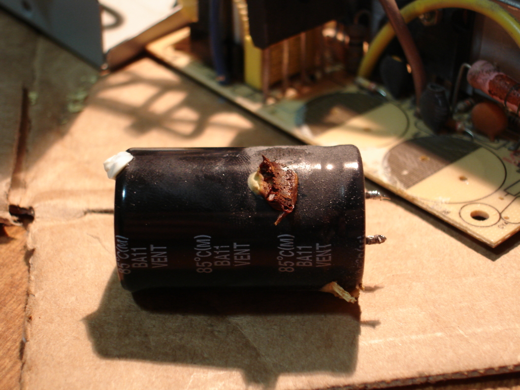

    So the story begins with my sis telling me that the computer isn't turning on after being used the night before. Alight no biggie so far. Press the power button, hear the fans spin then nothing.
    Opened up the case, checked the connections and everything seems to be in order. Tried to turn the computer on again and all the fans spin up then slow down. BUT the fans twitched to a stop. Unplugged everything from the PSU except for the case fans and they spun normally. Cracked open the PSU and behold, blown caps on the +12v line (and possibly the +5v)!
    Alrighty, replaced the blown/bulged caps and the ones for the 5v rail. Put the PSU back together, hooked the necessary components and disappointment ensues. All the fans spin up but slowly twitch to a stop.
    Switched/replaced the RAM around but no difference. No visibly damaged caps on the mobo. Plugged in my own PSU and still nothing! There's United Chemicons, some Rubycons, couple of OSTs and Luxcons.

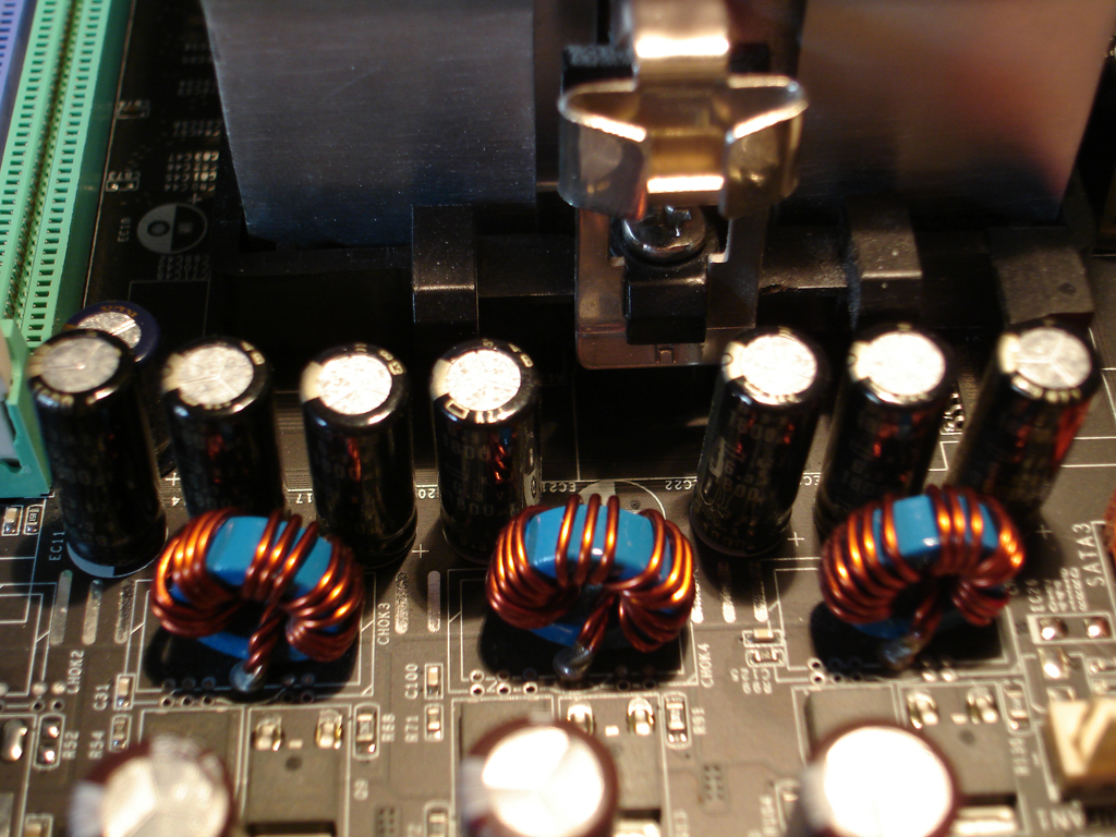

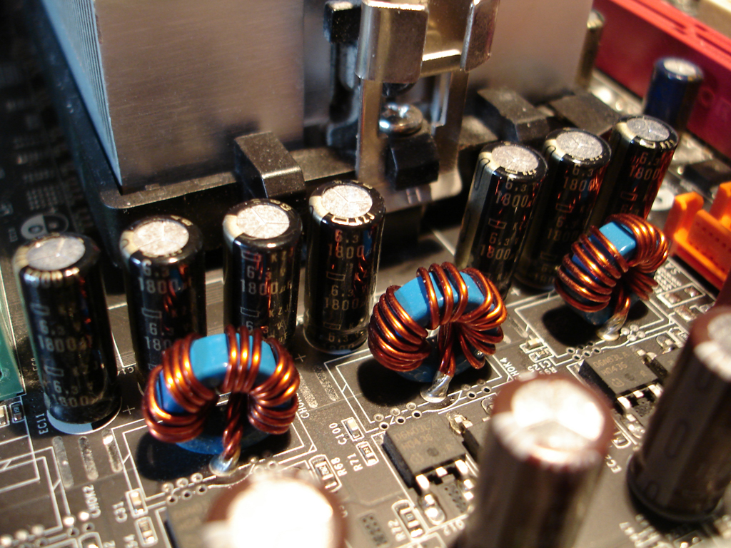

            • Toasty
              • Jul 2007
              • 4171
              Re: Need help on reviving an old mobo

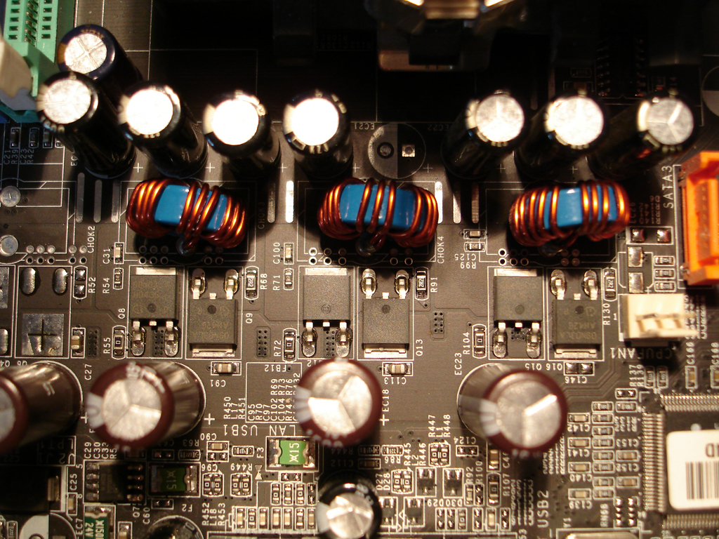

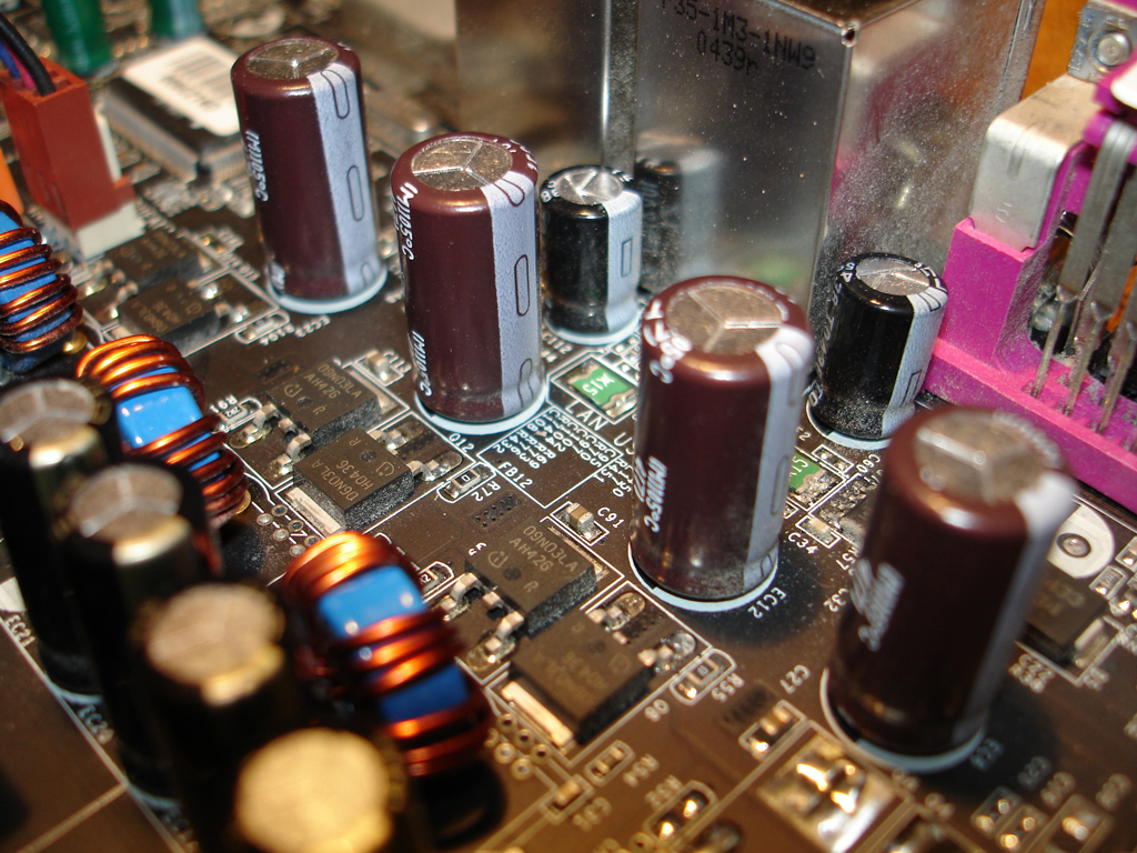

              Could be that the VRM (groups nearest the CPU) caps are bad. The failed SL350 is likely to have been passing the ripple to the mobo for awhile and has caused those caps to fail or weaken. Just because they are not visibly blown means nothing without checking them. Since you'll have to check them out of circuit (they're in parallel), you're better off just replacing them.
              Does anything in the area around the CPU look overheated or discolored?
              There are 8 or 9 caps close by the CPU (Rubys?) and 4 (UCC?) bigger ones back by the peripheral jacks. I'd go after those first.

              • Smellydeli
                • Sep 2009
                • 15
                Nothing looks discolored or burnt around the mosfet area. The 4 big ones and the 8 smaller ones are UCC.

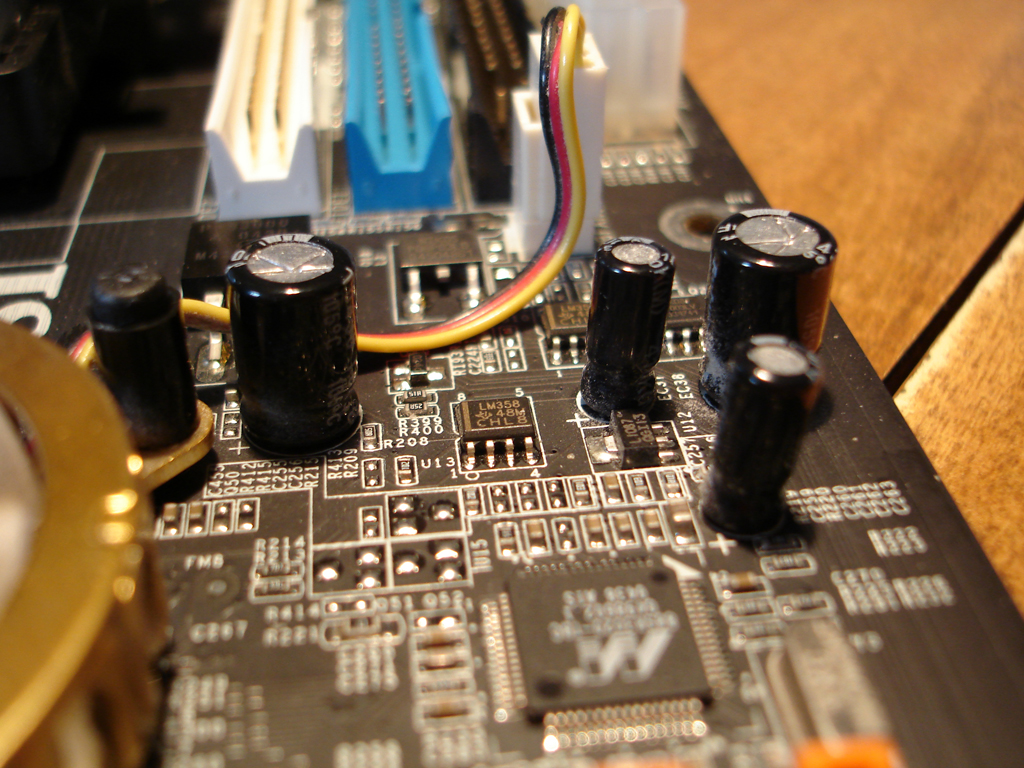

                • lucky13
                  • Aug 2007
                  • 412
                  Smellydeli
                  You getting sidetracked?

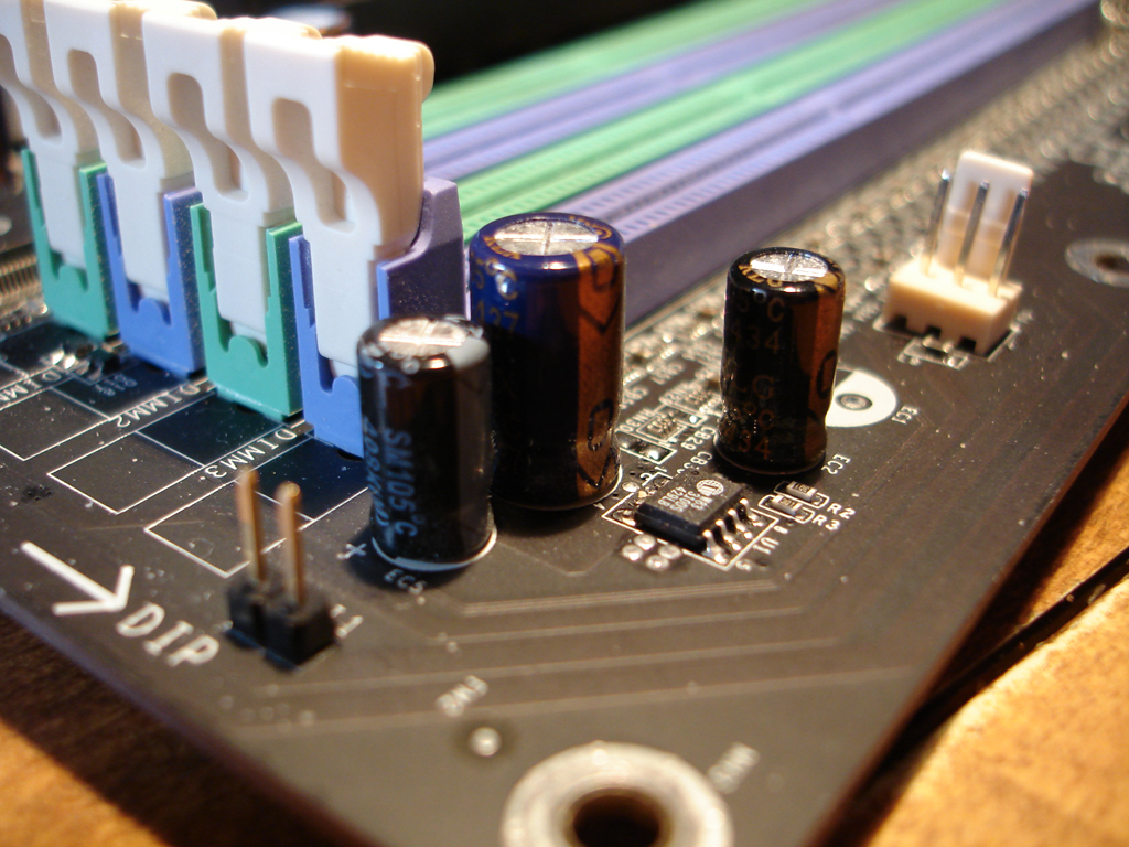

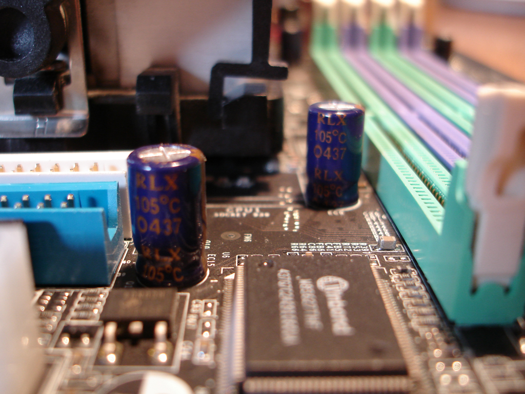

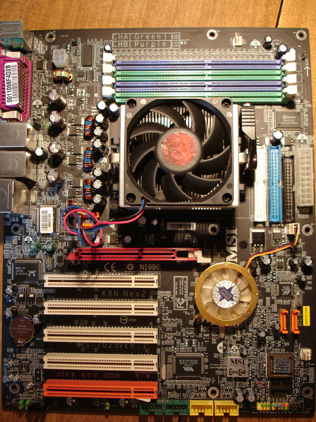

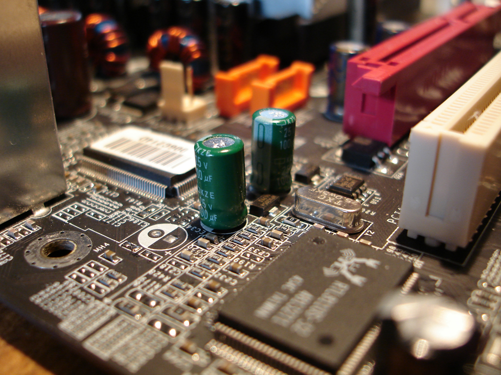

                  Why don't you post some pix of the MSI K8N Neo2 board so we can see if there is anything you might have missed?
                  Finally, have you tried clearing the CMOS (and check the CMOS battery too)?

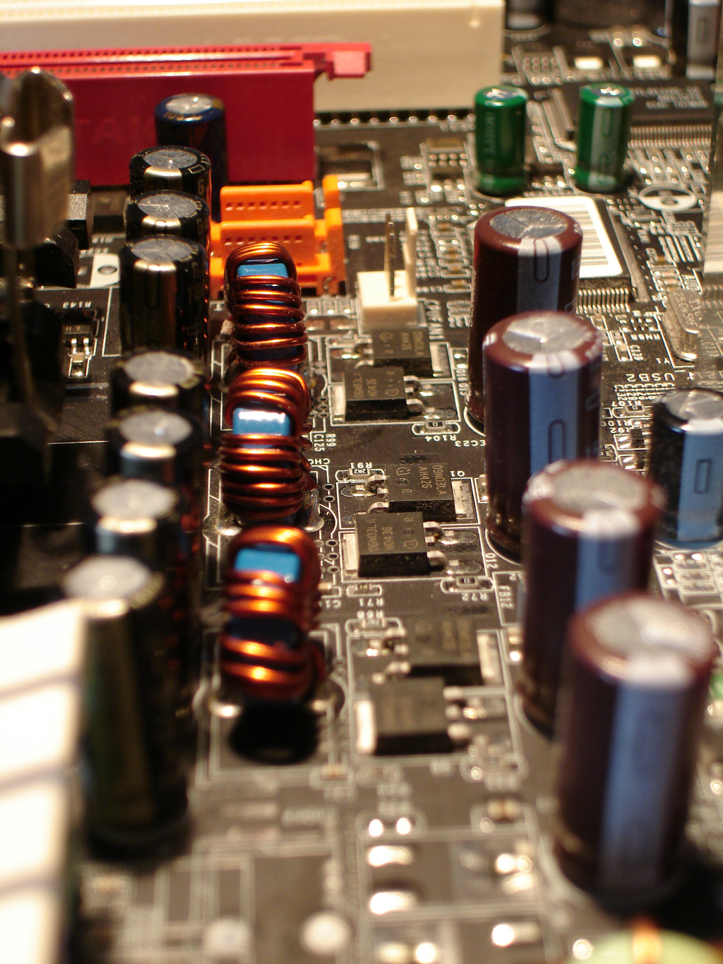

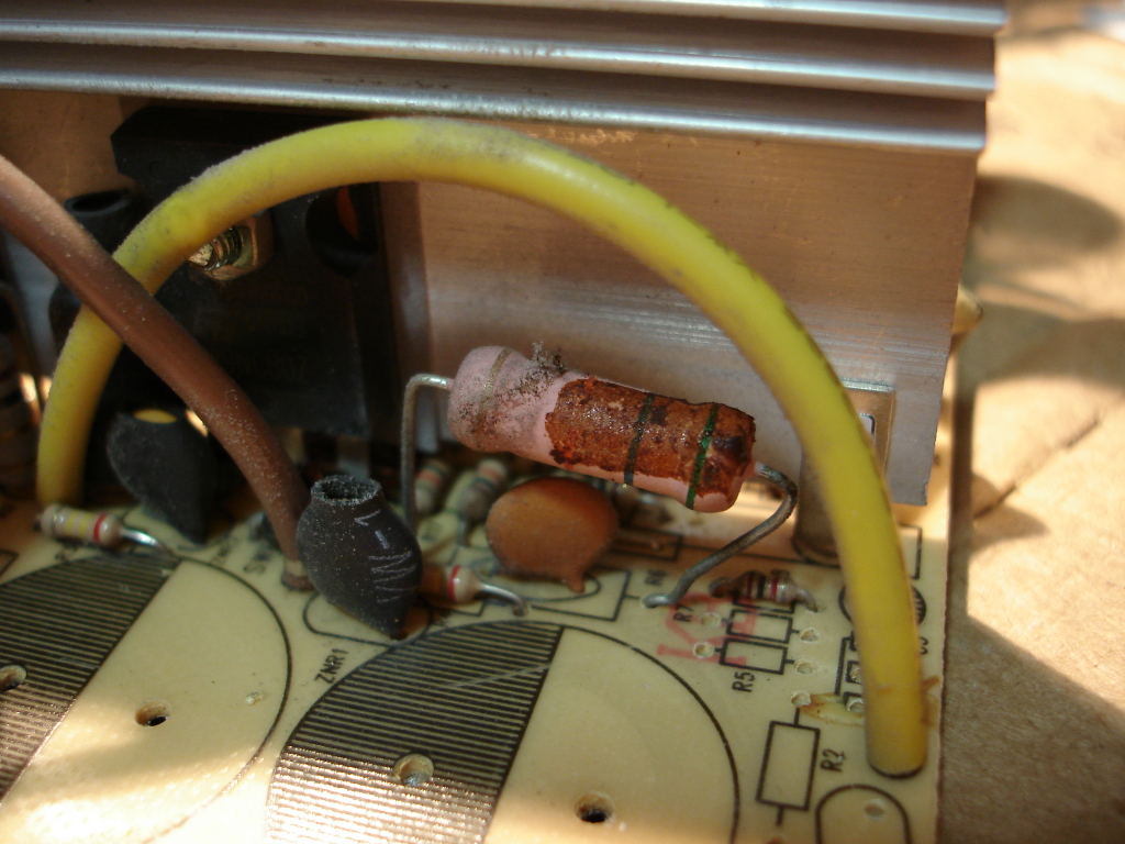

                          • Smellydeli
                            • Sep 2009
                            • 15
                            There's no sound from the speakers when connected the headers on the mobo when there isn't any RAM.
                            The ethernet chips do get unusually hot and the northbridge gets warm when the mobo is just plugged in. I'm thinking that the two 25v caps in between the chips went bad.
                            Those pics are of the K8N Neo2. Now this is the GA-MA790X-UD4P:
                            http://www.shoppingsquare.com.au/ima...ducts/8044.jpg

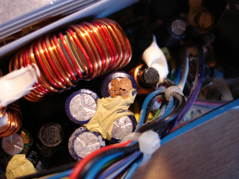

                            I found this when I was removing the caps from the SL350, don't know if it's still okay to use. The cap was glued to the resistor and it seems to have burnt?

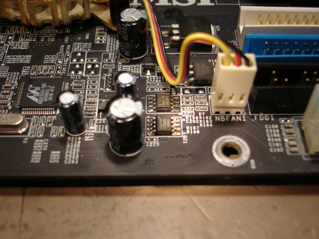

                            • Smellydeli
                              • Sep 2009
                              • 15

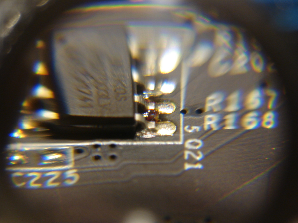

                              The day before, I was checking the ethernet chips with a multimeter and somehow got it to post and get into BIOS. Disabled (or at least tried to) disabled the ethernet chips. Pressed F10, shutdown but didn't restart. Tried jumping the ethernet chip and through trial and error and got into BIOS again, however it shutdown by itself. After that I have been unable to get the fans spin/twitch by jumping the power switch.
                              Was fiddling around again today. First was just plugging the 20-pin and 4-pin and just letting it sit. The ethernet chips and northbridge did get warm and but then after leaving it unattended it became cool/cold.
                              I jumped the green standby line on the 20-pin and the fans started up at full speed and went down as if BIOS was loaded but would eventually stop. Sometimes it would only spin very briefly. During this time there was no video output. As a correction, with the speaker plugged into the speaker header, there is some electrical crackle sound when jumping the 20-pin cable.
                              Looked around under the 20-pin socket and found this. Hopefully it's just rosin.

                                  I had an Antec with one bulging Fuhjyyu, and all the other Fuhjyyus looked fine and showed low ESR. So I replaced just the bulging one, but just one week later, two other Fuhjyyus bulged, and a total of four showed high ESR.
