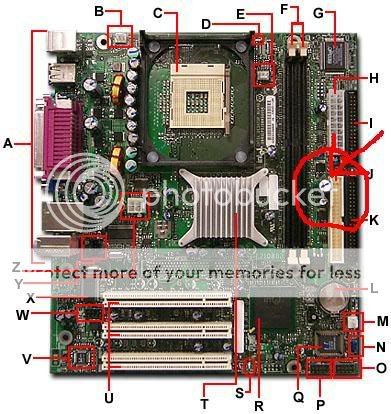

    There is only one solid state capacitor on the entire board, it is an intel d845GEBV2 board. The capacitor reads 1300 6.3v, which I'm assuming is 1300uF and 6.3 volts. It is vented at the top and spewing goo. I have 2 boards with the same problems. It is located between the ram slot and the IDE cable hookup on the side of the board.
    Its that guy right there, mine is a solid cap though, that one looks like a regular one.
    Can anyone give me insight as to a replacement? Low ESR? Anything special? Can I sub a regular cap that I have lying around?

    I found out it is not a solid state capacitor, it is just a regular capacitor without a sleeve. It reads HD 64 or HD b4.

    There are also 3 bulging caps around the CPU. They are 3300uF and say (m)105*c 3(2) 6D
    I'm going to assume they are just regular +/- 20% caps?
    They are Chemicon KZG series

      For the 1300uf 6.3V capacitor I'd say using a good low ESR 1500uf 6.3v capacitor would do fine there.
      You can purchase Samxon and Rubycon capacitors from badcaps.net. Topcat has many different values and sizes of caps for sale so there's a high chance that he has what you're looking for.
