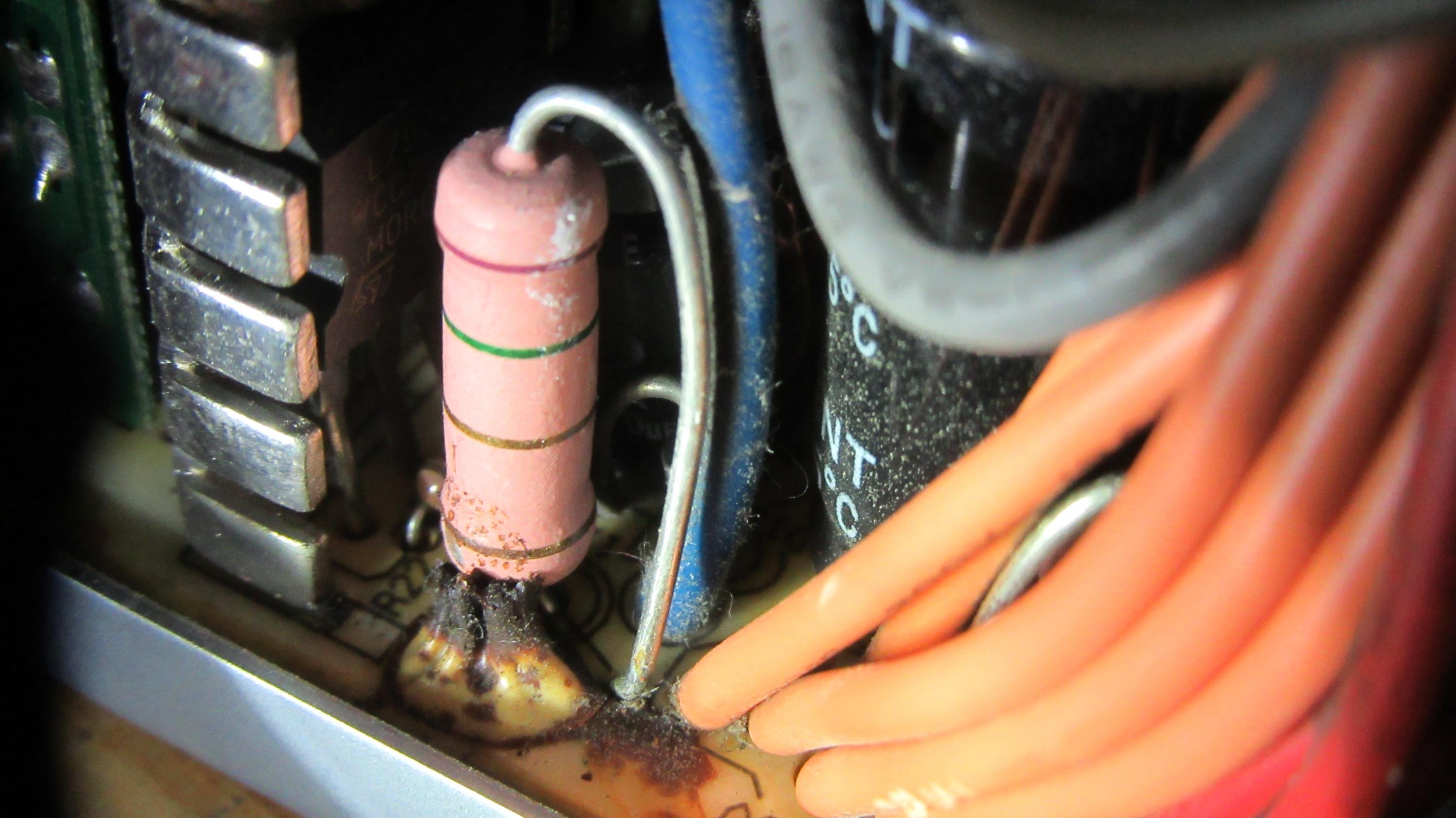

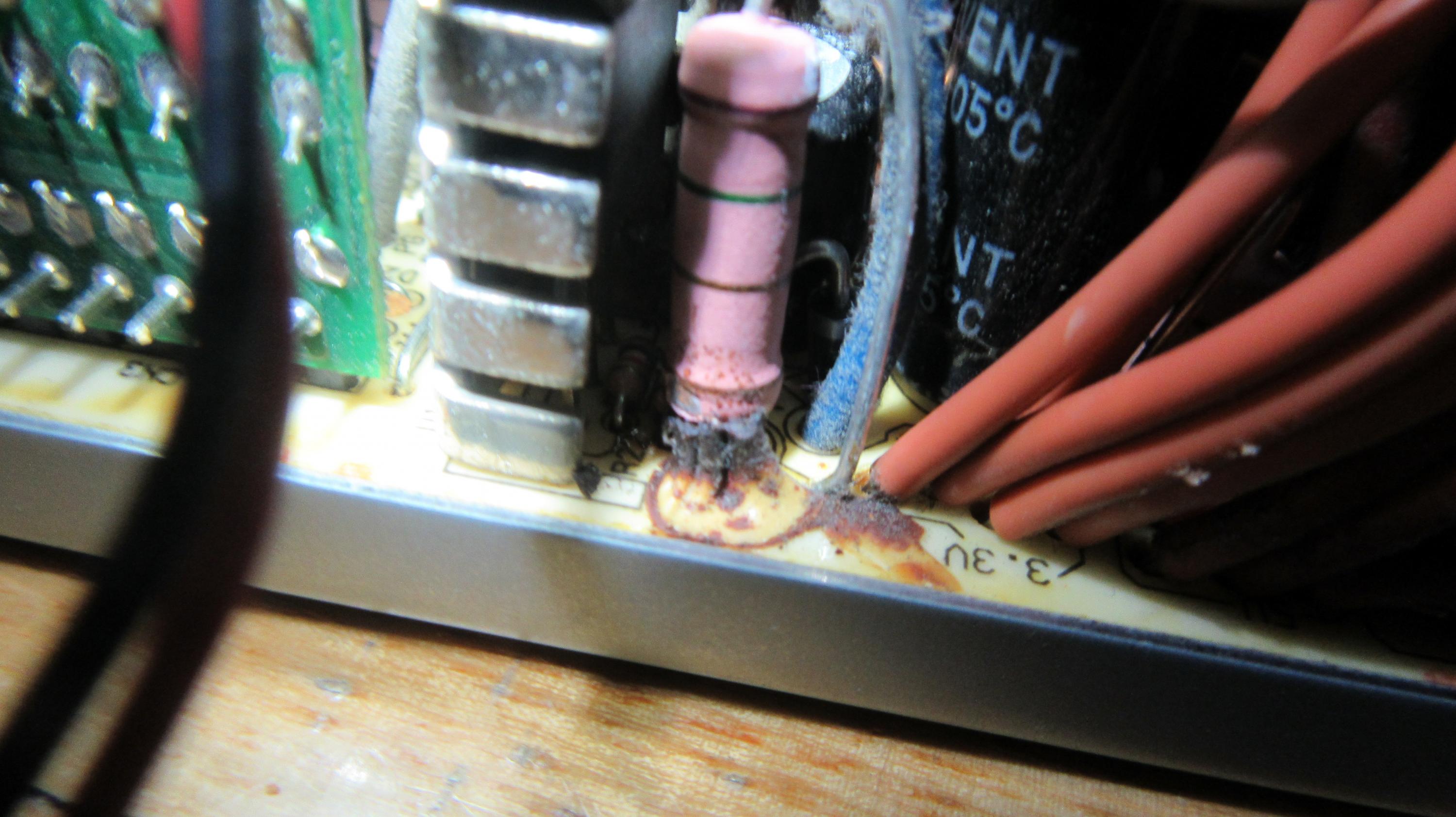

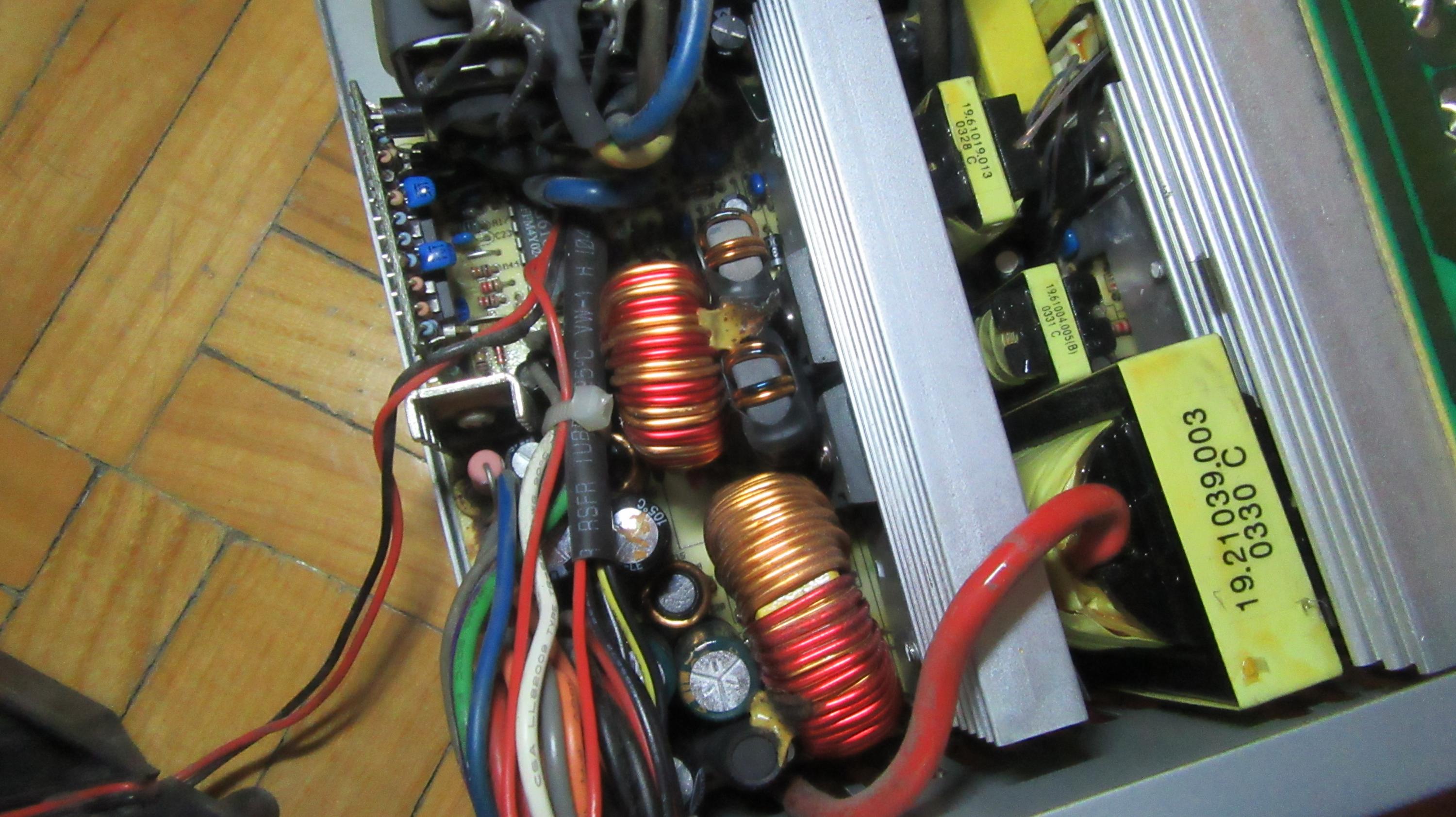

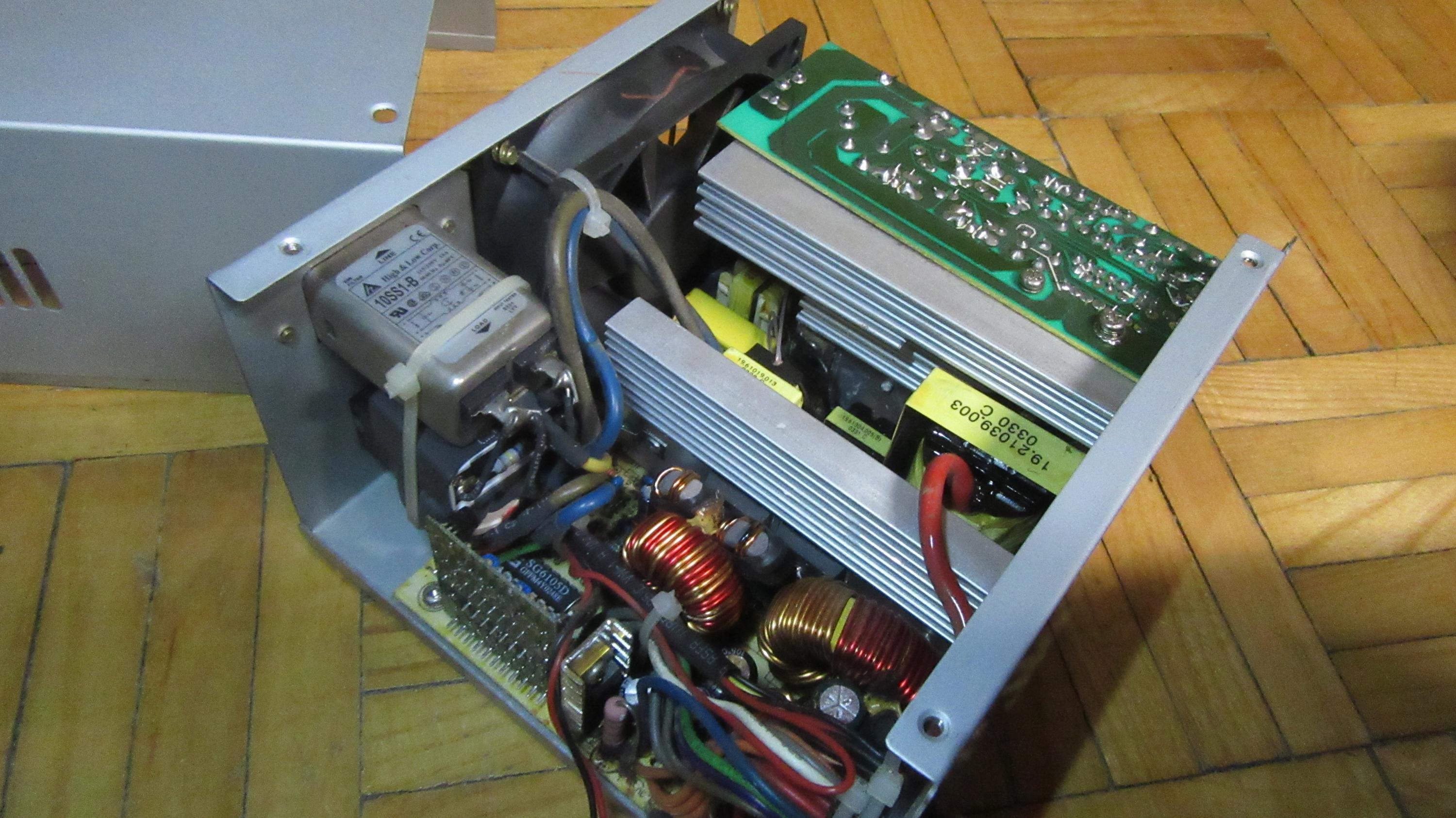

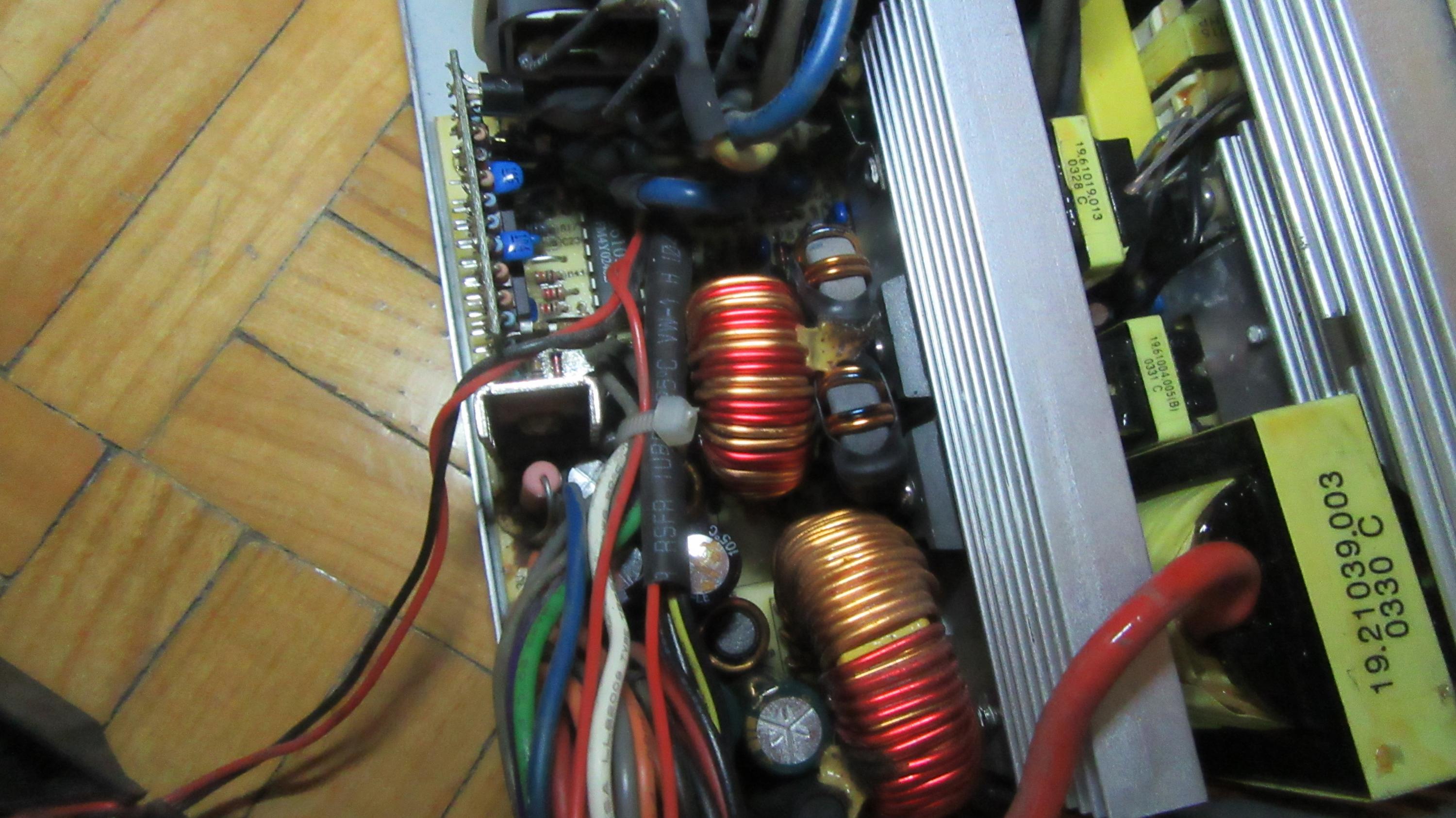

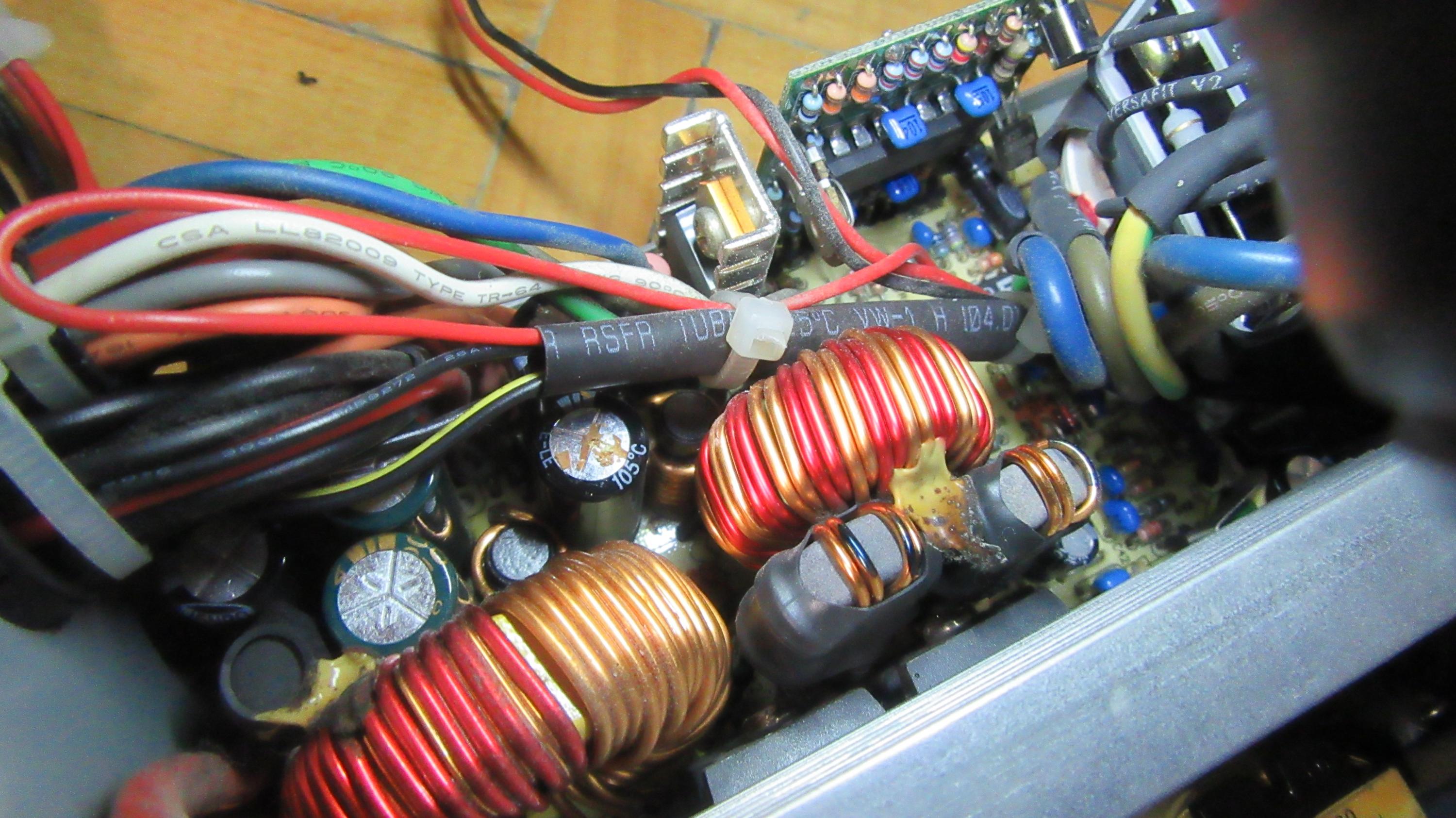

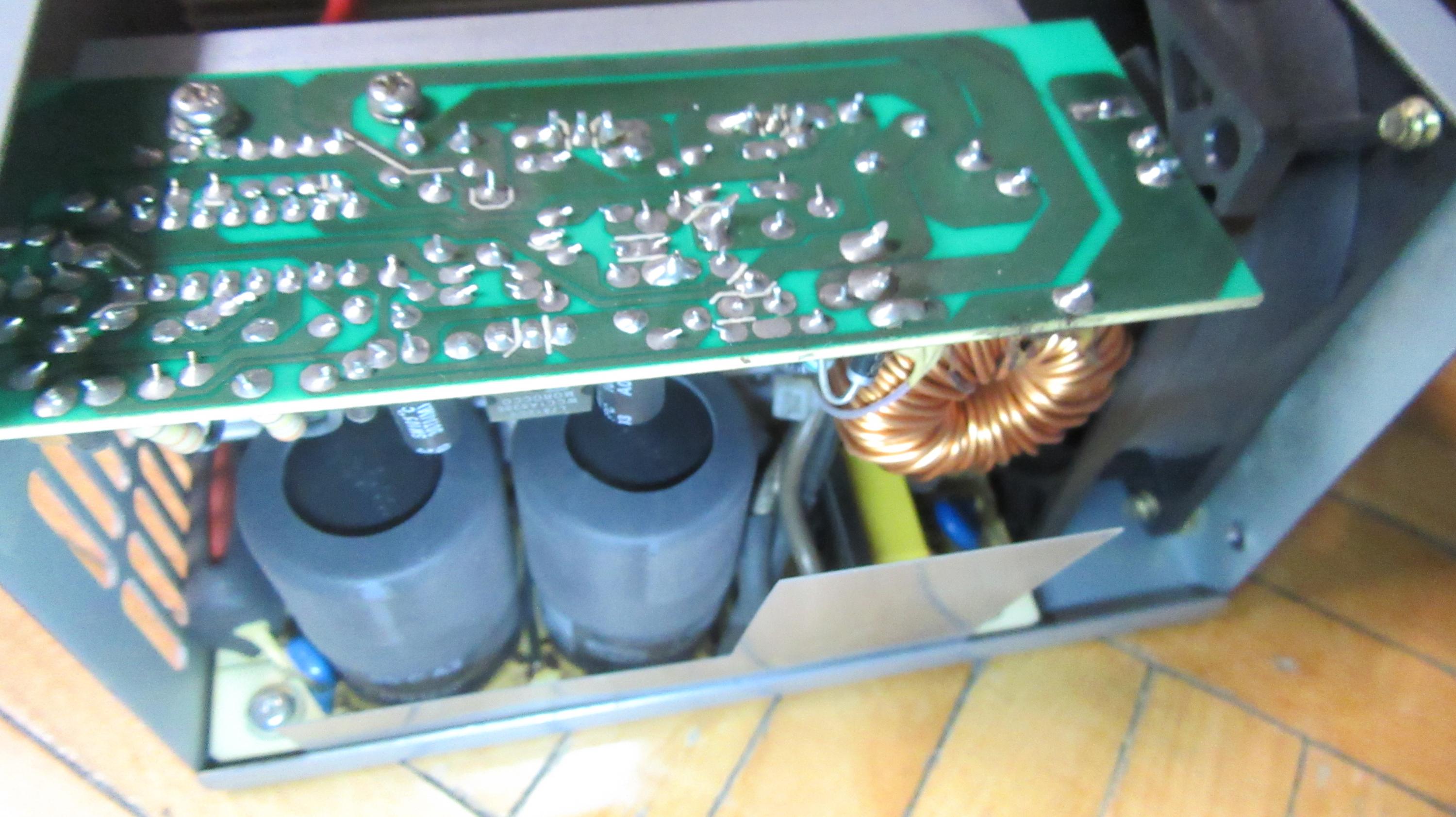

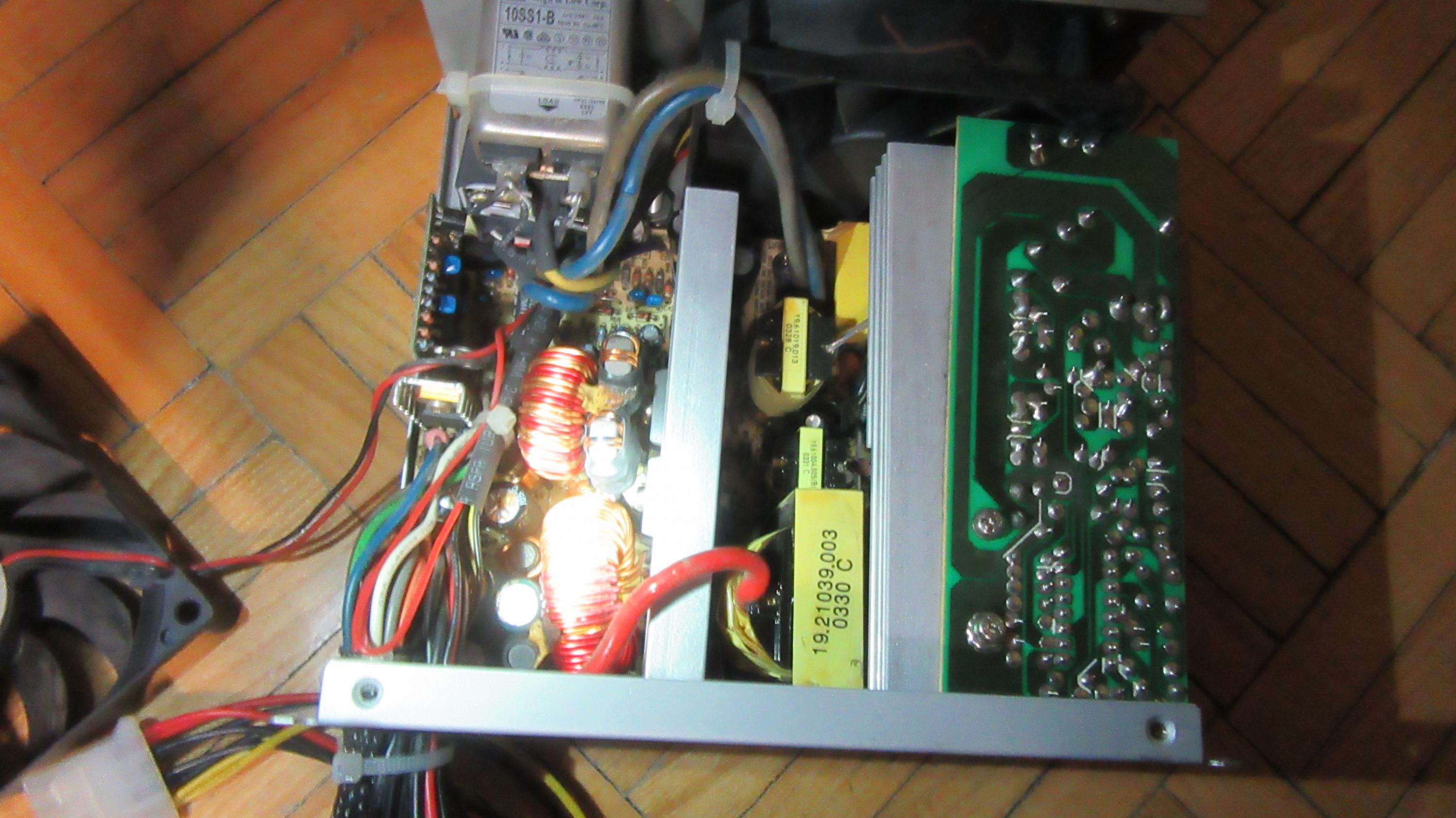

        Since I can't edit my post, I will reply here. I did some of PSU photos, you can see leak on one of Jepon capacitors, and I just noticed something (burn marks?) near the pink thing (I have no idea what is that), is that thing also busted and is it possible to replace it?
        • PeteS in CA
          • Aug 2005
          • 3581
          • USA, Unsure of Planet
          Re: Replacing 8 Caps on motherboard and 2 on PSU - which ones are good replacements?
          The "pink thing" is a pre-load resistor. I think it's
          Red - Green - Gold - Gold = 2.5 ohm, 5%
          or
          Violet - Green - Gold - Gold = 7.5 ohm, 5%
          I think it might be a 2W or 3W resistor.
          While physically damaged, it might be OK. The brown/black is because it gets hot and that heatsink and wires impede airflow while the device on the heatsink is a source of additional heat. If you need to or want to replace it, raise it higher off the PCB by 3-5 mm, as that will reduce heat damage to the PCB.
            or
            Actually when I take second look on PSU the last(?) "ring" on resistor is neither red or violet but brown. Some of camera filters most likely mixed up colors.
                the burned shit is glue - scrape it off.
                  I scraped it off, why was there glue in first place? Now when I look at the resistor the last ring kinda looks like dark violet, my eyes playing tricks with me, I need to look at it with natural light.
                    • 31026
                    the glue was to stabilise the resistor in shipping, you find a lot of this glue in psu's - and you want to get rid of it all.
                    btw, looks purple to me, so 7.5ohms
                      Anyway resistor looks fine to me, so I will leave as it is. I still don't know tho which capacitors should I use for replacement.
                        • 31026
                        lose the glue, it becomes conductive and shorts stuff out.
                          I did it, now I need caps to replace. Which ones available would you recommend?

                              That power supply was probably built in August of 2003. So I'd suggest Nichicon PW, Nippon Chemi-Con LXZ, or Panasonic FC. Those are pretty much equivalents, so go with price and availability.
