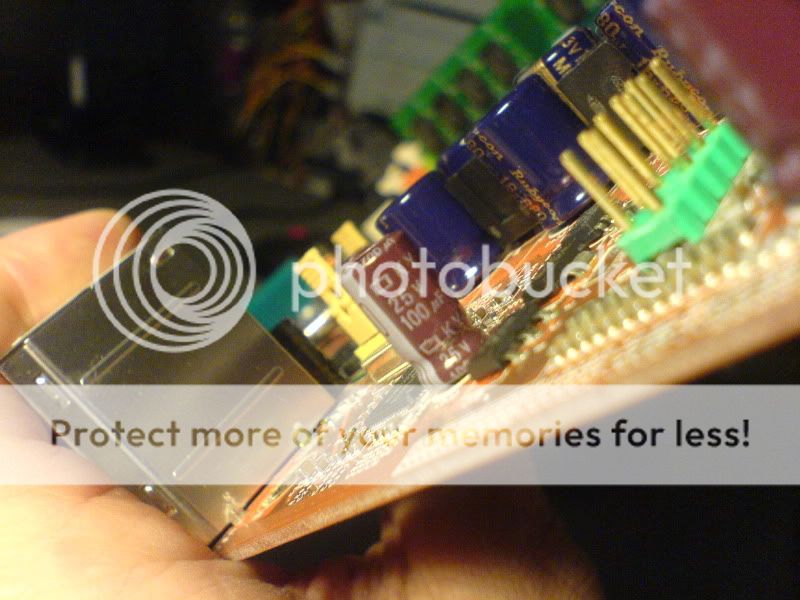

I've been having some wierd problems with a motherboard I was using in a media centre PC. When loading windows it will reboot, and it will really object if I put memory in slot 2. Honestly I can't remember exactly what it was doing with the memory because it's been a few months since i've worked on it.
It did my head in troubleshooting it (I came to the conclusion that the board is cactus) and I haven't used it for 6 months or so when a colleague suggested it may be caps. Considering it was a pretty late model board I had never really considered the caps but it seemed to be feasible. So after a bit of googling and next thing you know here I am
Anyway, so I did a bit of searching on the forum and decided to have a look at the caps on my board. As soon as I saw "Rubycon" down the side 1500uF beauty i pretty much figured it must be something else. All the caps physically look OK as far as I can tell. Most of them are Rubycons, but there are some 100uF 25v caps with a brown casing that have "KY" marked on them. Also, some silver can looking things with blue printed on the top that I assume are caps but am not sure.
Anyway, in short i'm pretty sure it's not going to be the caps but i'd like some opinions of people that have some cap replacement experience!!
Some Rubycons
An example of the "KY" marked caps
Here are some of the aluminium can ones. Are they caps?
It did my head in troubleshooting it (I came to the conclusion that the board is cactus) and I haven't used it for 6 months or so when a colleague suggested it may be caps. Considering it was a pretty late model board I had never really considered the caps but it seemed to be feasible. So after a bit of googling and next thing you know here I am
Anyway, so I did a bit of searching on the forum and decided to have a look at the caps on my board. As soon as I saw "Rubycon" down the side 1500uF beauty i pretty much figured it must be something else. All the caps physically look OK as far as I can tell. Most of them are Rubycons, but there are some 100uF 25v caps with a brown casing that have "KY" marked on them. Also, some silver can looking things with blue printed on the top that I assume are caps but am not sure.
Anyway, in short i'm pretty sure it's not going to be the caps but i'd like some opinions of people that have some cap replacement experience!!
Some Rubycons
An example of the "KY" marked caps
Here are some of the aluminium can ones. Are they caps?
