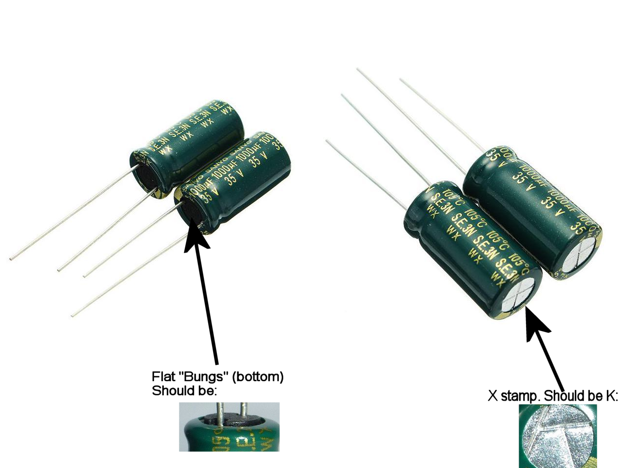

    Newegg selling fake caps
    https://www.newegg.com/Product/Produ...9SIA6RP7TS4224 (well it's the 'marketplace')
    seriously? no K stamp on a sanyo. and $42?

      Re: Newegg selling fake caps
      Originally posted by Topcat
      phony bologna....from Israel...
      There are shills in every country. Newegg marketplace has always been rife with this sort of crap. Here's one from USA:
      https://www.newegg.com/Product/Produ...6014-_-Product
      Buyer beware.
              Oh NewEgg, what has become of you!
              Actually I just used their marketplace not too long ago to buy some stuff. Technically I could have used eBay (and it would have been cheaper), but I had a gift card with a few $$ to finish off, so figured why not.
              Basically the NewEgg marketplace has pretty much the same crap as eBay and AliExpress, but for higher prices... and with a much shittier search engine (seriously NewEgg, your search engine is useless ATM!)
              ...seriously? no K stamp on a sanyo. and $42?
              That's 20 cents per shit cap!
              Sure a 35V 1000 uF Jap cap from Digikey or Mouser will probably run you close to a $1 or more... but at least it's not going to be some volatile turd that spoils as soon as you open the bag.
                  I reported it to thier investigation team, as 'fraud'. Included attached image.
                  They asked what company I worked for and what proof I had. Did nothing.
