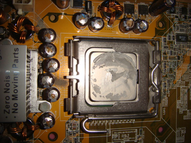

    Recieved this dead system from someone i know. It doesn't boot, but the green LED at the bottom of the motherboard lights up when connected to power (ASUS).
    When i power it on, fans spin, and all seems fine except there is not video. Taking the CPU off, i all of the VRM capacitors had blown.
    All ten of them seems to be blown, so im guessing this is the problem. Besides, the user ran it 24/7 other than occassional restarts since 2005.
    Checking the specs of the capacitors, i found the following:
    'Elite' brand
    105C temp
    680uF
    4V
    it's also pretty stout (short enough to avoid hitting the heatsink fins)
    Unfortunately, i can't seem to find anything can is the same spec (different brands), other than DigiKey which overcharges like crazy.
    Is there any good substitute for this? Also, can i be pretty well assume the caps are to blame?

    >>other than DigiKey which overcharges like crazy.<<
    I don't understand that statement at all. Overcharges for what or how? Please explain.
    Caps are 99.44% probably to blame.
    What SERIES are the Elite caps? Only way you can compare apples to apples. Look on side opposite values for a 2 letter code like EL, ED, EB, PS.
    What ASUS board is this?
    Check PSU also for similar problems. Its model & brand also.

      I don't mind paying for the caps, but 8 bucks for shipping is a little steep for me. Unless I am wrong that is, as I have only ordered once from a electronic component website. If 8 bucks is the standard for shipping from retailers, then I'll go for it. (Bah, why am I still complaining)
      For the type, it says something like EM(M)105C.
      It's on a ASUS P5P800, and I have tested it on different PSUs, and it all does the same.

        Depends on shipping method you choose. I think it defaults to UPS, and $8 is kinda standard to residential for them. By USPS Priority Mail, my last order was $5. Mouser was more, but the order was much larger.
        I was not asking if you had tested on different PSU's, I was asking you to check the PSU it WAS running on for 4 years. It may have similar issues and posting the model & brand helps. It needs to be opened and checked.
        >>For the type, it says something like EM(M)105C.<<
        series(tolerance)temperature = EM 20% 105°C
        EM Datasheet:
        They do not list a 4 volt cap in that series. Probably dropped it. Because of that, I'll need dimensions of diameter & height in mm's.
        I would likely replace all of those failed ones with solid polymer caps either 560uF or 680uF. Low ESR and superb ripple filtering. Look for 560uF or 680uF Sanyo OS-CON SEPC Polymers. Ask Topcat thru the online form here: https://www.badcaps.net/pages.php?vid=23
        Or, search eBay (careful of fakes) or Google -> Sanyo OS-CON SEPC Polymer
        What brand/series are the other caps on that board, particularly those near CPU & RAM?

          I checked the PSU with a multimeter, both under load and idle, voltages are fine.
          The height of the caps are around 8-10mm, diameter is around 6mm
          The other caps surrounding the RAM and CPU are(they seem fine):
          1x OST 1500uF 6.3V RST 105C
          4x Elite 8B k(M) 105C 1000uF 16v
          Then i have 2 bulging ones around the northbridge:
          Can't really see brand (green and gold with oval logo), but it's LMB105 (M) 6.3v 820uF
          • kc8adu

            i use sanyo sepc 560@4v to replace those.all ost,elite and lelon/ltec need to go too.
            i have recapped a ton of these for customers and have yet to have one not work after recapping.cheap lytics onder the hsf being a very bad choice is an understatement!

                Can i replace 6.3V 820uF capacitors with a 6.3V 1000uF? Or is that out of tolerance level?

                  yes.
                  i do this often.

                    Well, I bit the bullet, and ordered10 Sanyo SEPC caps (no spares, because I live life on the edge), and 5x 6.3v 1000uF capacitors last week. Now fast forward to this week, it arrived.
                    At first, I thought the main concern was the VRM capacitors, which i replaced promptly and tried to boot the mobo up... no POST... I was scared like s***less. Feeling hopeless, I replaced the other 2x 820uF capacitor as well(without much care), and much to my surprise, it booted up!
                    Now i have a living PC again thanks to you guys. And a lesson learned as well: the smallest details can make the largest difference.
