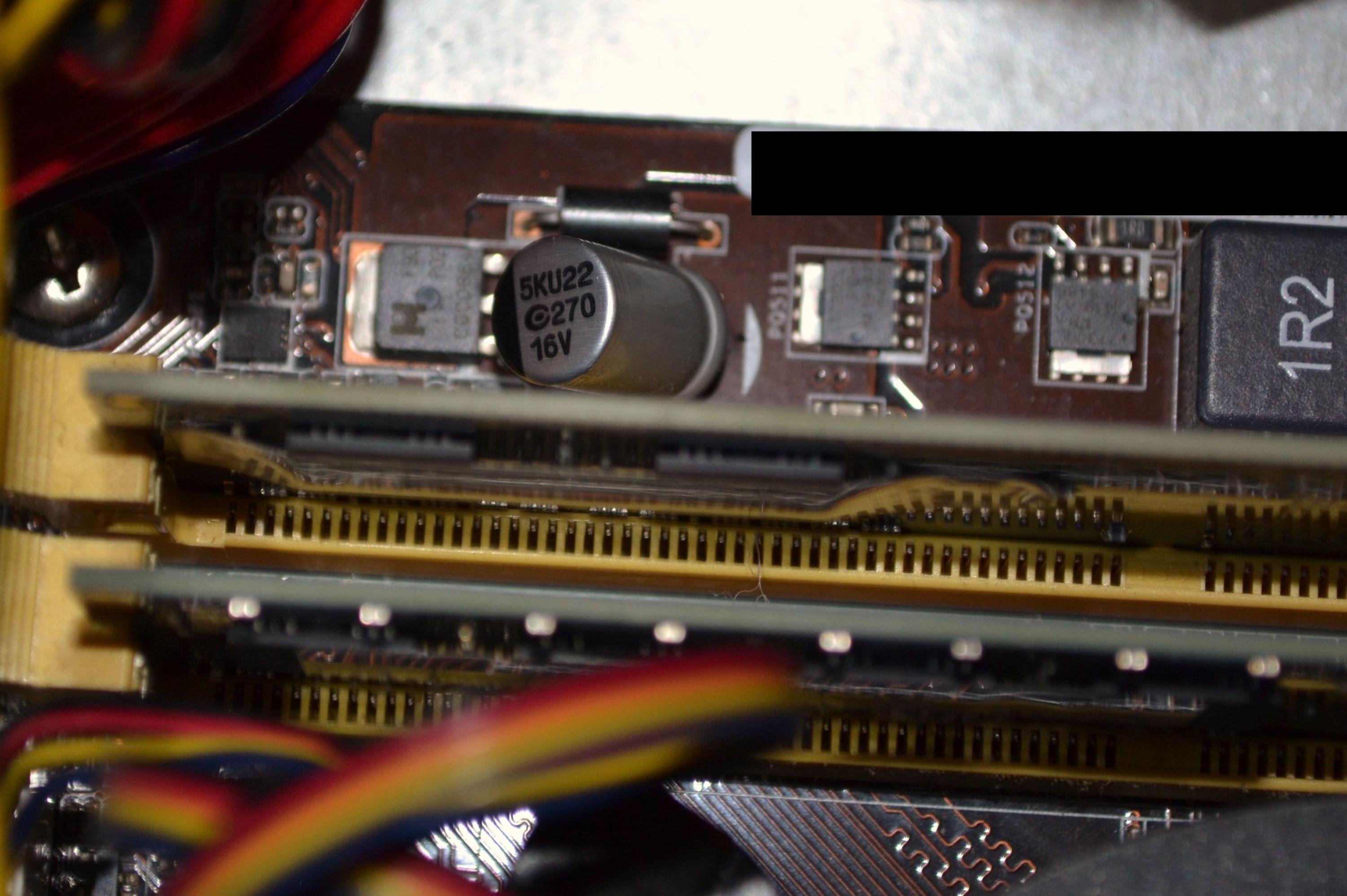

    Hello to all who read this,

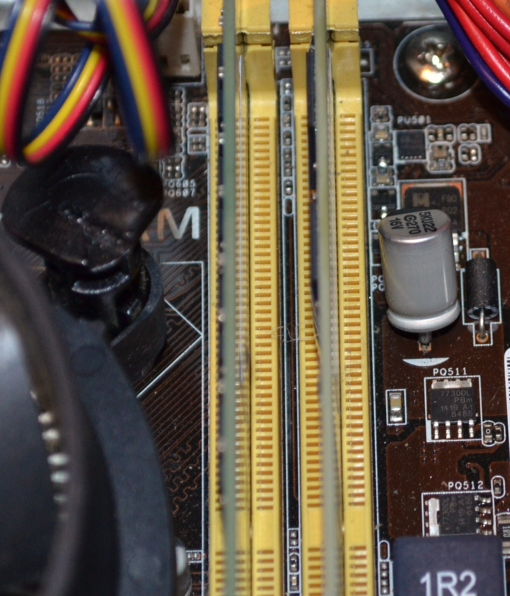

    Friends PC stopped working and I found this motherboard capacitor at an angle with one of its legs pushed out. Is this a known failure mode for these capacitors? He swears it hasn't been knocked. Wiggling it does confirm that the capacitor body is separate from the exposed leg.
    The PC model is ASUS M11AD and motherboard is h81m-a_dp/m11ad/dp_mb.
    The capacitor in question has "5KU22 270 16v" printed on it and is through hole 8mm wide by about 10-12mm high (hard to tell exactly without removing it). Not sure about lead pitch as I haven't removed the board yet but 3.5mm seems to be common online (will check before purchasing).
    I'm having trouble identifying this particular capacitor model to find its datasheet, is it actually a polymer or some other kind? Can I use a regular low ESR electrolytic or does it need to be this same style?

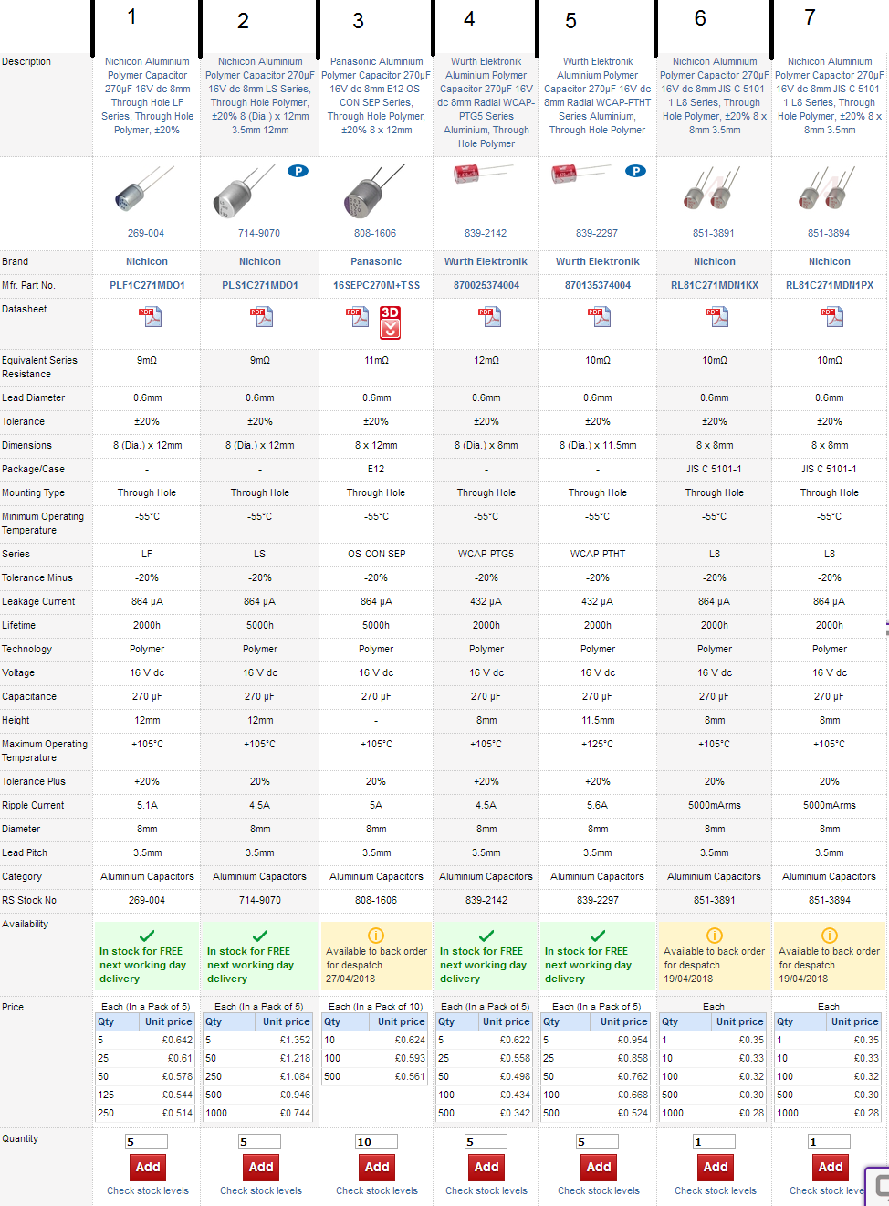

    I've sorted a short list on RS components but there seems to be a varying mixture when it comes to lifespan hours, some rated for 2000 hours whilst others are 5000 (they all appear to be low impedance at 100khz).

    1. its an apaq polymer. asus luvs using that brand for its mid and low-end boards.
    2. NO. the ram *might* become unstable. i've had junk caps make ram unstable on some of my boards.
    3. it depends on how long your friend wants to use the board for before upgrading his computer and how long he uses the computer each day. if he only needs the computer to last for a few more years before upgrading to a better computer and/or he only uses the computer for 12 hours a day, then get 2000 hour caps. cheaper too.
    if he intends to use the computer till it breaks or he leaves the computer running 24/7, then get the 5000 hour caps.
    4. and 5. suitable replacement series are chemicon psc or psf series, nichicon fpcap L8 or NU series, panasonic oscon sepc series.
    6. the cap is right next to the dimm slots, so its not uncommon to accidentally bump or knock into them with your fingers when installing the ram sticks. (fat-fingered user error?)
    its also possible overheating caused the leg to come off from inside the cap. i've had some caps come off with the legs still stuck to the board when i overheated the cap while desoldering the cap.
    its also possible a mosfet shorted and overheated and passed the heat to the nearby cap and overheated the cap also.
    lastly, asus marks the polarity in opposite fashion compared to others. so the shaded side of the cap silkscreen circle is the POSITIVE terminal of the cap! take note of the polarity of the old cap and be careful of the polarity when u solder the new cap on!
      Thanks, I've compiled a shortlist on RS components and will include it with the post. As you can see there is a bit of a stock shortage right now with some of the more desirable caps, looks like I'll have to make a compromise or wait a while.
      Well he swears that nothing was touched, the PC was store purchased and still stock.
      Out of the caps that are in stock which would be the best bet? The original cap had an esr of 10mohm and ripple current rating of 5.2 amps.
      I've put numbers above them to make it easier to pick out. 5 does have a slightly higher temperature rating than the others so maybe that'll offset the 2000 hours a bit, number 2 is 5000 hours but the ripple current rating is 700mA lower than the originals.

        Any of those will work, I'd go with Nichicon or Panasonic.
        Ignore the temperature bit, the VRM for the memory won't be hot so the capacitor won't heat up ...
        For polymer capacitors, the lifetime is calculated with formula L = Lo x 10 ^ [(Tm-Ta)/20]
        So a 2000h@105c cap being warm at 65v all the time will last for 2000 x 10^[(105-65)/20] = 2000 x 10^2 = 2000x100 = 200 000 hours of operation until the capacitor will still work, but will be degraded by some amount (like 20% less capacitance, 10-15% higher esr, stuff like that)

          Update: Its alive! Funny thing is the blown cap wasn't actually the cause of the PC problems, it was seemingly running with it half hanging off the motherboard! I guess the smaller ceramic capacitor in parallel to it was just enough to keep the 12v>RAM voltage (1.5v?) switcher stable.
          I actually went with the Wurth Elektronik 870135374004 in the end as the ripple and maximum temperature specs were a bit better https://uk.rs-online.com/web/p/products/8392297/
          Haven't tried this brand before so only time will tell.
