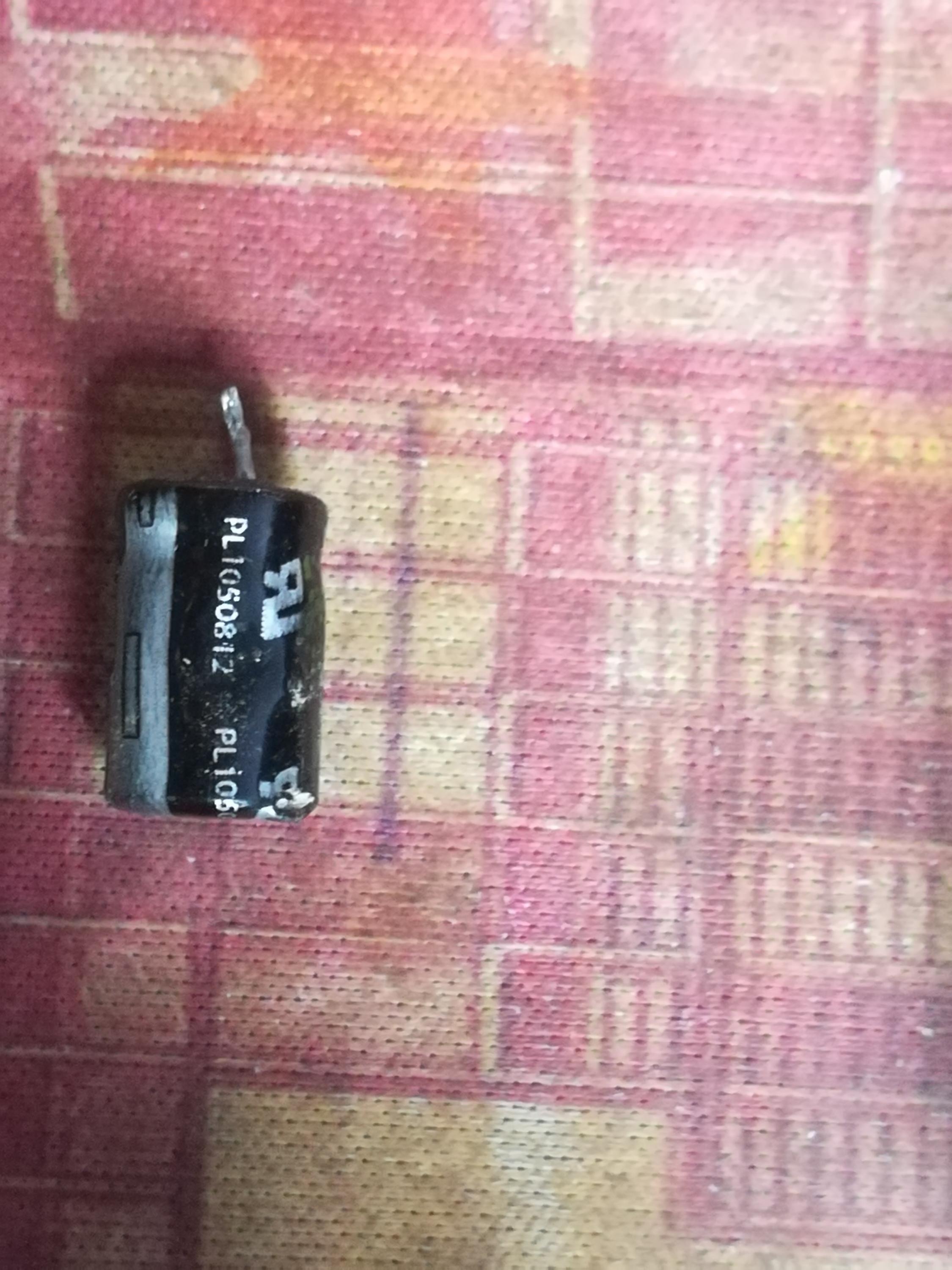

    i need help identifying the value of this capacitor?

    Re: Capacitor Identification
    more pictures needed.

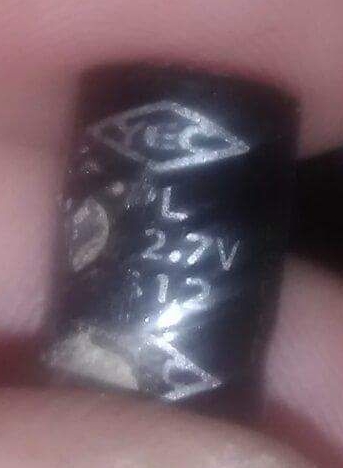

      Here is another one..
        possibly this?
          1.2 Farad, 2.7? Double layer carbon type?
            looks right, got the datasheet?
              Haven't got datasheet it is for a has got external HDD enclosure..
              I thought it might be a 2.7v 81.2 farad?
                Found it using the PL number it is 2.7v at 1 farad
