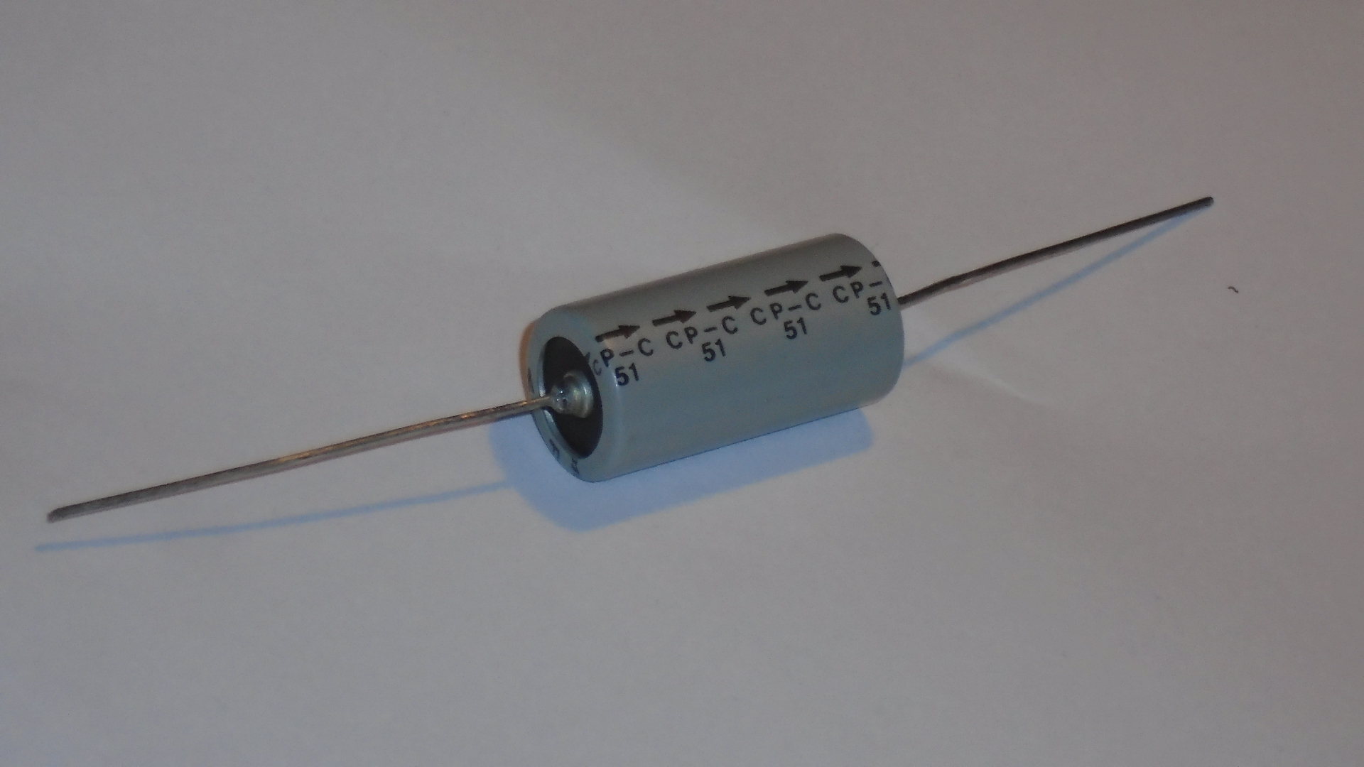

    I did find some nice stash of pretty old Rubycon capacitors, type is unknown to me. Certain quantity I bought almost 20 years ago, they look as normal electrolytic but I was told that those are bipolar non-electrolytic. Any idea what type/dielectric is in question? Are they any good for audio application in valve amplifiers, or shall I discard them as worthless ancient junk? Any answer will be highly appreciated.
    Cheers, Mladen

    The arrows on the capacitor suggests that this is not a bipolar capacitor. As for the type of capacitor, i would say it's a electrolytic based off of it's shape and the arrows pointing at one of the legs (most likely the negative leg.)
    That's hard to say, for one thing do the caps even work? If not then you're better off getting rid of them and buying new. If so then the next question would be should you use them. A lot of people would tell you to get brand new capacitors because you don't know how long those old capacitors last if you did use them, because as a capacitor ages the chemistry of the electrolyte can change which can cause the capacitor to fail prematurely (but that's not always the case.) you may also want to reform the capacitors before use. (There's a thread you can read about how to Recondition (reform) electrolytic capacitors somewhere on this site)
    I hope something i said will help you.

        Not really. Could just describe the best orientation. Although non-polarised caps can accept voltage in both ways, even those have a better orientation with less noise (or something) for audio circuits. Old caps had that, newer ones don't. Most ppl do not even know that, these nuances are what differentiate the best audio gear from the rest

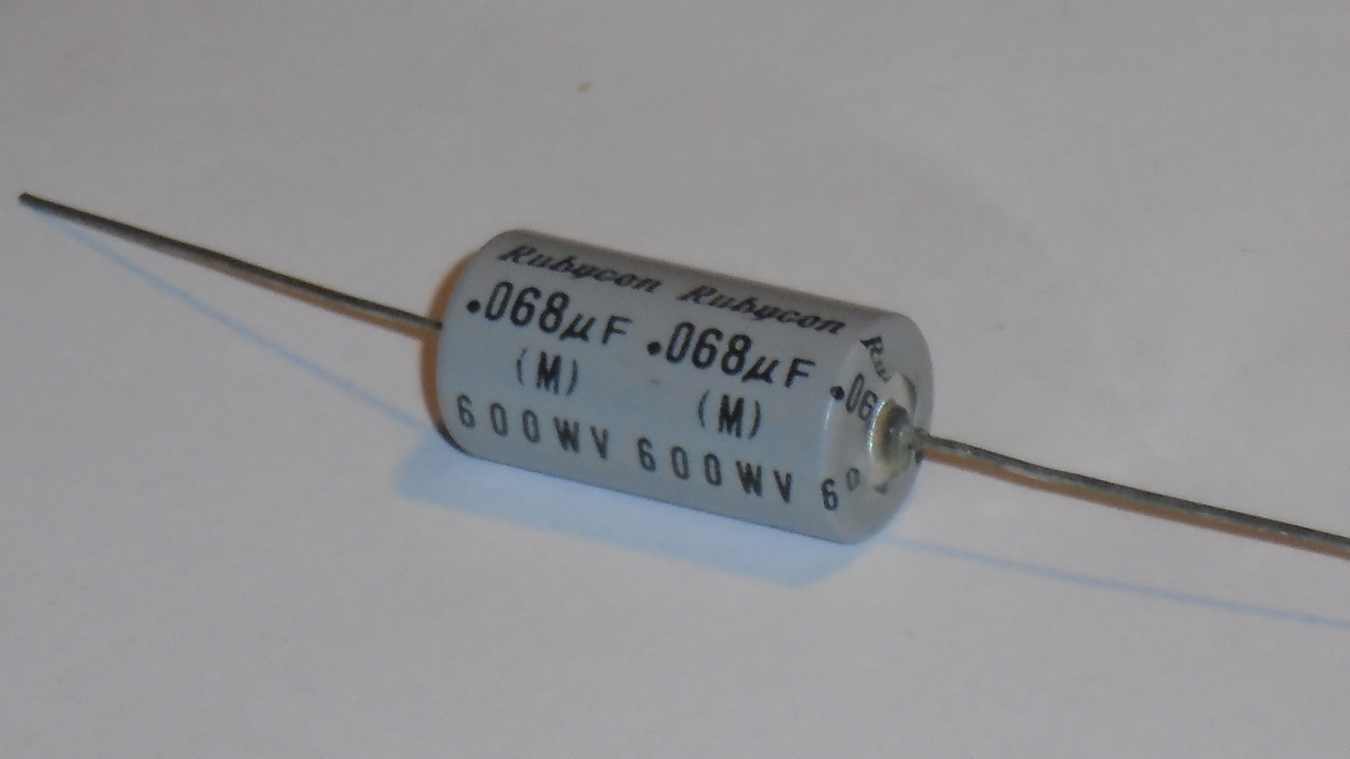

              600v???

                I have a really old 500v rated electrolytic capacitor.

                  Assuming they are still within their rated specs, I'd use them. If they're paper dielectric, they would leak current like a resister. Apply 600VDC across it and measure the current through it.

                    those are probably paper in oil.
                    very old.

                            Sorry for the late reply this is a Rubycon Audio (paper) capacitors they are vintage usually sold as NOS (new old stock) and are really rare to find.
                            and are usually used in single ended audio triode power amps.
