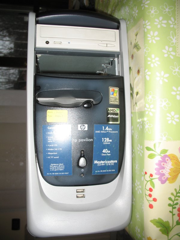

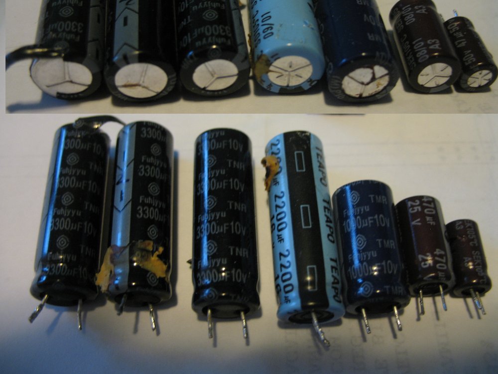

    I have repaired a Pavilion, the owner gave it to me after a shop told him there was nothing to do... the PC is dead.
    Well the PSU has some Fuhjyyu completely ruined (all were bulged) a 3 Teapo, here what I have measured on them:
    1000uF 10V Fuhjyyu --> 1.4uF 139Ohm
    3300uF 10V Fuhjyyu --> 20uF 8.5Ohm
    3300uF 10V Fuhjyyu --> 16.7uF 8.6Ohm
    3300uF 10V Fuhjyyu --> 18.7uF 8.8Ohm
    2200uF 16V Teapo --> 1695uF 45mOhm
    470uF 25V Teapo --> 394uF 153mOhm
    47uF 50V Teapo --> 39uF 880 mOhm
    Unfortunately I forget to take some PSU pics and because I'm lazy I don't want to open it now; anyway it looks better than Allied or Linkword unit.
    After replacing them the PC started but WinXP was messed up so i had to reinstall it.
    Now the PC is working correctly, the Athlon 1.4GHZ run without problems the only limit is that I could install only 256MB Ram (2 X 128MB).
    I had to replace also the CD Writer.

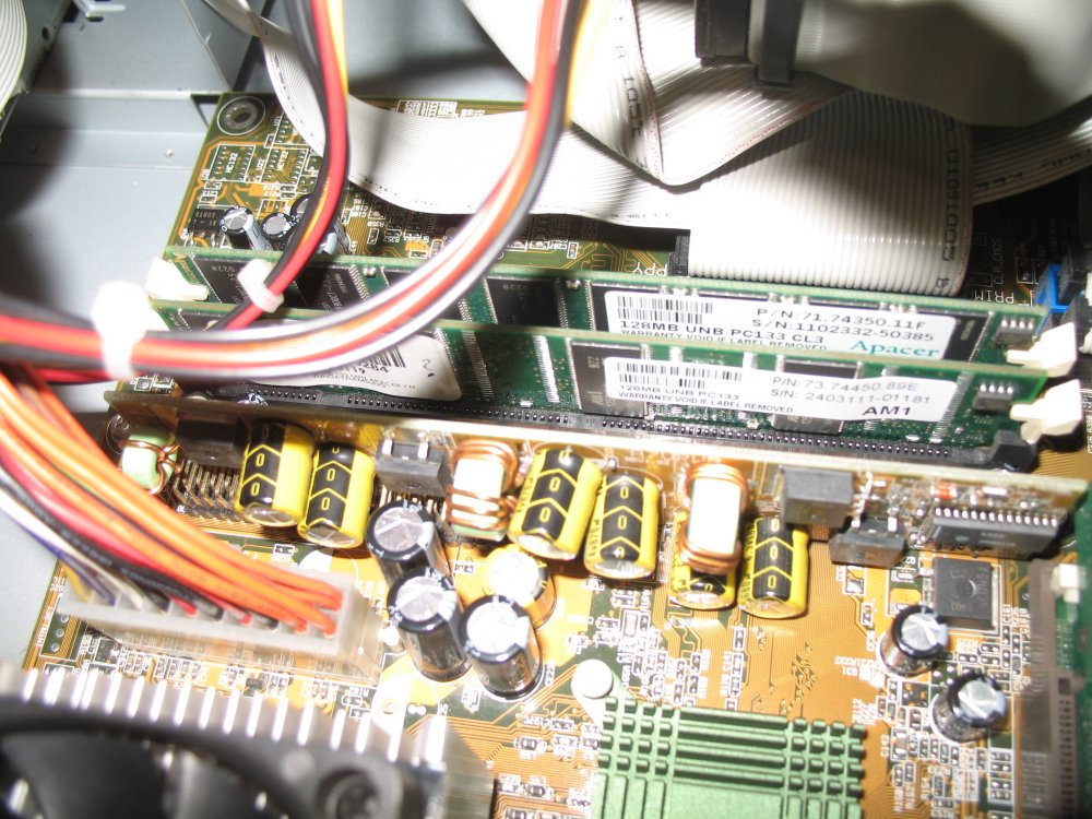

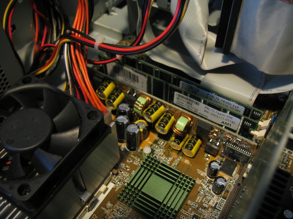

    This is the first time I see a board with such kind of VRM: it is a separate board soldered near CPU. I would like to know what brand and type are the yellow caps on it. I hope someone here have already seen them.
    From top is not possible to see any text or logo and I don't want to disassemble the PC just to check.

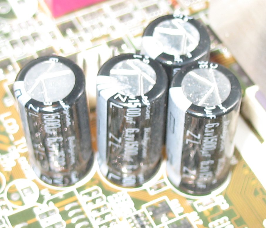

    It is nice to see Rubycon ZL near the CPU.

      I've only seen one motherboard with the VRM on a daughterboard. It was an Asus. It had the same yellow caps on it.

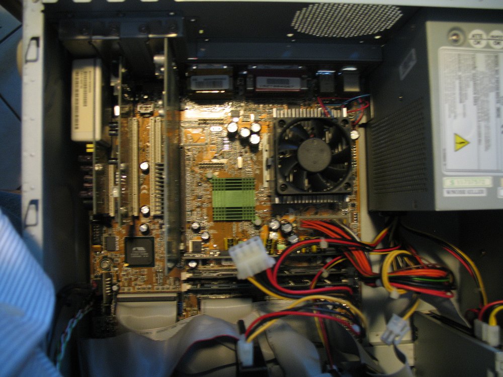

        @ jpdoe: Everest recognizes this board as Asus A7V-ML but I have not seen any label on it.

          i think you leave yellow caps unless problem

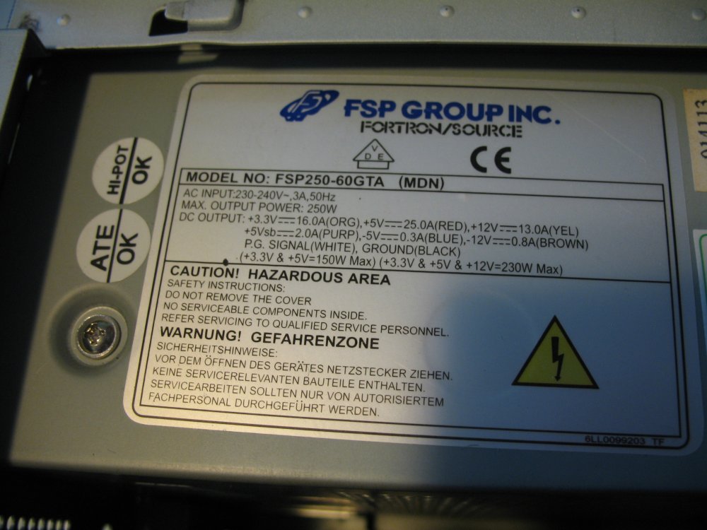

              The psu is a Fortron: I know Fortron uses Teapos and OSTs, but I never heard of employing Fuhjyyus. What a shame

                Sorry to resume such old thread but yesterday this PC has stopped to work: when it boots on the screen you can see it detecting the HD and CD drive but the OS doesn't start.
                If I enter in set-up mode pressing F1, in the BIOS I can't see the HD or CD.
                I tried to boot from CD but there's nothing to do.
                What do you think? It's time to trash it or I can try to repair?
                I have reset the BIOS, I have tried with another good PSU but nothing change, sometimes it says OS missing, sometimes it stays with blinking cursor.
                Any suggestion is appreciated
                Gianni

                  Caps on the MB finally failed is my guess. You recapped the PSU but not the MB.

                      @ brethin: you are right, i didn't touch the caps on MOBO because they were good brand and type so I thought it was not necessary to replace them.
                      @ momaka: I did the test you suggested but I had not error messages.
                      The problem is the during post it shows the check list and you can see it detecting the HD and CD/DVD drive, but when you enter in the BIOS you see on IDE device the label NONE like nothing is connected.
                      I have finish with few more test: I have replaced the BIOS battery and cleared CMOS, I have replaced the PSU and I have attached an HD I use for test and the results are not reliable.
                      Sometimes after BOOT it stays with blanking cursor, sometimes it boots from CD but never tries to boot from HD.
                      I tried to check it with Hirene's BootCD, the few times it boots from CD, but I'm not able to use any tool.
                      The BAD news is that both HD that were inside are DEAD, the Samsung SV2042H 20GB goes on clicking, like the head tries to move, the Maxtor Diamond Plus 8 30GB not even spin up.
                      I think it is not worth to try to replace caps on this MOBO, I have not a great experience like some other members, but the few MOBO I have repaired didn't gave me such kind of problems and even replacing the caps I can't rely on a MOBO that killed two HD.
                      Moreover I don't know if something else is damaged, I have not another MOBO to check the Processor.
                      The BAD BAD thing is that I'm afraid the owner didn't make back-up on CD/ DVD/External HD of personal files... even if I always suggest to do it.
                      Last thing: I tried to find infos about the MOBO but I find nothing, just to understand if it is a problematic one.

                        more likely the hdd's died of old age or from the old psu.

                          So kc8adu in your opinion it is worth to replace all caps and see if the MOBO works correctly?
                          I don't like to trash something that could be repaired but with an Athlon 1.4GHz and 512MB SDRAM 100MHz this PC it is a little bit slow with XP that's why I don't know if it is worth to work on it.

                            Keep the case, memory, drives, and maybe the CPU. I vote to trash the rest; it's a very old PC.

                              Doubt the motherboard caps are bad. The yellow caps are Fujitsu FPCAP (functional polymer) if I'm not mistaken. Unlikely to be bad. Given that the other caps are also of reliable brands and that this is not one of those cap oven PCs (such as some of the Dell SFF PCs), the electrolytic caps should be fine.

                                  To be honest, Fuhjyyus are amongst the only brands I know that have yellow caps...But those look like OSTs. Could be wrong.

                                    Did you verify good operation of the PSU after recapping? Perhaps it was faulty beyond the bad capacitors and killed everything else.

                                      Hi all,thanks for all suggestions.
                                      3 days ago I worked on this PC, I reconnected the recapped PSU, an old HD and CD Drive; I turned it on and it started asking for the OS.
                                      I reinstalled XP, I updated it and added some programs.
                                      I had not a single problem and even with Memtest after 6 hours
                                      I had not errors.
                                      Well I have not explanation... probably I can doubt about my technical skill about repairing PC but I tested the PC in December and it was not possible to turn it on correctly not even using a boot CD.
                                      Now I keep it as spare PC, I have already given another PC to the owner of this one.
                                      Some answers:
                                      @ momaka:
                                      the jumper on HD were corrected, I tested the HD outside the PC, I have bought a kit to power HD and connect them to USB. I replaced the IDE cable 3 days ago because the old one was a little bit ruined, probably it has been mashed against the case.
                                      As you wrote this PC is not so slow for normal use but when you gave it to people that install a lot of useless things like toolbar and so on it becomes very slow; moreover I discovered it is not possible to install Silverlight because the processor does not support SSE instruction so it is not possible to watch some video on a lot of pages.
                                      @ TheLaw : I could not watch the brand of yellow caps but the top shows a k vent and I doubt it is used by OST, so I think willawake and nomaka are right, those are Fujitsu caps.
                                      Agent24 : I tested teh PSU on the same PC, I have no other method and this PC has worked correctly for over one year. I usually run some test on a recapped PC with a recapped PSU and if I have not errors I think everything is ok.
