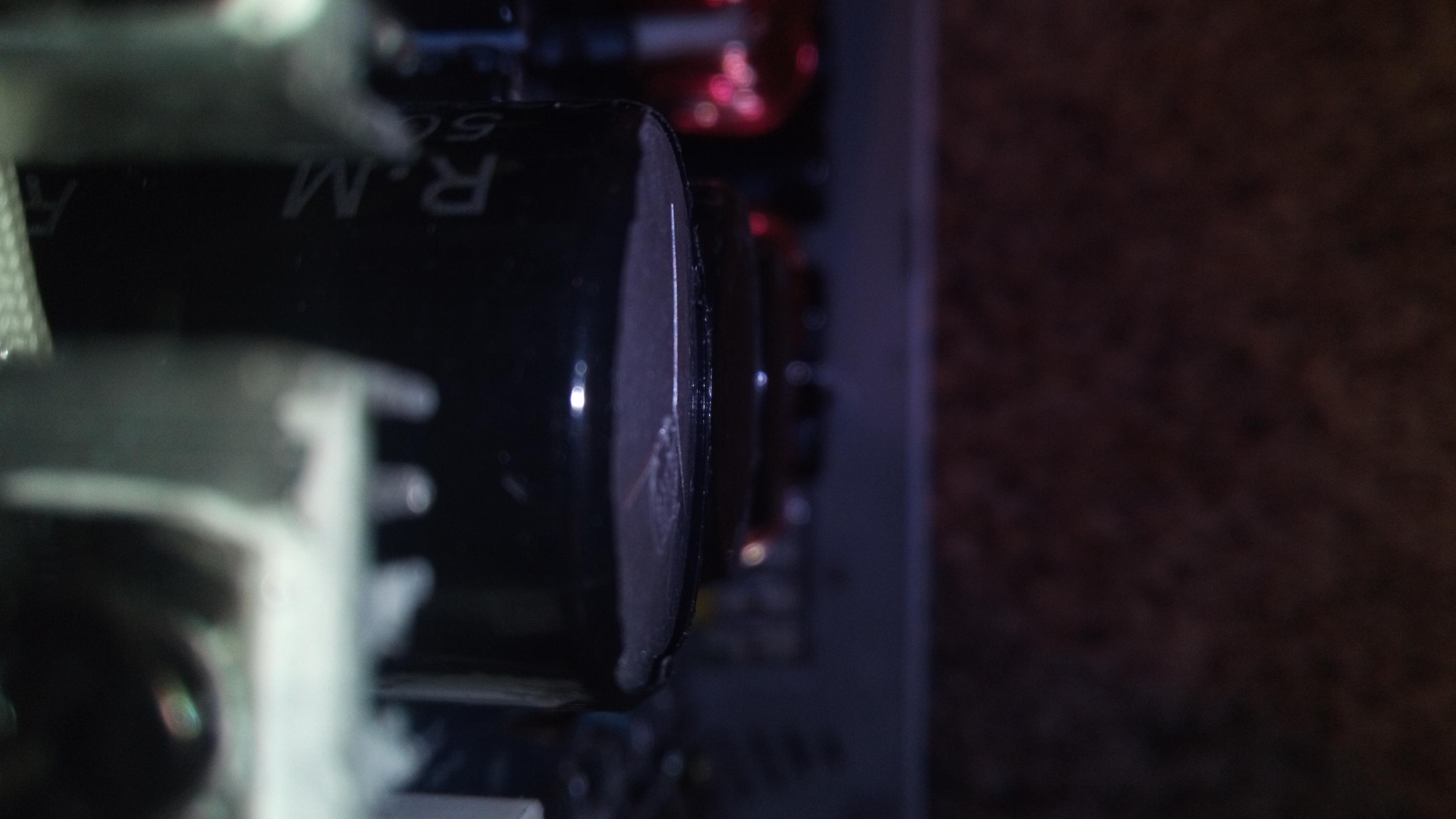

    So I have an older Hifonics X1200.4, a 1200 watt, 4 channel car amplifier. Hifonics uses strictly chinese parts, and are made by Maxxsonics. They had a period where they were amazing, then went to shit, then back to amazing (albeit now super chinese). They aren't known for failing at all, they are made very well now. However, as I said they're made super cheap. So they have caps inside rated 2200uF 50V. The amp was used for about a year in HARSH conditions, I absolutely drove this amp way over the limit. However, in the car audio world, amps can get hot enough to burn the paint off of their chassis, this is normal for competition grade amplifiers.
    Now I took it out of service about a year ago, fun was over. Couldn't bring myself to sell it though. So I came back to it, and it sounded a little funny. I opened the case, and... bloated caps? Not leaking (yet) but noticable bulge 5 out of 6! The brand of the caps is "R • M" (Yes, that s unicode). I've seen these in Logitech devices, never seen them fail like this though.
    Is this natural for capacitors? If not, I'm just gonna assume it was because they're cheap. The amplifier also was run very hot while it was in service, if it was running for long periods, under high stress it could see temperatures above 160 degrees.
    Popcorn.

      It's possible for any electrolytic whose electrolyte has decomposed (for whatever reason) to produce excessive hydrogen gas just by sitting in a sealed bag, unsoldered or desoldered, at room temperature. Capacitors bloat in storage for various reasons. Contaminated (unclean) raw materials is one reason. Excessive ripple current causing the cathode oxide layer to form is another. Heat will certainly accelerate the degradation of the internal chemistry and that was a factor in your case. Off the top of my head, GSC/Sacon/Evercon, Fuhjyyu, CapXon, Teapo, KZG/KZJ, and Rulycon/Jee are examples of some brands and series whose behavior is more or less defined by venting on the shelf.

            Some members here have posted internal shots of PSUs where CapXon, Fuhjyyu, Koshin, and Teapo all have the same orange or yellow sleeves. I don't think it means they are the same brand. It was to my understanding that Fuhjyyu is AsiaX's parent company. What's even more interesting is that since 1995, according to Fuhjyyu's history, Teapo and Fuhjyyu actually worked quite closely to manufacture miniature crapacitors together. It would certainly explain the high failure rate of both brands.
            If you can push the tops back down on those bloated caps, they haven't formed permanent pressure inside and the electrolyte simply expanded from excessive heat. If you can't, the electrolyte definitely broke down and outgassed.

              I've seen a lot of capxon and UCC KZG &KZJ series die on the shelf. FWIW, I loved HiFonics car stereo amps back in the old school days (early 1990's). They were bulletproof back then!

                  Attached.

                      Was limited on android, edited and fixed. Also, that is after pushing it down about 1mm as that was recommended to try.

                        those are shot.
                        find same or higher voltage/uf in same size in a quality brand.go taller if you have room.and pick the lowest esr.esp for the input caps.
                        digikey is the best place to look.

                          I wonder what's so great about device filled with crap caps? Obviously it is not overbuilt at all. Temps above 160 are hard to believe though, even most semiconductors won't survive that for long, not to mention all the caps.
                          If it's so very hot just add a fan, no?

                            what more surprising is that it survived as long as it did using bottom bidder parts.
                            only worse use would be to bolt it to the sub box.
                            and yes i see them come in with parts broken off the board from that.
