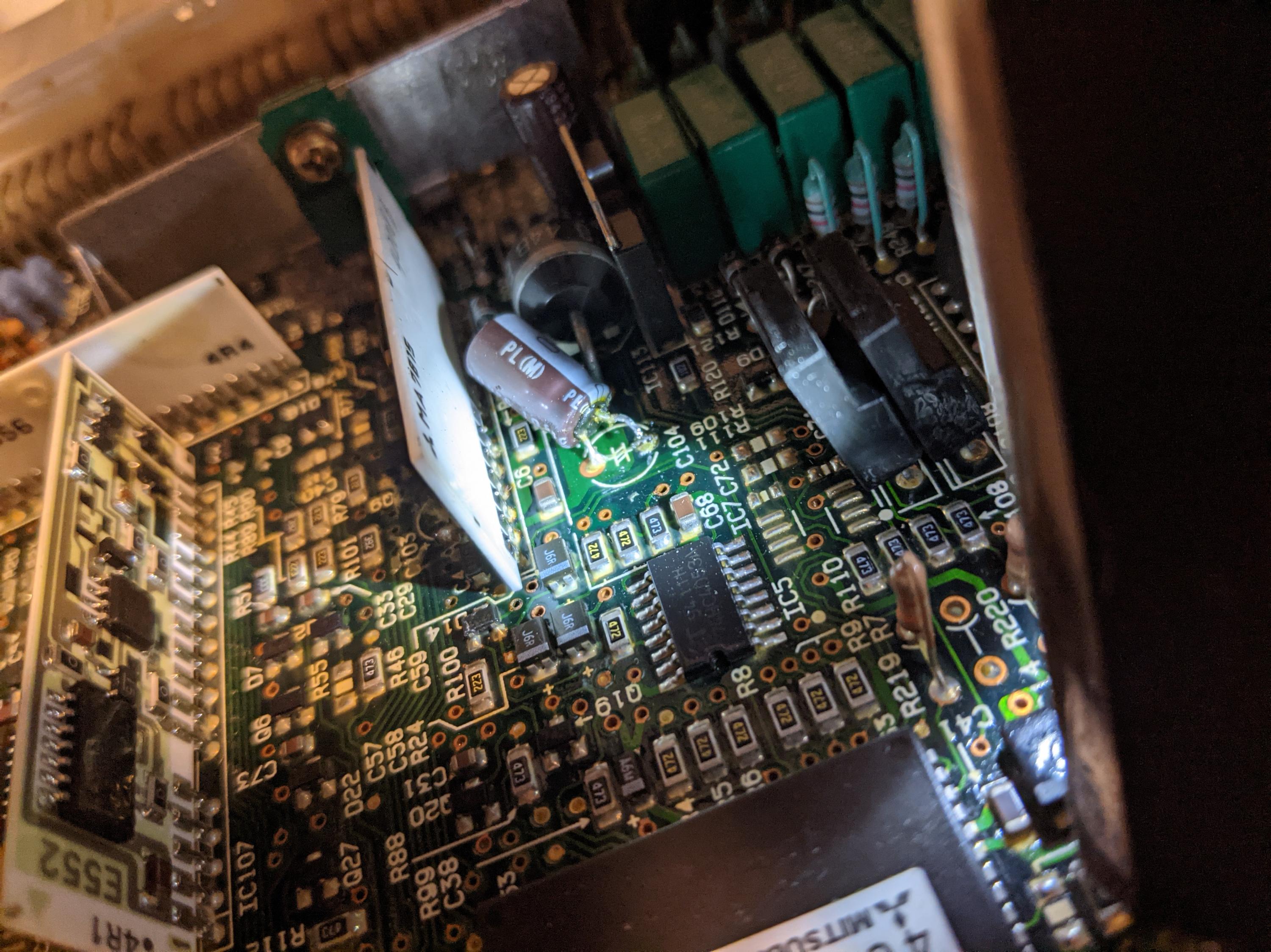

              I recently confirmed that the PL series leaks electrolyte from the seal. I could not find conclusive evidence online, but discovered this when repairing an engine control unit. The date on the capacitor is the 15th week of 1994. It is not leaking too bad, at least so far. If you look closely at the photo you can see the electrolyte on the bottom seal.

                Re: Input on Nichicon PL(M)
                Welcome to Badcaps and thanks for the information!
