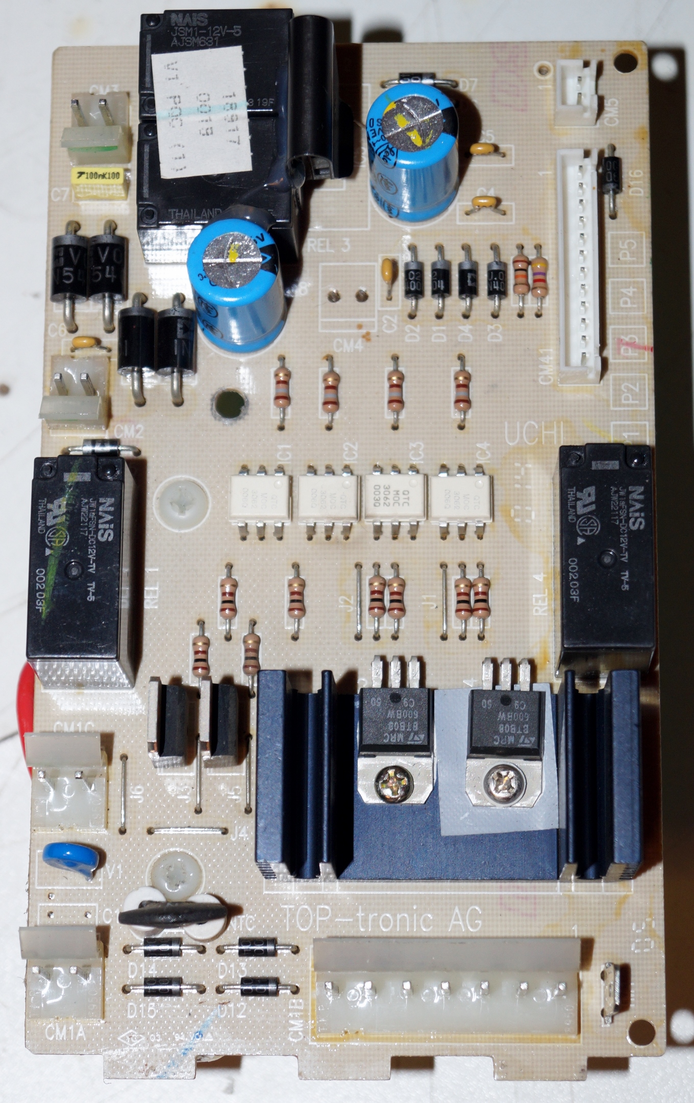

    Working on a Jura X90 Auto Coffee machine which was displaying a E8 error which is the brew group related. Ive cleaned and greased the brewgroup but still displaying same error. Is just making a loud clicking noise.
    From a quick google issue is said to be the brewgroup motor / transformer or motherboard.
    After an inspection ive discovered 2 x cracked solder joints comepletely shot and after removing the board theres a big cap behind it and its casing has heated up and bubbled.
    Is this toast and what exactly is it? A AC filtering capacitor?
    The cracked joints sit directly in front of the caps.

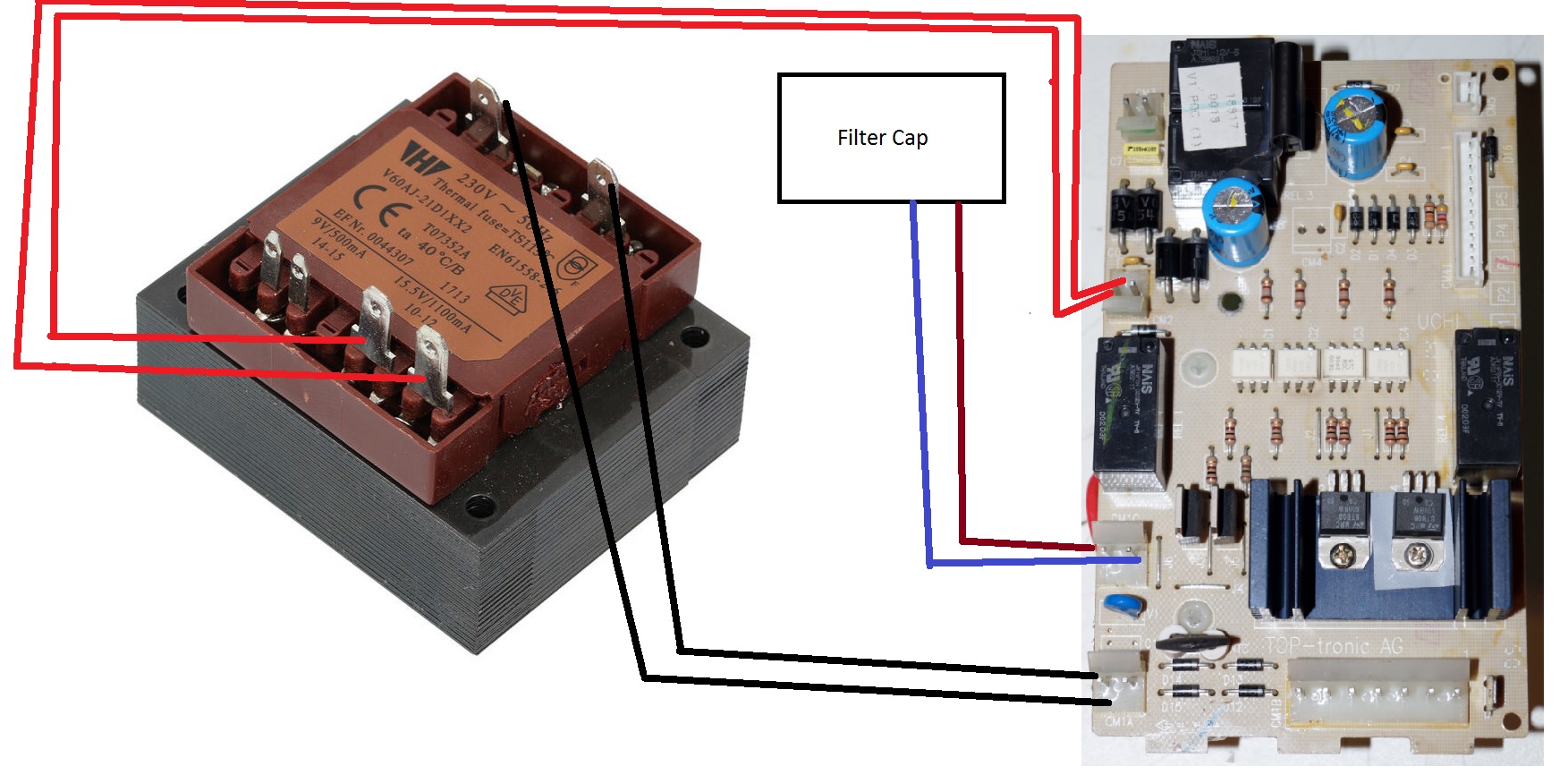

                Since ive got the board out and waiting for part is there anything else i can check on board to check for any other issues.
                Connectors on left are as follow
                1st Bottom Left - Out to transformer
                2nd Bottom Left - In from burnt AC fiter cap
                3rd Top Left - In from transformer 15v DC (Broken solder joints)
                4th Top Left - Out to Motor
                Problem was not providing power or enough power to motor, perhaps was just the solder joints from the DC in. On rear of board looks like another small transformer which is leeching from the rear traces inbetween the AC in and out to main transformer feed up to the top right diodes where CM4 is.
                The thermoblock is getting power and heats up very quick as expected.
                Ive checked diodes in circuit and seem ok.

                            Still have issues with this even after sorting solder joints and replacing that cap.
                            Still makes a loud clicking noise. From a diagnostic site suggest issue could be with transformer.
                            Thing is ive disconnected the transformer AC and DC from the board and still get the same clicking, not as loud though. (AC goes into board first then into transformer)
                            Could it possibly be a relay issue? the two longer ones midboard perhaps or still transformer as relays not getting power / enough power hence clicking?
                            Switches are jw1afsn-dc12v-tv
                            Ive measures DC terminals on transformer with all AC stuff still hooked up and was getting no reading.

                              That transformer looks like a 50/60 Hz transformer, rather than something that would operate at >20KHz. Transformers don't have DC leads. Transformers operate on AC.So if you measured at the transformer leads your meter should have been set for AC. The easiest to describe place to find DC would be across that blue electrolytic capacitor next to the two large rectifiers.
                              PeteS in CA
                              • mikay786
                                • Aug 2014
                                • 765
                                Re: Jura X90 Capacitor
                                Ah ok transformer lowers the ac voltage then a rectifier changes from ac to dc
                                I seen the output of 15v / 9v and assumed it was dc

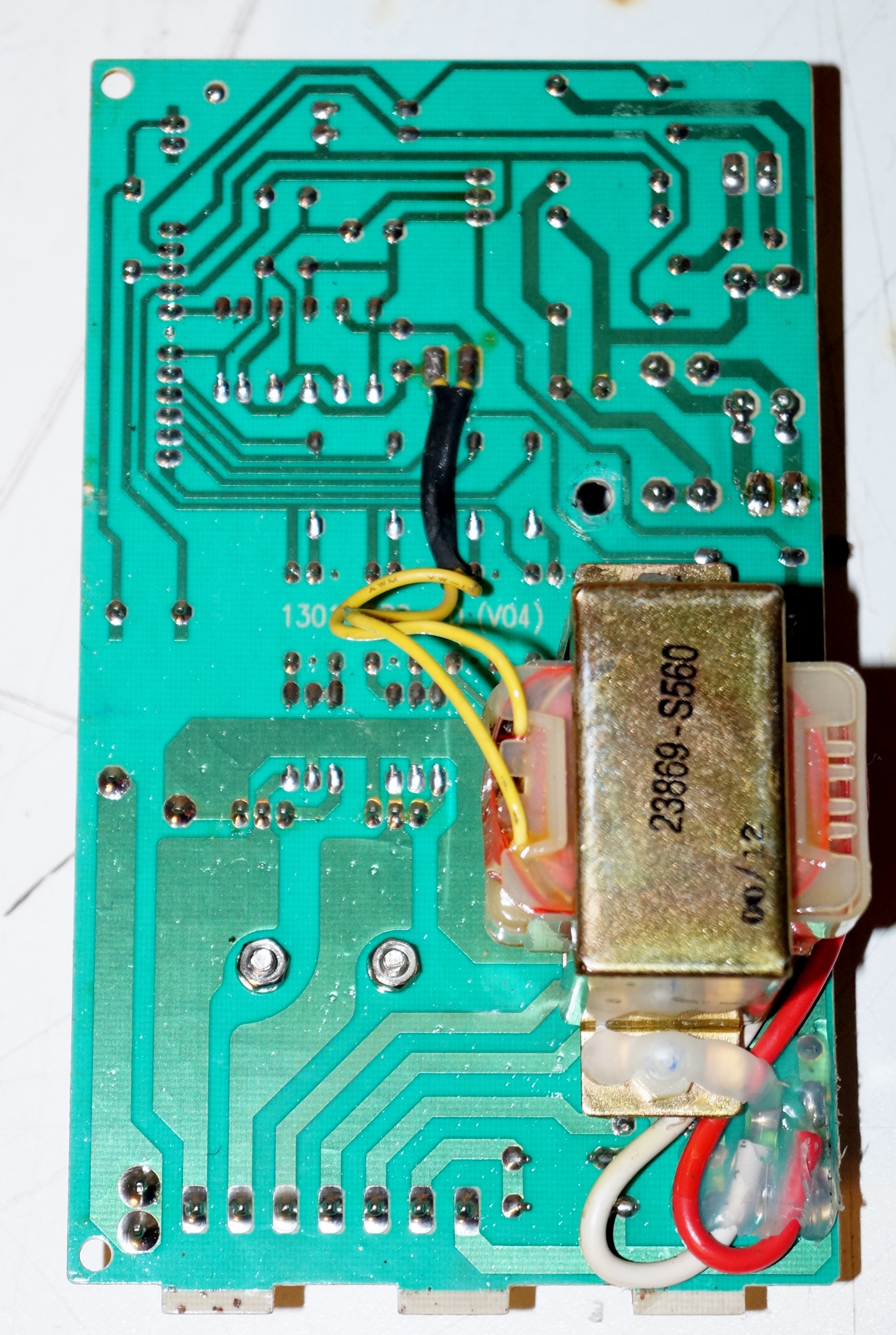

                                  • mikay786
                                    • Aug 2014
                                    • 765
                                    Tested again in AC mode and still nothing. Measured on the two red cables coming out of the transformer the 15.5v. The other two sets of cables were plugged into the board and just the two red cables (output) was disconnected to measure at.
                                    that thing on the rear i assume is feeding the front panel controlls? The connectors top right are for the front panel, power button, display etc

                                      • mikay786
                                        • Aug 2014
                                        • 765
                                        Sorry here we go
