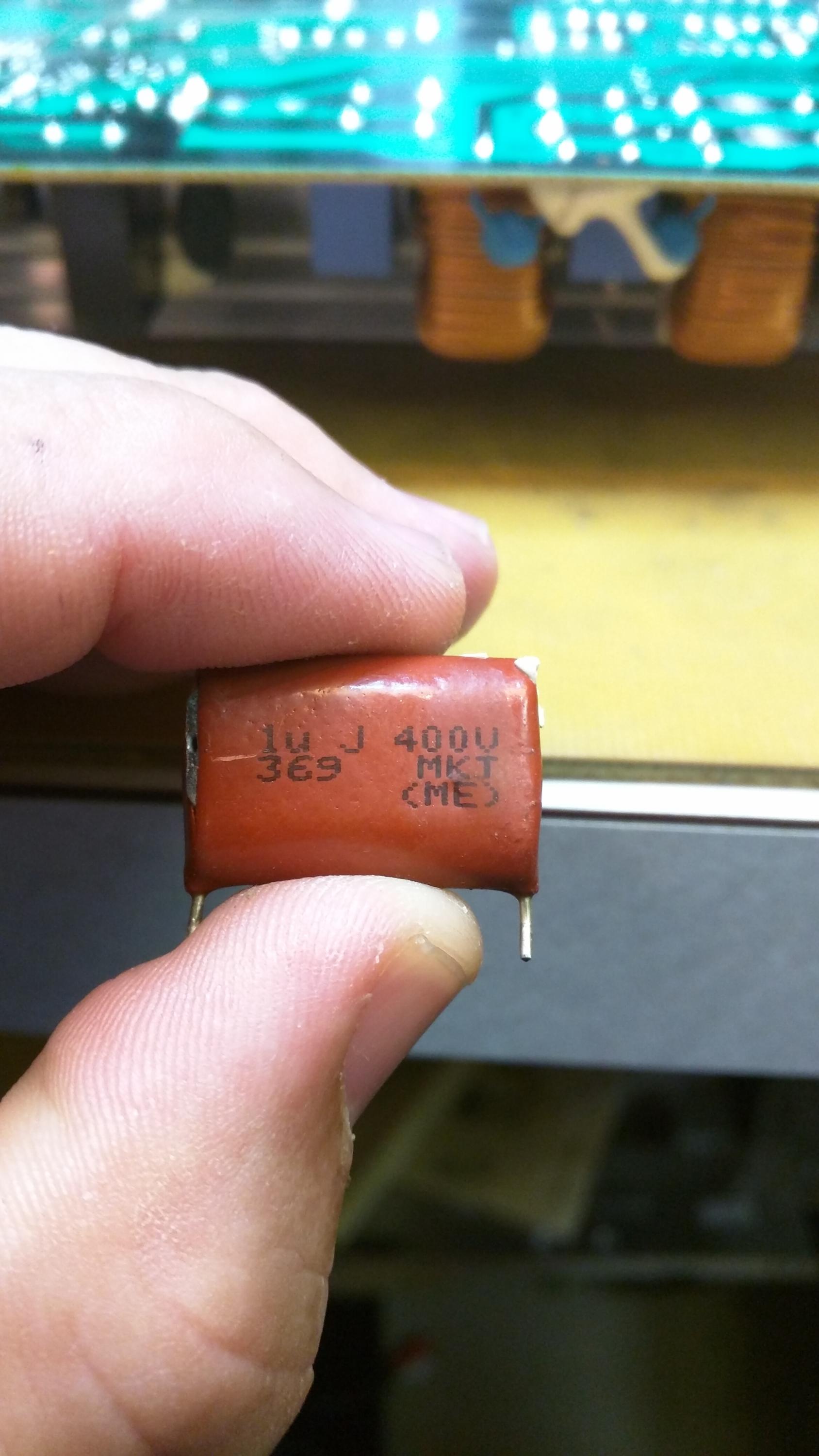

I've been looking to find this cap but with no luck. Maybe the group could help me find a compatible replacement somewhere on the net. Thanks.
Help finding compatible replacement
Re: Help finding compatible replacement
A little more specifically, it's a 1uF, +/-5%, 400V metallized polyester capacitor. The "J" means 5% tolerance; the "T" in MKT refers to polyethylene terephthalate, aka polyester. The "369" is probably some sort of date/lot code. Not sure about the "ME"; back in the 1980s there was a company called Mepco Electra, but I think they got bought up by some other company in the late 80s or the 90s.
As for replacing it, a 1uF, 400V metallized polyester capacitor that fits should suffice.PeteS in CA
