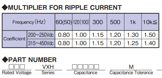

      I think his RC= ripple current.
      If your spec sheet does not list ESR it is probably higher.
      Be careful that you consult the data sheet for the ripple current multiplier for the correct frequency it will be subjected to.
      All manufacturers and series do not use the same frequency of 120Hz for factor @ 1 for their non low ESR types such as your Ruby VXH.
      Sometimes 60HZ and sometimes 10KhZ
      Low ESR types typically/usually reference 100KHz at ripple factor correction @ 1

                    So the temperature coefficient of rated frequency is used by dividing it in to the specified rated ripple currect to give you the new maximum allowable rated ripple current. So at 200-250volts at 1khz frequency you have a coefficient of 1.32. If we go page 316 to ;
                    on the 200V chart for 330 uF we have a rated current of 1970 mA RMS we now take 1970/1.32=1492.42..
                    so at 1KHz that cap has capability of a maximum rms ripple current of 1492.42 mA instead of 1970 mA rms.
